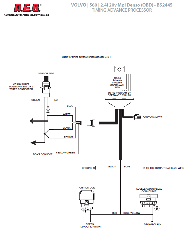

The nearest I can find to my 1999 Denso set-up is AEB's drawing for an S60. It's my understanding, S60 or Denso V70, B5244S they're set-up much the same. I'm a bit worried, money aside it's the time spent on this. If I'm wrong I'll have to take it all off again. Thus, back to Necam.
Why £380 you ask?
AEB 510N TAP (including delivery from Italy ) = £110
AEB 001N Data lead (including delivery) = £70
AEB011N Firmware from Tinley ( I took their the last one?)=£130
AEB410F Lead (including delivery from Netheralnds) = £70
Wheras the EG is about £60-70. And i still don't know if this AEB stuff is correct, and it's still not all here yet. ... ouch.
On order I still don't have the complete set-up. Going in blind, I had no alternative. Having taken all the multipoint stuff off for shortage of info, this to get the Necam on, I'm now back in again to reverse my work. It's not even the money, it's the hassle. At present, I'm aiming for this....
Why £380 you ask?
- AEB510N TAP Wiring.png (73.96 KiB) Viewed 5928 times

AEB don't fill me with confidence, the one thing I do know for sure, the AEB510N with the pricey firmware kit installing the correct variant, it'll work without cams with an inductive crank.
As the drawing we program Software AEB510N-08
Limited options and info, I'm still not sure how I've managed to make a meal of something as straight forward, but I have.

Unable to find definitive info on a TAP and with supply choices limited, I had to bite the bullet on this one. I sit here with an AEB510N + all the pricey ancillaries. AEB offering firmware for this engine is, "wot swung it" yet I'm having my doubts already. I've long-since disappeared up my own rectal-passage, left guilty of overthinking this.
Thing is, despite AEB offering specific model-specific wiring diagrams, they omit dip-switch settings, which is both typical to AEB documentation. or very likely a clue? Can't help notice that if we take AEB's word - this engine is a 4 cyl too?

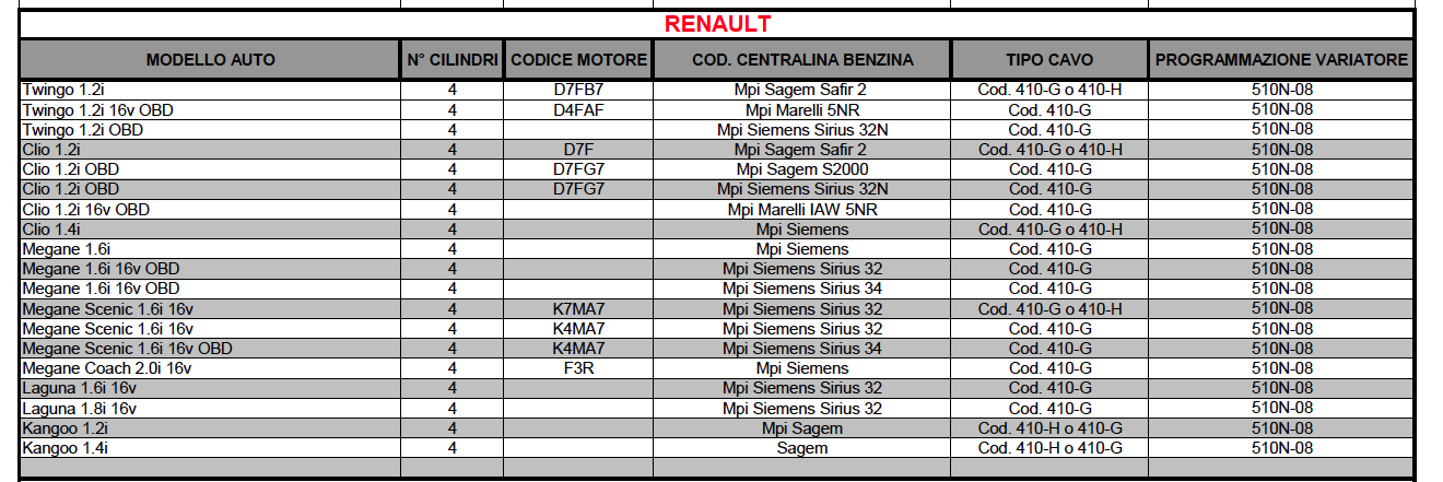

Volvo firmware (Version 08) is grouped with Renault, thus Renault & Volvo get sole use of AEB's firmware variant [AEB510N-08]. There's also a dedicated Volvo/Renault dipswitch on the TAP.
Is this a clue? See dipswitch 3. I've looked thru' hte Renault info and see nothing. I ask, what's common/unique to Renault/Volvo engines that has AEB trouble with specific firmware and a whole distinct Volvo/ Renault dipswitch?
I'm under the impression Volvo engines don't requires a TAP running LPG, thus specific to Renault and Volvo, does this narrow things down?

To the question, a link between Volvo and Renault which requires such dedication from AEB? Subsequent to my post I got onto Dai, (classicswede) and he had no clue either.This under the circumstances is fair enough - my current theory is that; if there's little to no gain with a TAP on LPG, this TAP is really a CNG only item. These engines must require much the same advance curves on CNG. With the knock-sensor etc doing the rest?
