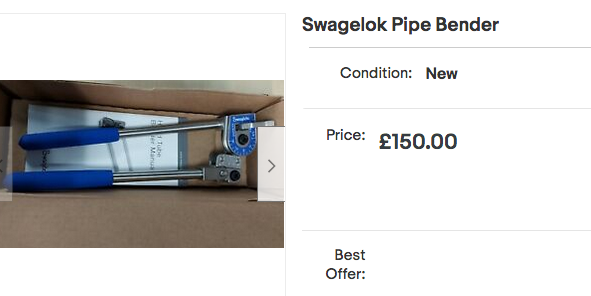

You can get away with murder fitting LPG. Copper tube goes where you put it. LPG goes in an aerosol can - not so, natural gas. We're at 200Bar /3000 psi and tanks look more like welding-cylinders. One of those cheapo Stako 'aerosol-can grade' toroidal jobbies came out yesterday. I've been lucky, picked up a vastly pricey Luxfer Type 1 cylinder for pennies, and it went in yesterday. It doesn't expire until 2030. Time to break-out the stainless 6mm pipe and my trusty Swagelok pipe-tool. I'm putting everything back to stock in the rear now. Stainless is a pig to work, it's pricey and after one bend, work-hardens. The downside to 'The Gas of the Gods' is the install. It's awkward, the fittings and tools are hard to find, extreme-pricey and time-consuming. You'll need the tool shown, and if you can even find one, you'll be lucky to pay the price shown in the piccy. Yet my glass-fibre lightweight Luxfer tank is £2500-3000 new - I paid, £50 odd, see what I mean about lucky?! Proper pix soon.
- Swagelok bender.png (104.96 KiB) Viewed 6360 times

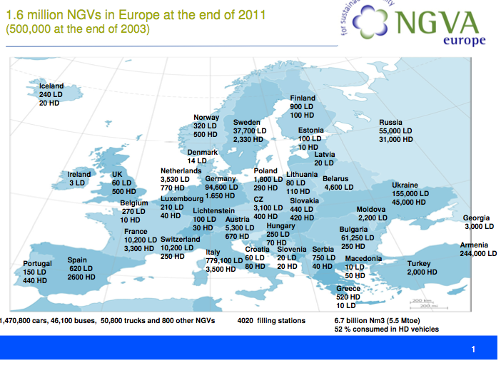

Its barely available here - there are a handful of stations at best in the UK. Unless you happen to live near one of them, your really looking at Home-fill like CNG does, where you draw gas off the mains supply and compress it. He has posted about that previously.
Its used in some areas of the world - India and Malaysia I think use it quite widely?

No room to teapot about a workshop with a Stako and a 4 metre length of copper pipe. Sorry to be the one to break it to you, but LPG?... it is written, 'tis for "Whoopsies'.

I first saw GOTG used on a Zamboni, that's those things used to condition ice in skating-rinks. Larger fork-lift truck fleets use it too.Its used in some areas of the world - India and Malaysia I think use it quite widely?
The UK lags about last in its use. For reasons we can guess, UK central government has always avoided the stuff. Argentina is No.1, about 60% of their vehicles run it.
John Lewis/ DHL/ Tenens and few other big corporates mess with it here. GASREC/CHIVE/DIRFT etc. I got a heap of cylinders from Tesco's fleet. Councils like it too, with their dust-cart fleet. One left-leaner had their mayor and town-commitee members justified with nine Volvo S80s. I caught a few of the parts when they got rid.
I've found most of my info from Indian forums. The Indians run little Maruti/Suzukis with it.
And Obama banged-on about it for a while. Shale-gas et al. The Yanks abundance of SG, means shale-gas has been a factor in keeping oil-prices low.
It's old and I think I've already put the map below up - if not, here it is again.
I march on...
- CNG In Europe Map.png (256.84 KiB) Viewed 6342 times

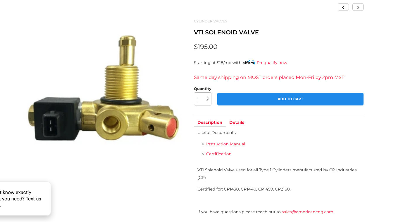

A question please:
Earlier I said I had a Type 1 Tank, my error I meant Type 3. It's an ex-Howard Tenen's tank. I got teh pick before LPGShop took stock of the rest. At one point there was about 30 of them. I think they're all gone now. See piccy.
Only the solenoid on these is 24V, understandable, came off their HGV fleet. I've been able to remove the 24V coil easily enough. Problem is, its bore is 10mm. Most 12V LPG solenoids I've seen are not 10mm.
I'm sure a ring around to Tinley or somebody will reveal one, but does anyone know, off-hand, which LPG solenoid coils are 10mm bore?
Has a VTI valve. I'm sure a call to VTI in Germany will find a 12V solenoid coil, - off the shelf. However, we won't need it to be a VTI price! i don't have to ask to know what VTi will charge + courier etc from Germany.
Methinks, a 10mm coil is a 10mm coil. Last outing I found £8.00 Chinese copy, OMVL vapouriser coils fitted my 3 x EMER tank valves dandy, and weren't £90 a throw. I'm a little fish in a big pond. I'm very aware, It's a bit like the word MARINE, anything GOTG goes out at 'Godlike' ie: 4-5 x LPG prices.
Anyone?
Anyone?

Thanks, that was quick! Sweet jeez, spent a good hour looking for that on eBay and others, 9.5mm might not make it but a Dremel could just scrape it? 14W is a bit high, but did I want jam on it? It's £4, I can't rightly bitch....
Thanks again.
