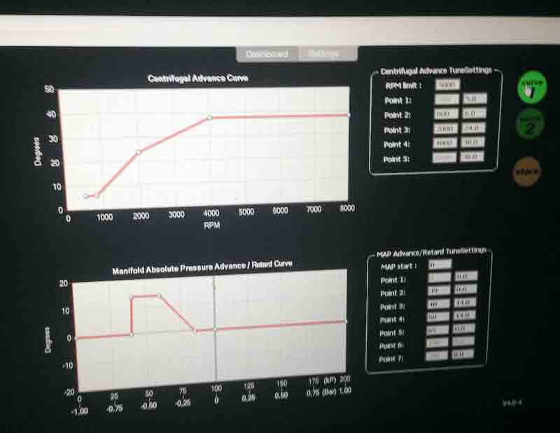

And thinking about this, the Land-rover runs a two curve electronical doo-wacky dizzy, which kinda beats a Lucas 45D, and the curves as far as I've ever got with them without a rolling-road, are very different...
Petrol
Methane
And whilst I've got the vacuum responses set identical, they almost certainly shouldn't be, but it works. It's odd running a 1960s Land-rover via a laptop, but it happens. And it’s never too late to have a happy childhood.
