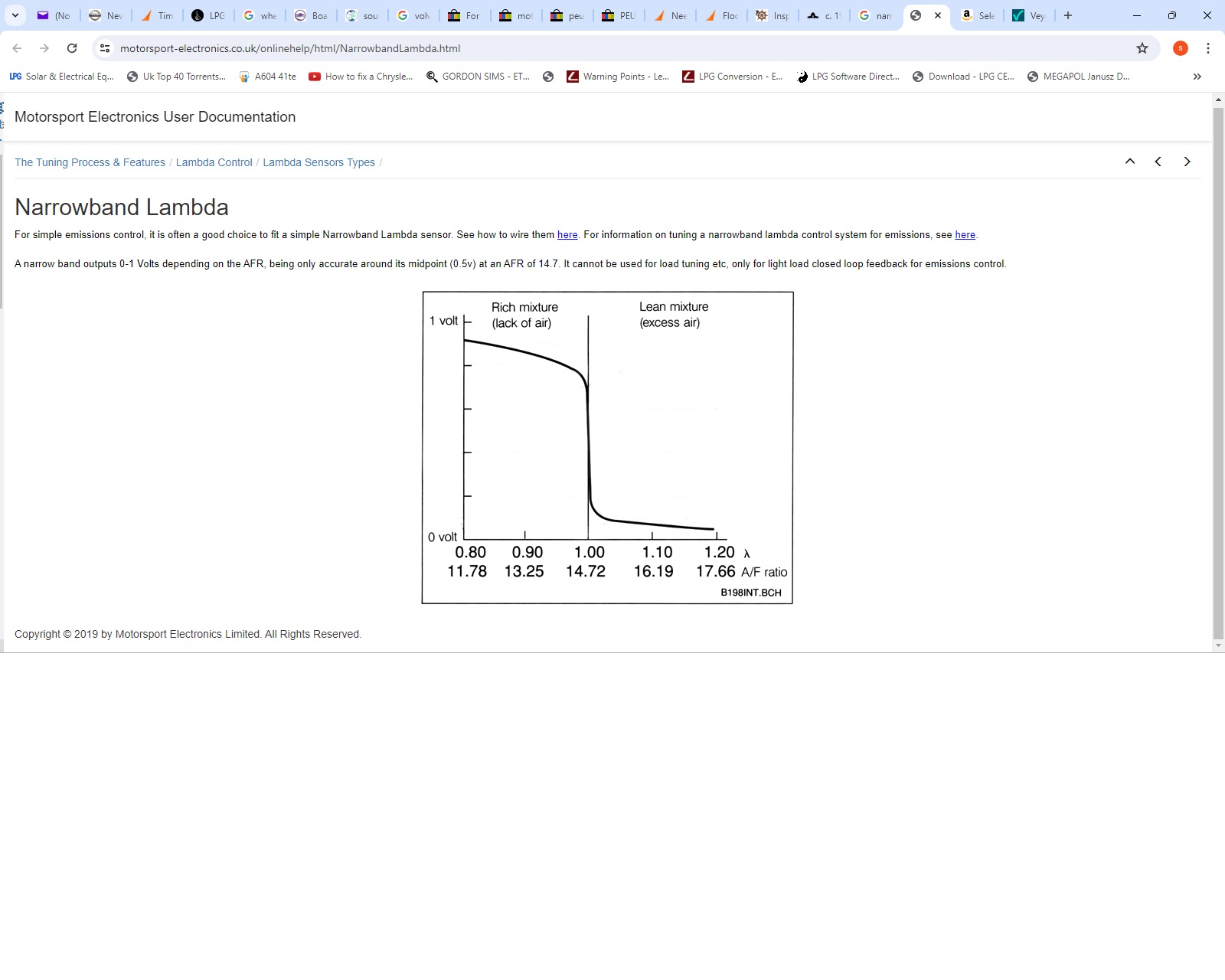

Do you mean lambda sensor reading of 0.9volts or 0.9 equivalence ratio Rob? I would expect you mean equivalence ratio because 13.3/14.7 = 0.9, while a leaner (still rich) mixture would still see a 0>1v lambda sensor more or less max out at around a 0.9v reading.
WIth 0>1v lambda sensors maxing out at around 0.9v there's no way a 175 could aim for 13.3afr with closed loop control, they normally aim for 0.5v, can aim for (say) 0.7v, but can't really aim for 0,9v because if the lambda sensor maxes out at 0.9v there's no way for the 175 to see richer mixture than the leanest mixture that gives 0.9v lambda reading... At least not with the normal setup with 175 wired directly to the signal output of a narrowband sensor, but would be possible if connected to a WB controller that outputted emulated 0>1v lambda sensor output below 4000rpm and emulated 0.5/0.7v output at 13.3AFR above 4000rpm with wide throttle TPS reading.

Eq ratio simon , and yes a NB sensor would be a bit lost out of is range , and locked on .9 .
a wb like the lm1 innovate can be programmed to use any range of voltage for it's 9 to 20:1 range , so can be set to put out a 0-1v signal , or even i think a 1v to 0v signal , i am sure it could be tailored to fool the 175 some way .
i did many years ago map a NB sensor voltage to afr , and it as actually less switch like than i expected , it may be with a bit of mapping it's voltages against a wide band , possible that say .78352 volts would equate to the .9 lambda needed? ;)

robertXX wrote: Sun Apr 28, 2024 8:22 am i did many years ago map a NB sensor voltage to afr , and it as actually less switch like than i expected , it may be with a bit of mapping it's voltages against a wide band , possible that say .78352 volts would equate to the .9 lambda needed? ;)
I know what you mean regards the possibility of mapping nb voltage to mixture but I think more likely in practice it would be too hit and miss due to the tolerances involved, mostly accuracy of the voltage reading. I just had a look at some online charts of nb voltage versus mixture, the pic below seems typical and shows that 0.9v = 11.78:1, 0.8v around 14:1, 0.85v around 13.4:1... so the voltage reading would need to be very accurate and the results repeatable over a wide range of temperatures, weather conditions (also affecting engine bay temps etc), slight swings in voltage bias. I don't know of any vehicle manufactures that try to make use of an nb lambda to hold a specific mixture other that stoch. But I would suppose it is viable for the 175's and similar to aim for a voltage of (say) 0.7v or 0.8v, just not 0.9v.
