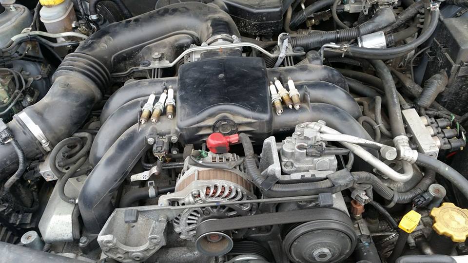

Talking of difficult to access plugs - try a Subaru H6. You do n/s rear from underneath! The working space is whatever the thickness of your hand is, minus about 5mm.

Yes I've done the plugs on Subaru H6's... And I rebuilt a H6 engine after dropping a bolt into it's inlet manifoldSubaruFan wrote: Wed May 29, 2019 4:47 pm Talking of difficult to access plugs - try a Subaru H6. You do n/s rear from underneath! The working space is whatever the thickness of your hand is, minus about 5mm.
