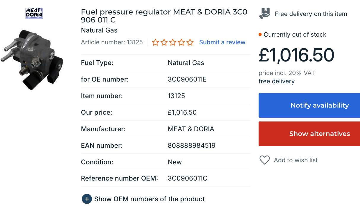

VW Caddy Reducer.png (197.76 KiB) Viewed 2748 times
And even here cheap is relative. VW must make the world's priciest reducer. With a stepper motor and no rebuild kits Add another £200 for import charges You can buy a used one - but don't.

Wonder what the stepper motor on the reducer does...(?). Perhaps if the OEM CNG setup on the VW failed, instead of replacing components you could fit your own closed loop CNG setup using more available and cheaper components. As you know, the VW mods that allow the engine to run a bit more efficiently on CNG will be due to changes to hard engine components affecting things like CR and valve timing, not mixture; The design should give the same benefits with an aftermarket CNG setup, both will the OEM and aftermarket aim to provide correct mixture. The potential main difference might be that an OEM setup might switch between different ignition advance curves if timing control is more advanced tham bobweights and vacuum like in a conventional oldskool distributor.

I believe the stepper adjusts gas pressure. The Russian & Ukrainian forums put standard reducers and -if my understanding of ropey translations is correct - the effect is to starve fuel under load. Pressure sensor in gas-rail. The ECU flips to liquid at or near WOT. There's one loon that's put a Nevo on a BSX to run tri-fuel. Petrol / CNG + LPG. Three sets of tanks. Seems it can be done. Maybe he takes his LPG map via the CNG curve? I think LPG is cheaper or just easier to get in some parts of Russia??
