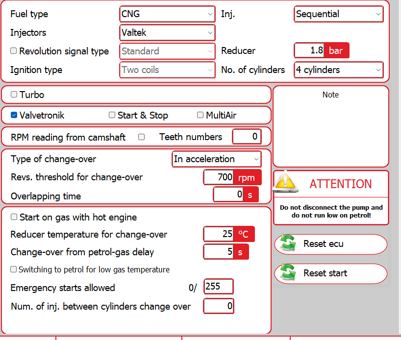

Change Over (the one i found)
Screenshot 2025-09-20 182447.png (73.05 KiB) Viewed 3295 times
The above given is the one that was configured, all i changed here was to check the start on gas in hot engine and change over time to 6 seconds (i also checked the pressures, the Press.Gas matched the pressure on the "Reducer" section , so did not change anything there)
Lambda settings was default (Since O2 sensor was not connected)
All i changed in the "Sensors" section was to click the gas electrovalves to open in advance (since i switch to gas early)

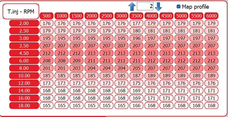

This was the map i found , i reduced the values across the entire map by 10 points

The numbers in the map table can be though of as a percentage multiplier, so if petrol injector pulse duration (pinj) input were 3ms and the applied number from the table were 200 then (if pressure compensation and temp compensations were zero) gas injector pulse output would be 6ms. Petrol injector flow rates are normally matched to an engine so that at high rpm and engine load the injector doesn't spend much time closed, or to put it another way the petrol injector runs at maybe 90% duty cycle at high engine load, or to put it yet another way the petrol injector pulse duration is almost as long as available window for pulse duration. If your gas injectors need to open for twice as long as petrol injectors then you'll realise that the gas injectors couldn't possibly have enough window to inject enough fuel at combinations of high loads and high rpm. The numbers in your map and the fact ginj is reading around 6.3ms when the engine is idling and pinj is around 3.2ms point to the flow rate of your injectors not being high enough for the engine, the injectors should really at least have bigger nozzles fitted in them, perhaps a higher flowing model of injectors should really be fitted. You should be able to get it to run with correct mixture at low rpm or lower throttle settings but the injectors (at least with current nozzle size) won't flow enough fuel for combinations of high rpm with high throttle.

I'm not very familiar with your engine. Why is the Valvetronic setting ticked in LPG software?
That one, i don't understand as well, it was enabled when i pulled the data from the ECU , the engine is a simple Naturally aspirated 12 valve SOHC Inline 4 engine with conventional multi port injection and electronically controlled ignition https://mymotorlist.com/engines/hyundai/g4hg/

If it's a simple DOHC engine the Valvetronic box shouldn't be ticked.
But if/when you untick the Valvetronic setting you'll need to recalibrate the system, the numbers in the map table will need to be changed.
SOHC actually, it does not have VVT or anything, i did try to untick it, but it made it run very lumpy, i dont have a laptop. i actually connected it to my desktop via the cable and pulled the data , so i cannot drive around and tune it at the moment, gotta wait until one of my friends come back home, so i can borrow a laptop for the purpose

Would expect it to run poorly when you first unticked the Valvetronic box because the numbers in the table will then also need changing.

But in the meantime you could maybe try to get it idling properly with the Valvetronic box unticked? With idle something like correct the other numbers could then be guesstimated based on the idle numbers. You could save the current config and always reload it if you couldn't get it idling OK.

Hey!
A few updates:
I haven't been able to get it running properly without the valvetronik option, it keeps running lumpy, so i decided to leave that alone
i have managed to use an OBD Scanner to monitor fuel trims and adjust to the map on idle
Earlier, when i put on load on idle (AC ON, Headlights, Indicators etc), the fuel trims used to go +10 to +15, then after i switched it off, the fuel trims would go -10 to -20 and would stay like that, that issue has been fixed, now, on idle without load, it shows +/- 5 , and with load , its close to +/- 3
Screenshot 2025-09-26 081355.png (55.97 KiB) Viewed 2779 times
