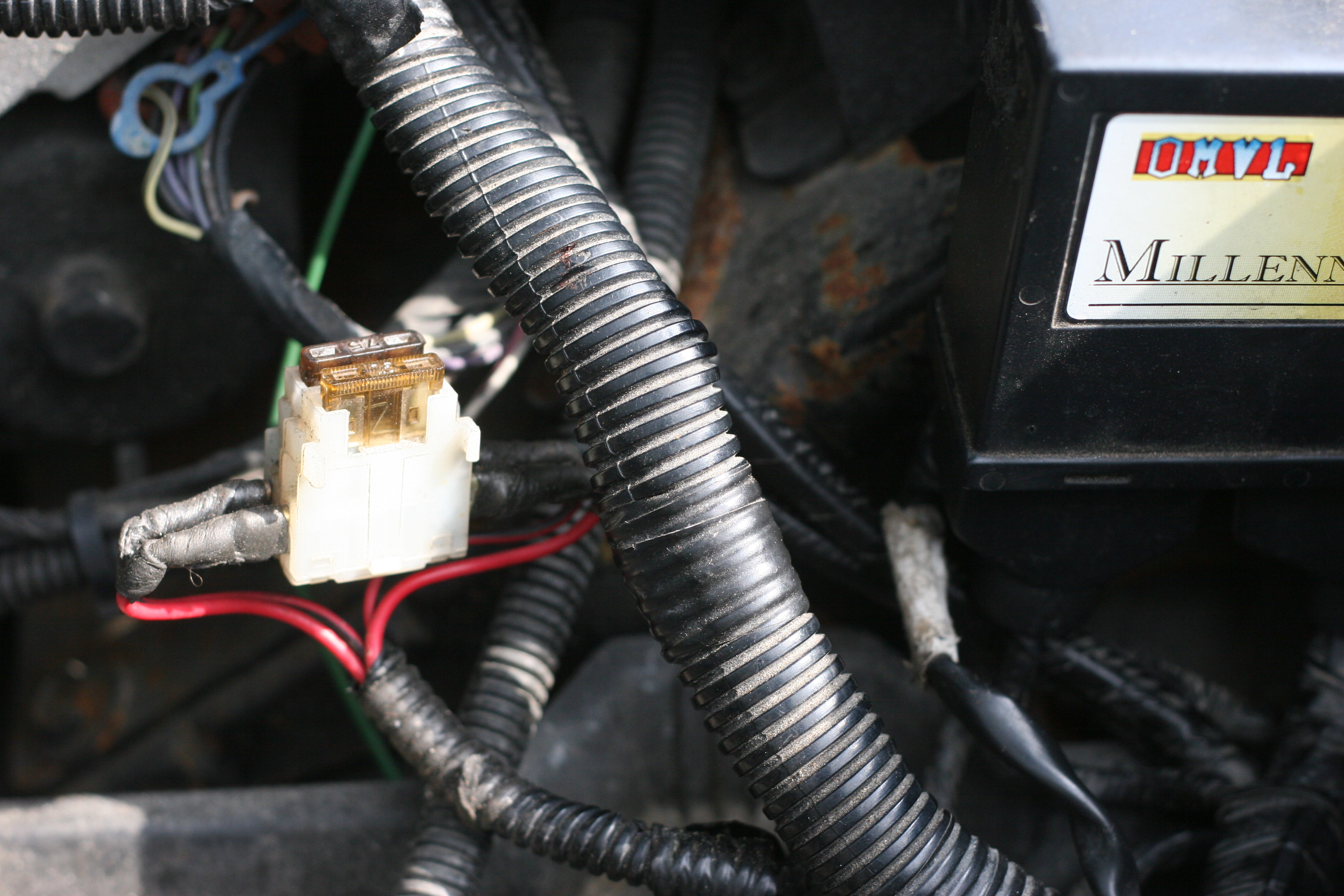

I had the motor quit on me this morning, handily, at the garage where I was presenting for MOT so a fresh fuse was available which reinstated LPG operation. The lights on the LPG changeover switch died with the motor and all came back with a new fuse. My thoughts were that I had a short at the reducer solenoid (I'd slightly re-arranged the wires to avoid the possibility of a short but went the wrong way I think). Could a short there have blown a fuse (one of two - see photo) and if it did, would that account for the changeover switch going dead? Or is there something else should I be considering? Just to add, its been faultless since the new fuse was fitted albeit less than 5 miles to home. System is OMVL Millenium.

From your picture they don't appear to have the same coloured wires. You have a Red, which is the ignition switched feed, and a Red/Black which is the permanent 12V. Although if you don't know which one blew then that doesn't help much.....

Gilbertd wrote: Thu Aug 14, 2025 7:26 pm From your picture they don't appear to have the same coloured wires. You have a Red, which is the ignition switched feed, and a Red/Black which is the permanent 12V. Although if you don't know which one blew then that doesn't help much.....
Good spot!
If - and it is a bit of an if - the fuses went back where they came from, it was the plain red wired fuse that popped. But as per question in above post - wouldn't there have been ramifications beyond the easy fix that was possible?
