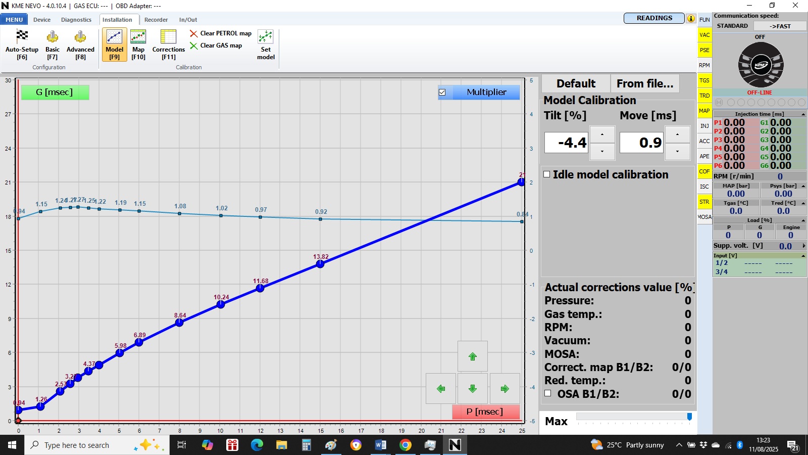

It is unlikely really detonating / knocking on LPG which has an octane rating of around 110, more likely that after a period of time that sees you use half a tank of LPG the petrol ECU flags up a problem with the knock sensor. Does the same problem occur if you run on petrol for that time period?
You don't set most of the multiplier / map according to lambda sensor readings, you set it so fuel trims are the same across the engine load/rpm range on LPG as they are on petrol. If you don't have ability to read fuel trims (via OBD live data) you can use the alternative method which is to make petrol injector pulse duration (pinj) stay the same when you switch between petrol and LPG across the engine load/rpm range. The fuel trims / OBD method is usually the better of the two methods and this is definitely true of the 2GR-FE engines. You only set high load open loop fuelling using lambda sensor readings and if the rest of the map is correct you should be able to guestimate where the calibration / multiplier should be for those conditions by extending the multiplier line (or if it's a table type map adjusting the numbers) to follow on from the shape of the closed loop map.
This (below) is one of my maps for a different make/model vehicle, using different injectors and behind the scenes allowing for the effectively varying petrol fuel pressure (petrol injectors are fed with constant pressure relative to atmospheric pressure regardless of manifold pressure while LPG injectors are fed with pressure that rises and falls along with manifold pressure so LPG pressure is kept constant relative to manifold pressure, at light engine loads with low manifold pressure effective petrol pressure is higher than at higher engine loads when there is higher manifold pressure, so a petrol injector pulse length of say 4ms at low loads will inject more petrol than the same 4ms pulse length at higher engine loads). Usually it goes open loop before petrol injector duration is 10ms but you can see that even if I had to guess the rest of the map between 10ms and 25ms it would follow the intuitive trend of the usually closed loop section between 1.5 and 10ms. Most of the map above around 15ms isn't used anyway because on this vehicle the peak petrol injector pulse duration is only around 15ms but it's still worth making the 16ms and higher figures correct in case the petrol ECU adds some 'tip in' enrichment when suddenly putting your foot down.
I'm not saying your map should look the same (and it likely won't because you'll be using a different ECU, injectors, pressure, on a different make/model vehicle and you won't have correction for effectively variable petrol pressure dialled in) but if it is correct it should be smooth and remain smooth around the usual transition area between closed and open loop fuelling.

At one point you seemed under the impression you calibrated the LPG system according to lambda readings.. That won't work very well at all, you need to use a better method such as the 'join the dots' method, 'compare pinjs' method, or ideally the 'compare fuel trims' method.
A straight line multiplier calibration probably won't be correct, it usually should peak at around 3.5ms and curve in a similar way to the multiplier chart I posted above.
I don't think we know much about how your temperature compensation factors are setup or the condition of your injectors.
You've said it was running rich at low engine loads according to lamda readings so you adjusted the the multiplier (all of it or at certain points, which points?). You didn't say whether the engine was running in closed loop mode, open loop mode or some sort of error mode (like open loop limp home mode) when it was running rich according to lambda readings - We need at least that info before we can advise you about most things. But one thing we can say is that if you only changed the low load area of the map it shouldn't affect mixture at high loads so shouldn't affect power at high loads and another thing we can say is that if it really is running rich all the time it will cause a P0420 error code (and other error codes).

What I do is I look at the fuel trims. I make the car run on a specific load on gasoline, then i switch to LPG and if it goes to like -10, -15 I correct the multiplier (lower it) so in that case there wouldnt be a jumping fuel trim, so it becomes stable. I don't know anymore, I just literally changed the multiplier on low loads and the power is gone now

When switching between fuels during calibration always allow it a few seconds to settle down before looking at readings because switching fuels can cause momentary changes to pinj and readings even if calibration is perfect.
If you only adjusted the low load area of the map it shouldn't have affected top end power... Unless by adjusting the low load area caused a different problem that makes it run in some sort of error mode.
Have you allowed for temperature and pressure differences when comparing how it ran before you made any adjustements to calibration to how it ran after adjustments? What I'm saying here is that if temperatures or pressures were different when you used to test it at high loads to what they were when you said it felt down on power then it could be an issue with temp / pressure correction that made the difference, not changing the low load area of the map that made the difference.

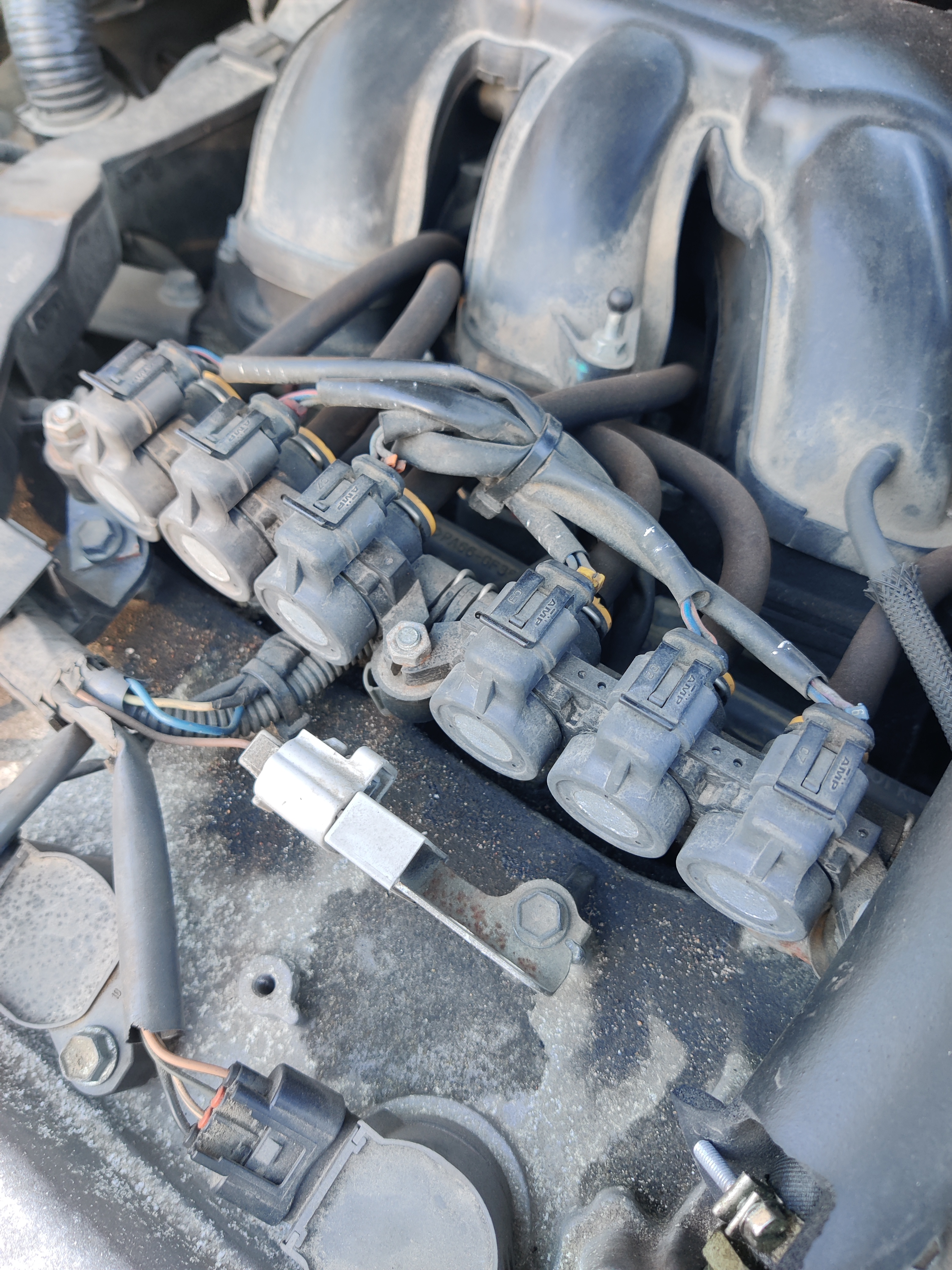

Sorry for late response. So after a trip to Poland (~1000kms) and some driving in my country i left the car sitting for 2 weeks. Started the car later, on gasoline it was doing fine. Just after switching to lpg i started hearing misfires that were intermittent. Didn't drive it anywhere, the next day i had to change the oil, had to drive it to heat the oil a little. Check engine started blinking on lpg- obviously an injector or two are not functioning properely anymore. I remember they were pretty loud since they were installed used already. The lpg installer mentioned that they might be worn out already. I'm planning buying same AEB injectors, but my installer said i could gain better results with some other injectors that are faster/ more precise. How true is that? Can they really wear out in that way or maybe i could just clean them? Would other injectors make my car feel more responsive or is it just a trick to pay more for fancy injectors? I'm going to go through installations and adaptations by myself as always any information is worth gold for me. Maybe tired injectors were causing all my problems since the beginning?

I forget what injectors you already have but if they're worn out they can create all sorts of mixture related problems due to inconsistent fuelling. There are two types of inconsistency, (A) For a given pressure and pulse length an injector should output the same amount of gas every pulse, if they don't then there's less control over fuelling / (B) Each injector in a set of injectors should flow the same amount of gas at a given pressure and pulse length.
If you mean the actual AEB branded injectors they're very quick at opening and closing, very linear and very accurate, but only if you're lucky enough to buy a good set of 2 x 3 cylinder rails. They don't flow a lot of gas so are no good for engines that make more than around 40bhp per cylinder (seem to have an internal restriction of around 2.7mm) and I found early rails were great while later rails of 3 always seem to have an injector at the end of the rail that flows less than the other 2 on the same rail (B type consistency problems).
Before changing injectors look at pressure and temperature readings to see if anything is different now to what it was when you said it was running great for all those miles. Could even be that your injectors are dirty. But if they're making louder ticking noises that's a sign they're worn out.

I have these. My car has 200 kW (268 bhp) and 350 Nm. Are they good enough? If not, what could I try instead of these? Never really looked into pressure or temperatures. There are no corrections made. All i have to choose from is there: https://sistemosklaipeda.com/produkto-k ... urkstukai/ . Thanks in advance
- IMG_20260305_160006.jpg (3.25 MiB) Viewed 1746 times
