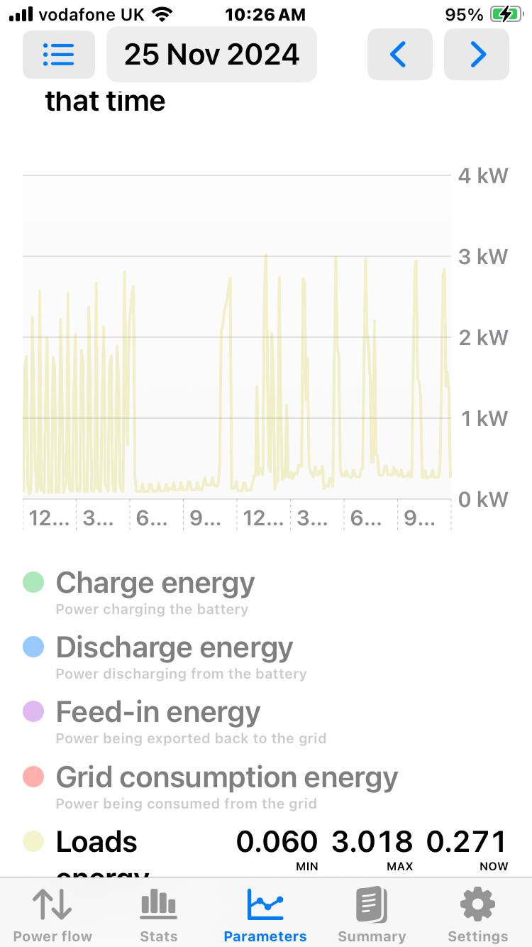

heres my power usage graphs over a couple of days recently ..
as you can see ,a lot of on and offing going on , i have the heat curve around 25-30c over its range , i have the water on 45 and turn it up to 53 for a bath , i have the hs set to 16.5c ,and if i get cold i light the wood burner .
i have the water deltas set to 1 degree ,and also pump speed delta at 1c .
i have the instructions, but they only tell you what each thing does, not what is the best setup . the lcd screen only shows tater temp ,room temp and ambient temp , no way to see scop .
i also have the transmitter for the remote contact , but no software i can find to download .
i do have the password to get into the installers settings .
i can set it so the rad water temp on the lcd creates a ripple pattern , or so it goes up and falls for a while then goes up again , but i dont know whats the best pattern to save leccy !

Notwithstanding the above I'd be tempted to set it up to YOUR comfort levels and see how it goes, with the insulation you have you could well be pleasantly surprised, if underfloor have it running 24/7

hitman2 wrote: Mon Dec 02, 2024 9:20 pm Solar pv?
How many panels (wattage)
15 x 415 watts ... facing 233d south west .
Location,,, on barn roof ..... just west of shrewsbury ,.
Battery size
4.8kw
Ambient air temperature, day, night
a lot af variation lately ,but ..
day -2 to +12
night -6 - +6
Rads or underfloor
rads , all new ,and fitted for the pump .
i have been doing that to a degree , most comfy is 18.5 c , but my leccy went to 23 kw in a day , so am trying to reduce that , but the regime to get the best from my system seems hard to define , andtheres nothing out there to help .

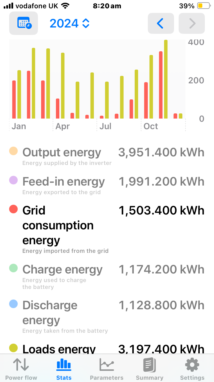

here is my years usage since the fitment of the system ..
which worksout on average at 4.55 units a day over the year , so better than before , and thats not counting the solar i have fed back which is 1991 x .15 ppu ...298 quid .

Your main problem is those minus temperatures, might as well just plug an electric radiator in when you get that low as the efficiency is down to 1 in 1 out....
I'd try cranking your buffer tank temperature up to the bath water setting and leaving it there for a good while, set up your main room stats to 21, bedrooms 17, see how it goes for a few days, don't be tempted to chase your tail too quickly, wait until your eyes are watering at the potential cost 😂😂😂
