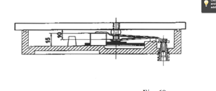

3) I've had several with different lever heights.
Dependent on where you look... OMVL quote x 2
Have you messed with this?

I may have used a genuine kit many years ago but the one I used recently was the Memtex pattern one. I only got it as my vaporiser was well and truly gunked up with the gloop, the only thing that would dissolve it was thinners and I wasn't sure what that would do to the rubber parts. The usual symptom of the rubbers starting to go hard is going rich at idle. I've never played with the lever height as I'm not ham-fisted enough to bend it when taking the diaphragm off. They do say to check it and unless you've got brutal with it there's no reason to suggest it will need adjusting.
Re: Memtex OMVL R90E R89E Vapouriser / Reducer Rebuild Kits
Thanks, I've what I think will be a Memtex kit on order. Lever height for me has always been a guess. I've 2 x R89E imported way back. Each had different lever heights, and neither was 15mm or 19mm. Never did get to the root of it, but it works.
