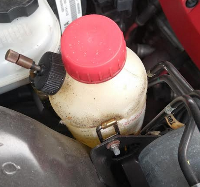

My LPG vehicle’s flash lube dispenser is not dispensing. I presume it needs a clean, what should I clean it with?
The car was not used much during Covid lockdown, perhaps that is why. It has been in the car since 2009 and dispensed during 148,000 miles.
I have attached a photo to aid identification of my actual dispenser.
Thanks
Photo of Flashlube dispenser, to aid identification.

Before cleaning - make sure the pipe is connected at the manifold end and at the bottle end, try adjusting it (uncscrew the brass thumb adjuster) to see if it starts dripping.
Not sure what you'd clean it with but for some kinds of cleaning fluids you'd want to remove it from the car to make sure they don't get into the engine (or to make sure highly flammable stuff doesn't get onto the engine). Maybe clean it with petrol but most basic vacuum type lube system problems can be sorted by fixing pipe leaks, seal leaks (check the rubbers at the top and bottom of the sight glass) or by simple adjustment.

I doubt you'd feel a vacuum if it's going into a spider type arrangement. You might if it's just a single pipe to manifold with nothing in middle of the pipe. The spiders have a metal braided cable down the centre.
The electronic ones are a bit more sophisticated, but if it's worked up to now sounds like sticking with what you have is best bet.
Blocked hose might also cause problems though the stuff is fairly thin so wouldn't expect a clog unless it's got contaminated with something

This morning I removed the dispensing bottle - it was grubby and there was jelly like deposits inside the bottle and dispensing mechanism. 13 years without any maintenance or cleaning is good IMHO.
I started the car (6.2L V8) and put my finger over the pipe connected to the inlet manifold - I could feel the vacuum. Which I took as a good sign.
I stripped and cleaned all the bottle and dispensing mechanism in petrol. I re-assembled and re-fitted and added a small amount of Flash-lube. The dispensing is occuring as normal. Hurrah.
