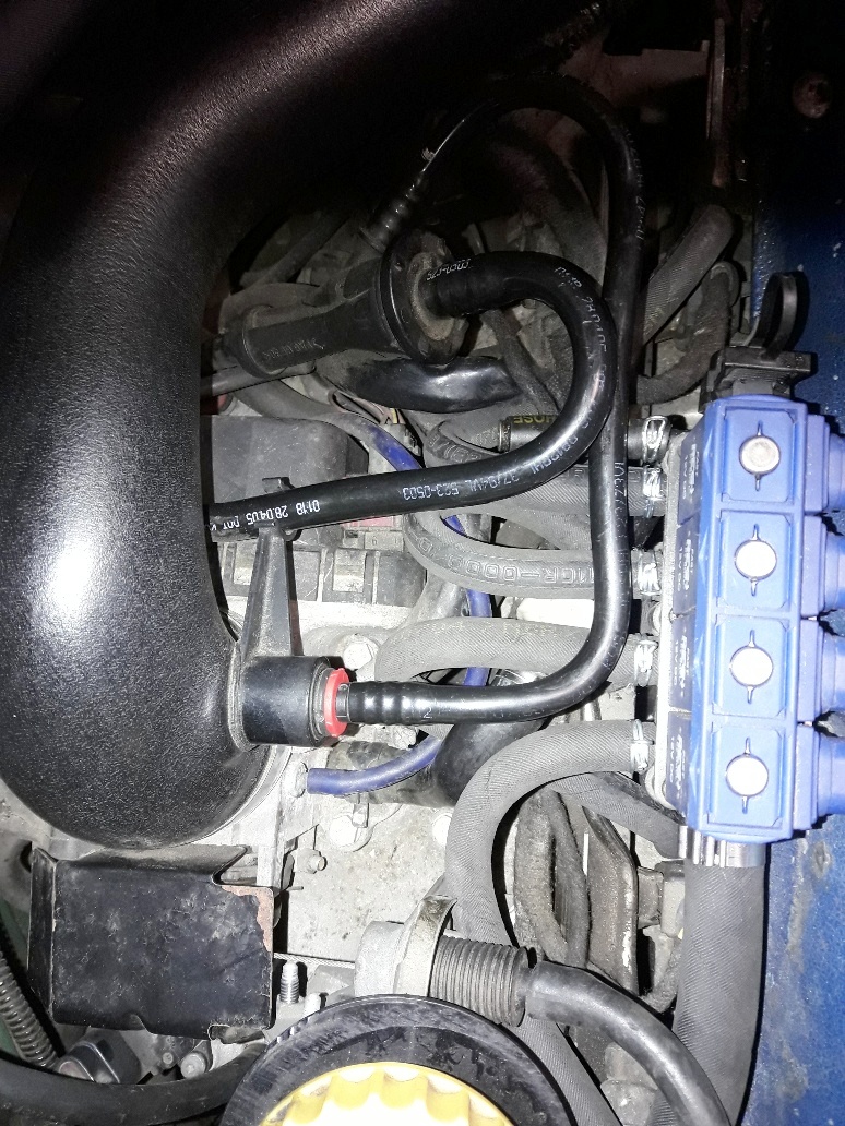

The only reason the pipes would be that long is if I put the injector rail where it will fit neatly and comfortably, but I could sit it on top of the rocker cover to keep the pipes short, it just looks a bit naff there and will be very close to the bonnet, not sure there's much clearance. In fact I suspect the omvl rail will be too bulky to sit there, but If I do manage to fit it in what nozzle size would you suggest? 2.5? The picture shows the current set-up, with the Baracudas stuffed in, tight radius on the pipes and all leakyLPGC wrote: Thu Mar 04, 2021 11:47 am Use LPG pipe for LPG not petrol pipe...

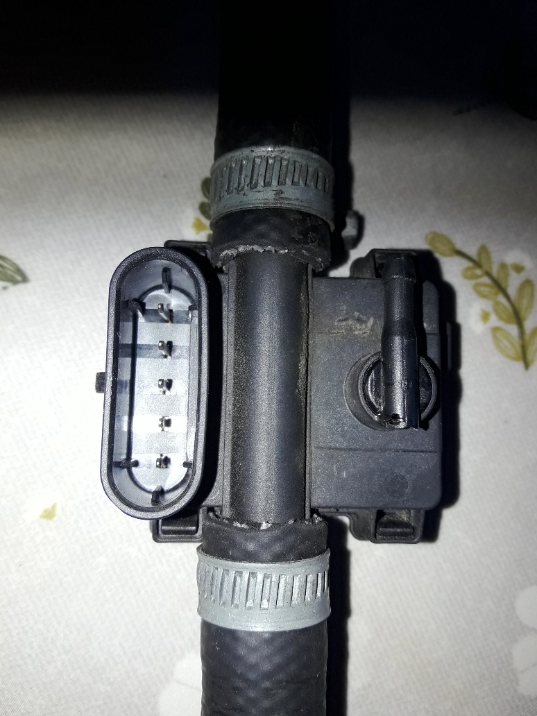

I don't s'pose this is helping matters, broken nozzle under the map sensor! Are these nozzles replaceable or do I need to buy a new unit?

Lol... No that wont' be helping matters at all.
You could replace the whole unit for what they cost, or try to fix another pipetail where that one is broken, or probably easier than fitting a new pipetail block that end up and fit a vacuum T so both the sensor and reducer get vacuum (that is if you want to connect the reducer to vacuum - initially your install didn't have the reducer connected to vacuum).

Yes this broken T, one end went to reducer, the other to manifold. Just ordered a new one, although your idea of blanking the broken end and T'ing off the other side would've saved me a few quid and a few daysLPGC wrote: Fri Mar 05, 2021 11:44 am Lol... No that wont' be helping matters at all.

Yes, it's definitely tricky getting into tight spaces, and is a slack fit on the 6mm omvl injectors I'm trying, not sure if the spuds are 5mm but the new 6mm pipe seems tight enough once secured with mini jubilee clips. Had to file away some of the plastic petrol injector casing on one of them where the spud was a fraction too close not allowing the new pipe to slide on. In hindsight it probably would've been better to buy 5mm pipe all round. I've moved a few things around and squeezed the injector rail in, but there are some tight radius's on the new pipe, what do you think?
