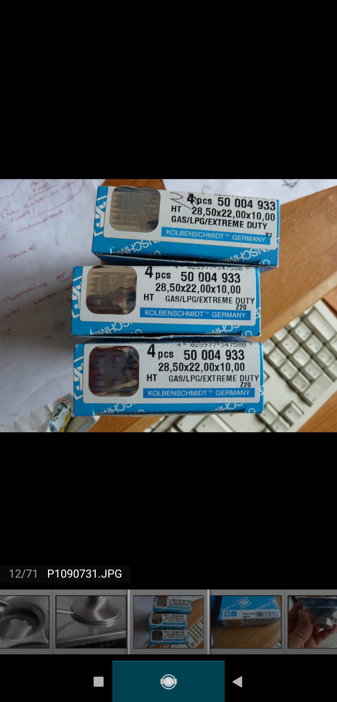

I found this useful website.
https://www.kmotorshop.com/content/detail/en/30
Previously I have used these in my Audi turbo engine. I would use the HT+ version now but it didn't exist previously.

Sorry, attachment didn't upload in the previous message.
