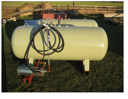

LPG at home? You'd require a transfer pump to shift the liquid. See piccy. The reason it's rare is that home tanks are pricey, and you get locked-in with 'orrible contracts via Calor or Flogas. Only vaguely viable if you already heat your home via LPG. Pump is pricey too. You require a bottom take-off on your home-tank. And most home-tanks lack this, which adds another obstacle.
Believe me, you don't want to be webbed-up with Calor or Flogas unless forced. They will crucify you. I used to live off-grid, thus heat my home with a coal-fired boiler and limit LPG to cooking so I might avoid the c&*%$£s. You wouldn't volunteer to be in with them.
- AutogasLPG Tank&Pump01.png (239.93 KiB) Viewed 4965 times
