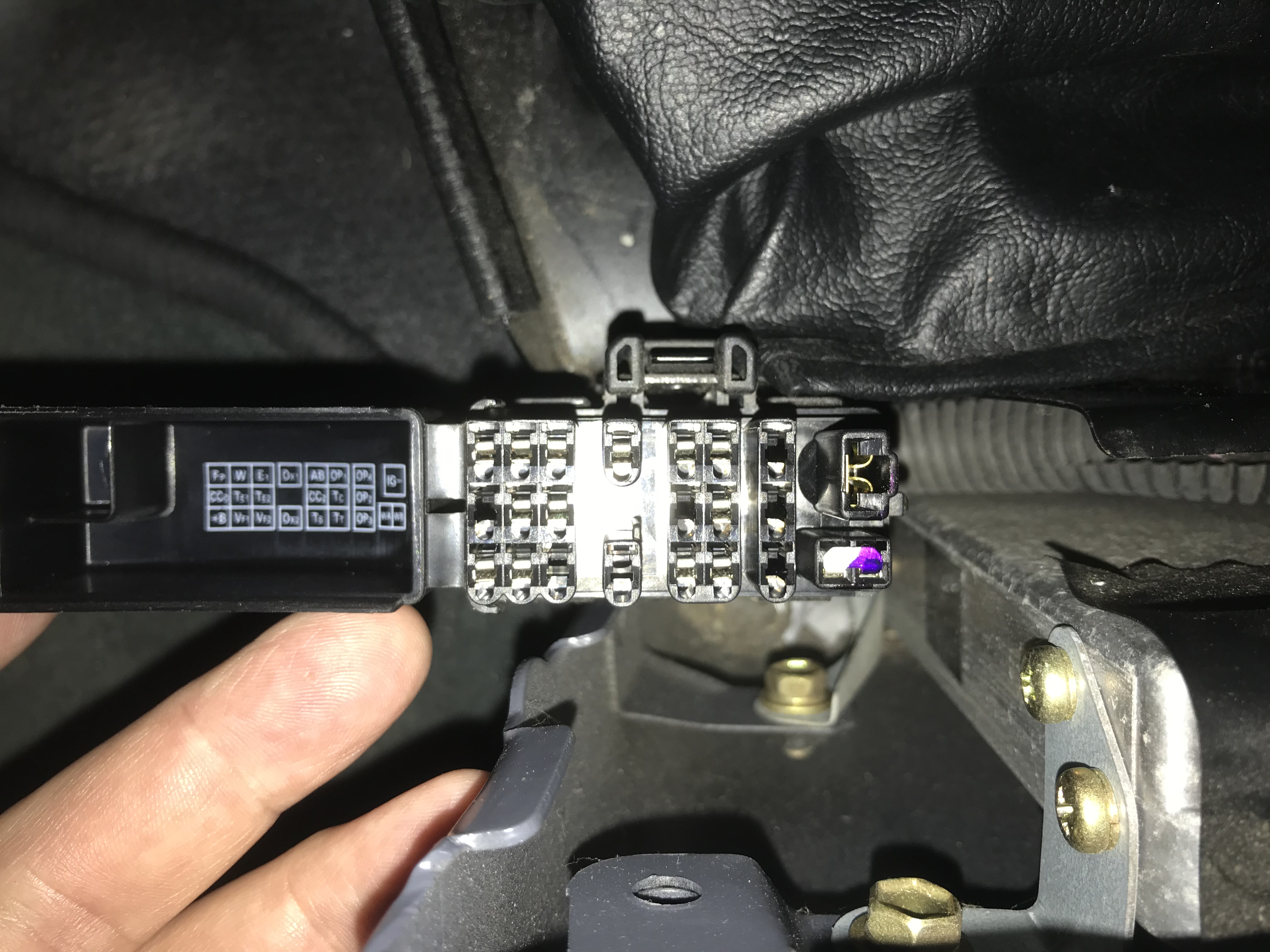

I have been looking at cheap readers, I have an old diagnostics 17pin OBD.

Some late 90's Japs have standard looking OBD2 ports but a normal OBD2 won't work because the port is actually OBD1 or JOBD that's just been wired to use an OBD2 socket. An OBD2 scanner might work or might not..

It’s 17 pin.

Ahh, that isn't JOBD. JOBD uses the same connector as a standard OBD connector, just a different protocol. Never seen one like that I must admit but I doubt it will store any misfire codes so wouldn't help you anyway.

Other model late 90's Toyota's have the same diagnostics port, sometimes fitted in the engine bay instead of inside the car. Not always or necessarily used with a code reader, some of the pins are probably wired directly to lambda probe signals etc. Seems to be an abbreviated pinout description in the cover? Sometimes with this type of diagnostics port you can get a light on the dash to flash error codes morse-code style by shorting a couple of pins - But don't short any pins yet, read up on this on Toyota forums before doing anything like that first. Probably best to stick to old-skool (swapping coil packs around etc) diagnostics. Some Toyotas have a similar looking port to this in addition to another diagnostics port (so diagnostics ports, one port wired to engine components so lambda sensors, an rpm signal, TPS, etc, one port to be used with a code reader).
But the garage should know how to do old-skool diagnostics.. If they don't, or if they're lazy enough to only want to get involved if they can plug something in that will tell them what's likely to be wrong in plain English, use another garage.
