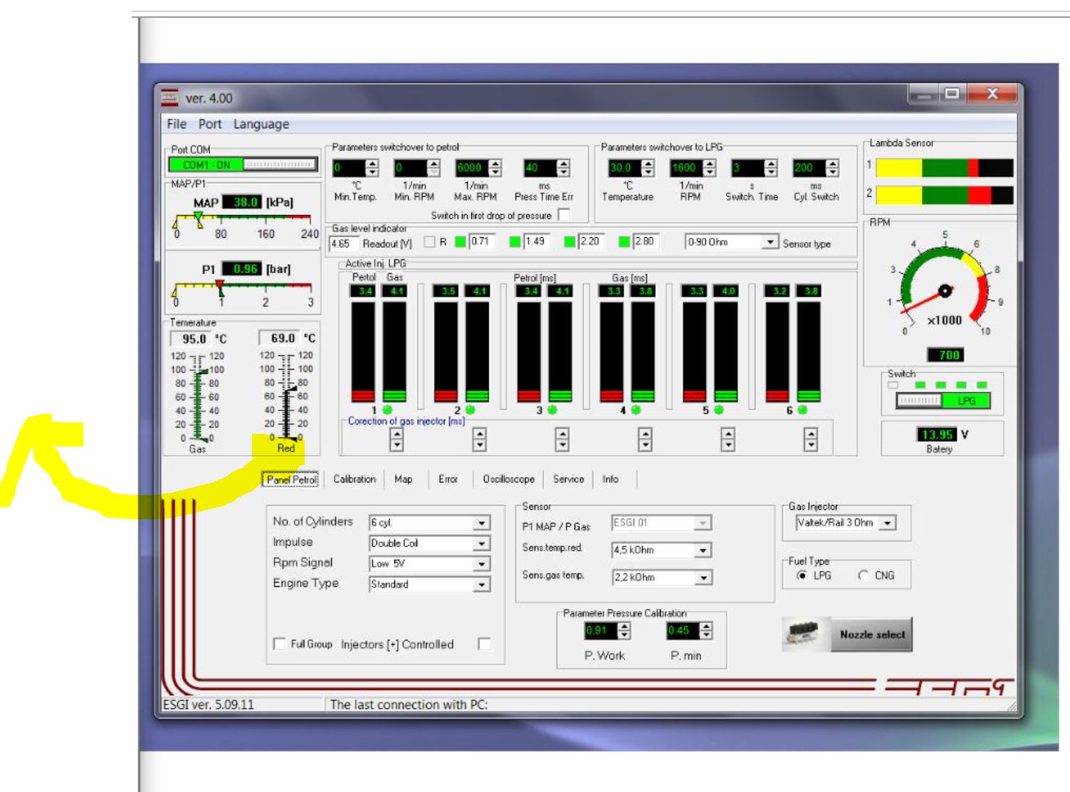

was misfiring but didn't show any errors whilst driving,
should i alter gas switchover temp?
is the reducer temp i need to check in the morning the one that says red
shown in photo?
how do I know what sensor temp settings I should use?i copied the ones off my old ecu

I forgot to add the photo in my last post is from my previous fault and the gas temp shows 95.0c
Re: v6 audi 2.4 feels like fuel starvation
Yes Red is the one I meant but also watch the Gas temp reading, what is that reading on a cold morning start?
Obviously want the temp readings on screen to reflect the real temperature of the reducer and gas but if the type of sensors is selected wrong in software it won't reflect the correct temperature. With the wrong spec sensor selected in software there can easily be a situation where for example on a cold morning the reducer or gas reading shows 29C when actual temp is only maybe 8C, and then the reducer warms just a little bit up to say 12C the reading on screen is 30C and the system will switch to gas when the reducer is really too cold. The vapour temp reading is only used (on this system) for knowing when the reducer is warm enough to switch to gas. The gas vapour temp reading effects fuelling because hotter gas is less dense than cooler gas so when gas is hotter it compensates for the lower mass of gas being injected by pulsing gas injectors for some percentage longer and vice/versa with cooler gas, so you want this reading to be accurate too.

I was wrong took it out today and found it kicked into gas after a few hundred yards.
switched to petrol until it fully warmed.i switched to lpg and found it lumpy hesitated on acceleration.
I changed one of the rails calibrated and its running fine.
I did notice the temps were 95.0c gas and 86.0c red when cold
so I think temp sensor is kaput
is the sensor a t-piece like the one in picture?
It might be the wrong temp sensor selected in the software - Can you locate the one on your system currently and take a photo of it?
It will either be a t piece like that, or may be directly connected into the reducer
I've looked through your other screenshots and photos - you have the same type one selected as before, but no photos of what it actually looks like that I can see.
