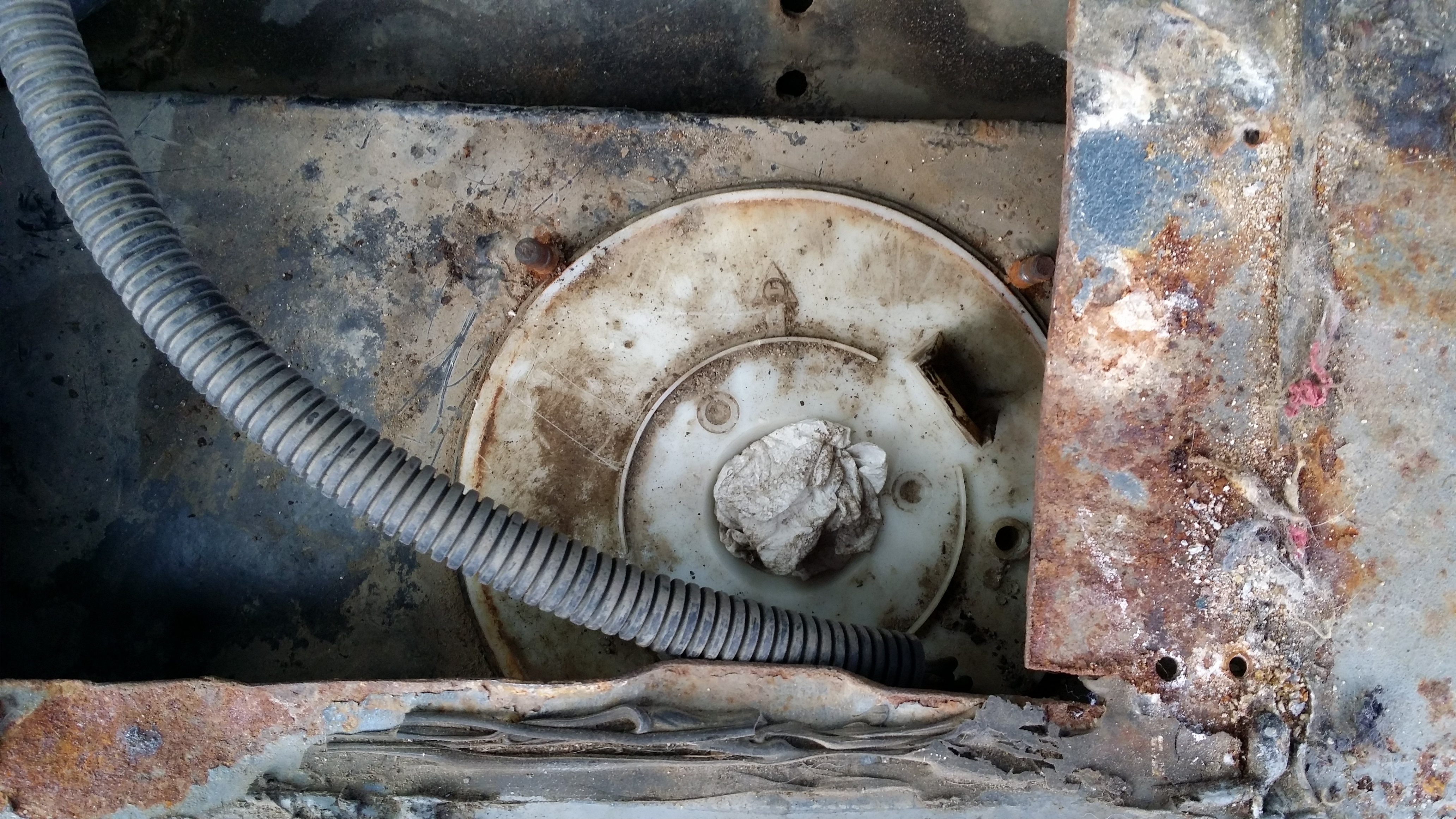

Folks,
I wonder if anyone has dealt with this problem before?
I've got the Tinley Tech dual tank setup and the petrol pump has failed. There's a hole in the boot floor so I can (sort of) reach the pump module but the gasket is so tight I can't shift it.
When I fitted the pump it seemed tight, but now after a couple of years it seems utterly immobile. Does anyone have any smart ideas that will help me replace the pump?
The Jeep is of course stuck at home and won't start on gas.
Just for laughs, here's a photo:

Can't really see how it's supposed to come out from that picture Miles. Does it just pull out and the gasket has glued itself to the top of the tank and the underside of the pump flange? I that case, running a Stanley knife blade around it should do the trick (yes I know, the Stanley knife does seem to get used for an awful lot of things....).

Aye, that would be me - exact same situation. Dead fuel pump, and a Prins system which won't start on gas. I have another GC which runs a King system, and that'll start on gas, but not the Prins.
You can see the fuel pump gasket arrangement here - http://www.ebay.co.uk/itm/Fuel-Pump-Ass ... Swe-FU-CBr - that's the same one I bought, works fine.
And it looks like you have knocked the pressure regulator off the top, so will definitely need a new one!
I just knocked screwdrivers under the lip (after taking off the metal retaining ring, which I see you have done) and it gradually came out - then it bounced out and threw petrol everywhere when I lifted it out.
If that hadn't worked, knowing what I do now, I'd just knock screwdrivers through the side of the pump where necessary, as you'll be replacing the entire module, and yank it out like that. You don't need any of the old parts - the new pump comes with regulator, gaskets, everything.

Well I got it out :)
Sorry I didn't reply earlier! I had to take the pressure regulator off to get to the nuts on the retaining ring. I'd done that when putting it in too.. it just snaps out and back again.
I had checked the feed for voltage, and it was good so I was pretty sure it was the pump. The new one is in and pumps fuel. Now I just need to get some replacement line made up because the original pipe was cut down and a flexi pipe clamped over the top which crushed it and caused a leak :(
