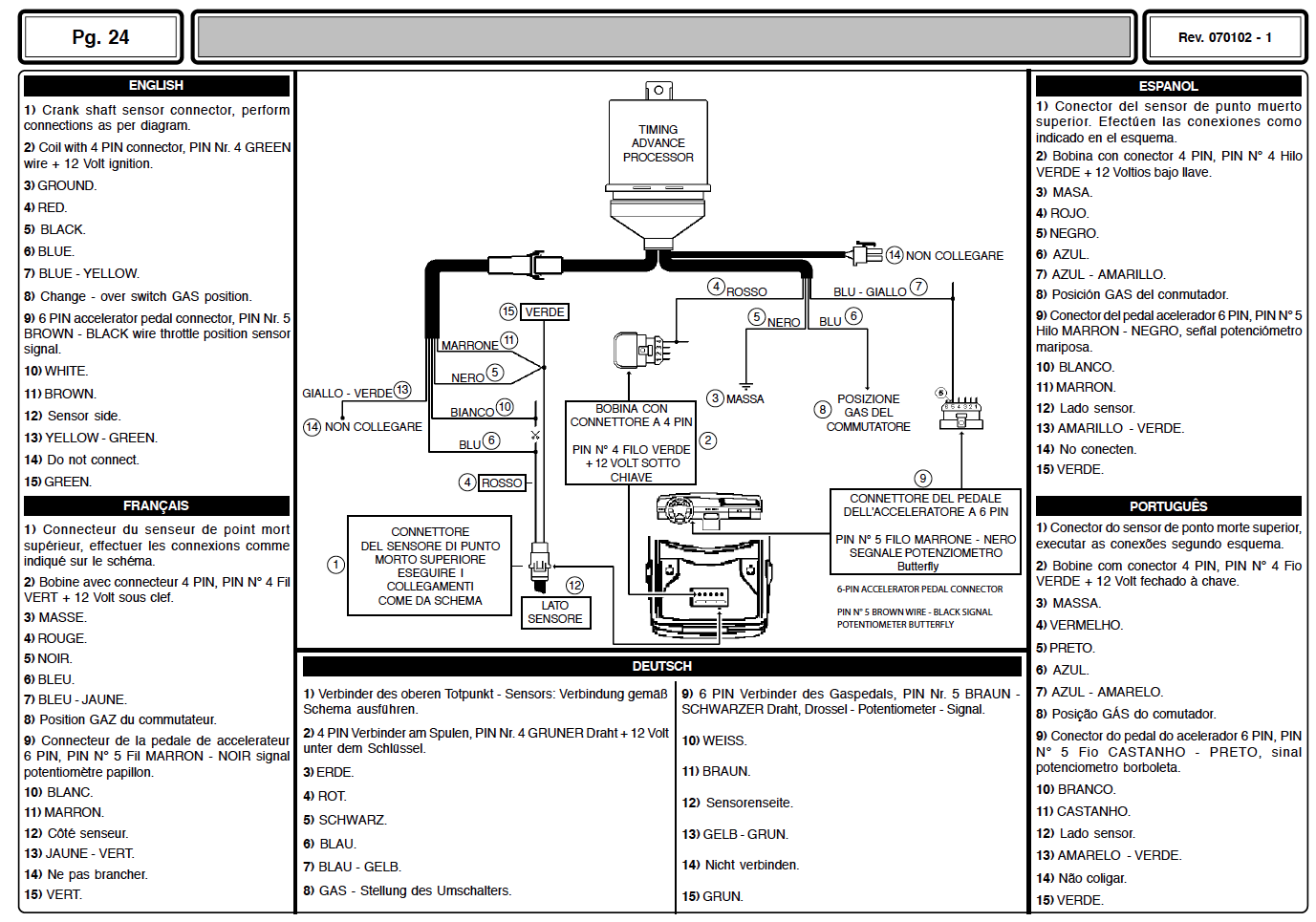

The nearest I can find to my 1999 Denso set-up is AEB's drawing for an S60. It's my understanding, S60 or Denso V70, B5244S they're set-up much the same. I'm a bit worried, money aside it's the time spent on this. If I'm wrong I'll have to take it all off again. Thus, back to Necam.
Why £380 you ask?
AEB 510N TAP (including delivery from Italy ) = £110
AEB 001N Data lead (including delivery) = £70
AEB011N Firmware from Tinley ( I took their the last one?)=£130
AEB410F Lead (including delivery from Netheralnds) = £70
Wheras the EG is about £60-70. And i still don't know if this AEB stuff is correct, and it's still not all here yet. ... ouch.
On order I still don't have the complete set-up. Going in blind, I had no alternative. Having taken all the multipoint stuff off for shortage of info, this to get the Necam on, I'm now back in again to reverse my work. It's not even the money, it's the hassle. At present, I'm aiming for this....

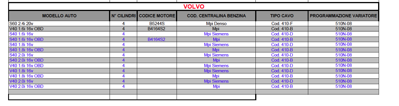

Unable to find definitive info on a TAP and with supply choices limited, I had to bite the bullet on this one. I sit here with an AEB510N + all the pricey ancillaries. AEB offering firmware for this engine is, "wot swung it" yet I'm having my doubts already. I've long-since disappeared up my own rectal-passage, left guilty of overthinking this.

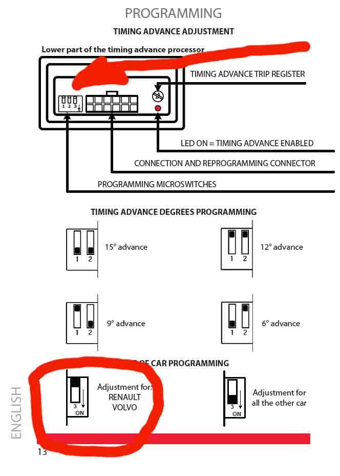

Thing is, despite AEB offering specific model-specific wiring diagrams, they omit dip-switch settings, which is both typical to AEB documentation. or very likely a clue? Can't help notice that if we take AEB's word - this engine is a 4 cyl too?
Volvo firmware (Version 08) is grouped with Renault, thus Renault & Volvo get sole use of AEB's firmware variant [AEB510N-08]. There's also a dedicated Volvo/Renault dipswitch on the TAP.
Is this a clue? See dipswitch 3. I've looked thru' hte Renault info and see nothing. I ask, what's common/unique to Renault/Volvo engines that has AEB trouble with specific firmware and a whole distinct Volvo/ Renault dipswitch?
AEB510N-08 Renault.png (157.81 KiB) Viewed 5862 times
AEB510N-08 Volvo.png (96.98 KiB) Viewed 5862 times
I'm under the impression Volvo engines don't requires a TAP running LPG, thus specific to Renault and Volvo, does this narrow things down?

Lots of well known bugs, typos, omissions, contradictory info and crazy spelling mistakes in some of the AEB documentation and software... the 2 classics are the wiring diagram that shows incorrect wiring for level sensors on mixer systems and software that spells 'high' as 'hitgh' in big letters on screen lol. Maybe just try the different advance settings and see which gives best results, start at 6 degrees and advance from there? I'd expect close to 12degrees advance to be right for low rpm no load on CNG.
Maybe if this TAP connects to TPS then dip3 relates to some aspect of the TPS on Volvo's and Renaults. Or maybe it affects how the timing advance 'comes in' again following an over-run condition (the TAP usually puts timing back to normal and is inactive during over-run?)... Some LPG ECU's advise setting certain settings on Renaults that effect fuelling following an over-run situation (to prevent stalling or poor drive-ability) but they don't mention Volvo's and there's no mention of ignition timing. Or could be something else I haven't thought of.
There are only small gains to be had from fitting a TAP on some LPG converted engines but a TAP is necessary on CNG converted engines.

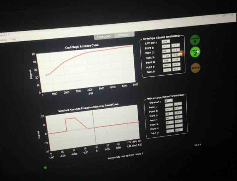

And thinking about this, the Land-rover runs a two curve electronical doo-wacky dizzy, which kinda beats a Lucas 45D, and the curves as far as I've ever got with them without a rolling-road, are very different...
Petrol
Methane
And whilst I've got the vacuum responses set identical, they almost certainly shouldn't be, but it works. It's odd running a 1960s Land-rover via a laptop, but it happens. And it’s never too late to have a happy childhood.

Again I think you might be right. This was an attempt to follow AEB's own drawing wrt to a very similar engine in the Volvo V60 - see 9 on the drawing:
TPS or Accellerator.png (186.11 KiB) Viewed 5364 times
Only had a cursory look at it, but it's not going to plan. The ECU doesn't seem to like my boy's efforts coming off the pedal-sensor as AEB's drawing. OBD is throwing throttle codes. I'm sure you're aware, more for benefit of others, this 1999 car was Volvo's first with an ETM, electronic throttle module, an output from that might do it.
I've n oscilliscope here, I'll have gander, and a word with Dai when we get back from hols. And thank you again for your watchful eye.

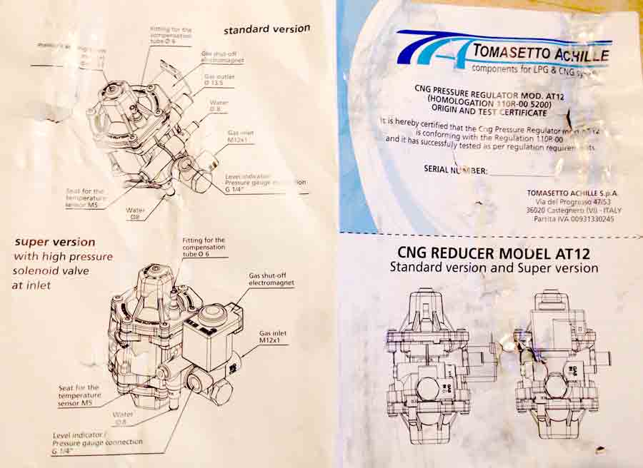

Well, Nevo is running. Kind of... Because all the wiring was complete and it was broadly ready to go, the boy and I had a quick play with it on hols (as you do). It ran poorly. Rang Dai and under his phone-instruction my boy had 10 min play. Dai came to the conclusion the Zavoli injectors were not large enough. We did an Auto set-up and the car was not good but drive-able. Under high-load it'd drop back to petrol, and this appeared to get worse when the tank was at quarter full. Now with 500ish miles under gas we're home again. In that time things improved. It would run happily whether given a full 200Bar tank or a 50Bar quarter tank.
We're a little perplexed as to why fuel-tank pressure did make a difference, and why it doesn't now. It's a Tomasetto AT12 (the 2018 model). Tomasetto have recently revamped the AT12. I wonder why?
03Tomessetti-AT12 Late type.png (306.58 KiB) Viewed 5064 times
