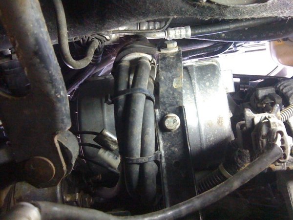

Just looking at your first images again, it looks like the vacuum pipe from the vaporiser to the T-Piece is barely connected. The other side of this T goes to the MAP sensor.
If you want to check all your vacuum lines and connections. The parts that I have found are prone to perishing are the rubber ends on the stiff hose that runs from the carbon canister on the left of the bay to the throttle body via the non-return valve I think it is.
Anyway, I shall await your response.

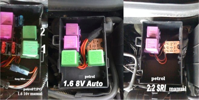

here are pics of the injector, splitter, and fuse box...

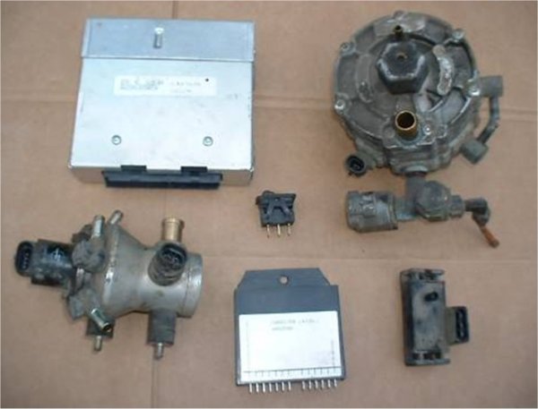

ohh and a pic of the parts i was looking at...
lpg parts.jpg (35.18 KiB) Viewed 4994 times
mainly for the vapouriser/coolant sensor, map sensor
cheers....

As I thought, those parts are from an older EGI system.
The only thing you can use is the vaporiser and attached sensor, although it could be more than a couple of years older, the MAP is probably the same and the switch.
I'll get back to you on the other things.
Is that image of the fuse box your box or identical to your box. Although I don't think this really matters right now.

hi pj, yer i know they are from an older model.
but if they are working and depends what they go for. it might be worth it.
yes thats the fuse box from the lpg astra.
i labeled it as i also have a normal 1.6 astra i got for spares.
to fix up the lpg astra and a 3dr 2.2sri
so didnt want to get them mixed up..

Those injectors look a pain to get to. Track the wiring from each one and check for damage and check they are all connected through. The tails are about a foot long I think.
You've got the standard GSI distributor there which may or may not have a filter built in.
You must have posted that fuse box image in the old forum gallery.
You look to have the correct relays there but the actual location of the relays are possibly wrong. Two are changeover relays (2 way) and two are switching (1 way) I believe, so, if two of those have been mixed up... However it seems the signal to switch may not be getting this far.
There was also someone on here that found the LPG harness connections had been changed around under that fuse box. Basically the LPG harness looped on itself but the car ran fine on petrol. It wasn't too long ago so you'll find it easy enough if you look through my old posts or do a search.

That spare kit~ It all looks very well used and to be honest you may find the vaporiser will require a rebuild. Especially if it's been sat around not working for some time. So you may as well re-build your own if needed.
Regards

both those green replays are made by Hella ? not GM
i think somethings wrong there.
the first relay (marked 1 in the pic) is a 5pin replay.
yet the block it plugs into only has 4 connecting pins
wires are..
red/black
thick yellow
yellow/black
thin yellow
hella 12v, 5 pin relay
4RD
003 520 - 25
pins 30, 85, 86+, 87, 87a
the second relay is the same relay as the first one.
but this block has 5 connecting pins
wires are.....
thick yellow
blue
blue/white
blue/yellow
blue/black
relay plugs.jpg (58.76 KiB) Viewed 4966 times
the two purple relays are both 4 pin
and wiring to both blocks are for 4 pin
GM
90 494 959
12v 30amp relay

Relay 1 will be the main LPG relay. I believe these are the connections.
Coil
Pin 86 Thin Yellow
Pin 85 Y/Blk
Switch
Pin 30 Rd/Blk
Pin 87 Thick Yellow
It's just a one way switch that is required here.
Relay 2 will be the Petrol/ LPG injector switchover relay. I believe these are the connections.
Coil
Pin 86 Y
Pin 85 Blu/ Blk
Switch
Pin 30 Blu/ Wh
Pin 87 Blu/ Y
Pin 87a Blu
There is no real need to check the pin connection wiring. It will be correct. Just make absolutely sure one of those other 4 pin bases isn't a five.
The only other relay that is a 5 pin is the fuel sender changeover but, like I say, this may be in the boot.
Found that thread.
http://www.lpgforum.co.uk/viewtopic.php ... tra#p50593
Regards
PJPJ
To help identify your Vauxhall LPG model, go HERE
pjpj
Posts: 1295
Joined: Tue Oct 31, 2006 12:16 am
Re: Astra 1.6 16v wont switch over to LPG
#73 Post by pjpj »
By the way, you should have 12V direct from one of those fuses on the RD/ Blk of relay 1.
Y and Y/Blk is the 12V and ground feed, not sure which is which, from the LPG ECU to Change over to LPG.
Once this relay energises, the rest of the system energises.

hi pj, thanks for all your help its much appreciated.
il check on that tomorrow.
i think it will be best to check the pin connections, just to make sure they are right.
so should these two green relays be GM or does it not matter...
and relay one should be a 4 pin relay ?...
so its a good chance the 5pin one in there is the main problem...
the other two purple relays are both 4 pin, 2 of the pins are wider then standard.
the blocks are both purple colour and wired for 4 pin.
il take a look at the two green relays in the other astra tomorrow, see what they are.
yes the fuel sender changeover relay is in the boot on the rear of the lpg tank.
tank relay.jpg (28.86 KiB) Viewed 4960 times
and looking at the picture and 1301 on the side of it.
i think thats the same relay as the two in the front fusebox.
cheers for finding the thread, il take a read of it...
ok il do some testing tomorrow and see what i find.
cheers
cheers stuart....
pjpj
Posts: 1295
#75 Post by pjpj »
Sorry, I didn't make it clear.
A 5-pin relay will work fine in a 4 pin base. (So long as it fits of course)
The reason a five pin will have been used is for simple logistics. Use the same product for all the relays (LPG) and you can't go wrong.
I can see from the relay bases, they look correct.
All the relays look correct but you are best testing the operation of the two green relays and I assume you know what I'm getting at with my last post and the 12V etc.
Regards
PJPJ
