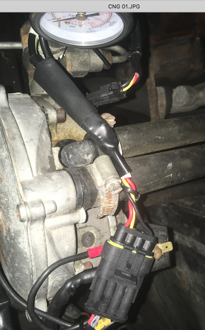

Fuel sensor is in dashboard because I've one of those Spiyda Gauge Wizards in. The CNG 5-0V sensor will feed the stock Smiths resistive LR petrol gauge. LEDs break the spell - in my mind, eye-bleach in a classic.
https://spiyda.com/fuel-gauge-wizard-mk3.html
Suspect their usual buyer won't be for this sort of thing, Spiyda have been ultra-helpful with this oddity.

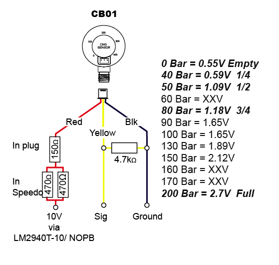

1) I've now got a properly functioning CNG gauge/sender, this displays to my stock Smiths gauge - interfaced via a Gauge Wizard.
CB01 Gauge.png (528.19 KiB) Viewed 740 times
Chis at spiyda.com was very helpful.
It took over a dozen of the Chinese gauges to get a combination that works. What with faulty gauges via AliExpress, time to get them etc etc, the whole sorry saga FINALLY comes to an end. I'd detail the actual solution in another thread. I was like a dog with a bone on this, the bill for a functioning fuel gauge come at roughly £350, and on and off, what must be a good week's work. No... I don't believe it either.
CB01 CNG Sender with 10V.png (52.1 KiB) Viewed 760 times
Above is the shorthand version of the solution. Will cover full 'how & why' in another thread.

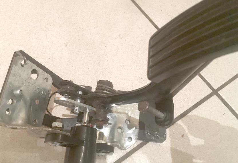

2) Mounting a TPS on an SU carb. I didn't like this idea, I've made a barn-yard competent pedal-operated TPS. Series land rovers have a rod/lever throttle linkage. Horrible cumbersome thing, I put in a cable-op from the later Defender thus:
NRC5220 NRC7827 TPS Solution.png (227.15 KiB) Viewed 757 times

As mentioned earlier in this thread, what took the time was finding a sensor that I felt could wangle to have the 30 degree of the pedal make 90 degrees for any stock TPS.....
ISUZU NKR 600P TPS 8973059220 01.png (102.69 KiB) Viewed 756 times
I found: ISUZU NKR 600P TPS 8973059220
See it before I fettled and painted, with a bit of messing to get the geometry right I got this....
TPS Not to an SU after all 02.png (736.37 KiB) Viewed 756 times
TPS Not to an SU after all 01.png (866.69 KiB) Viewed 756 times
Shown 'pedal-down' and 'pedal-up'.
Gets to the required 90 Degree of TPS sensor throw; this from 30 degrees of pedal.
It's well out of the way thus it won't get kicked. I've since painted the lot black - you'd not know it was there.
