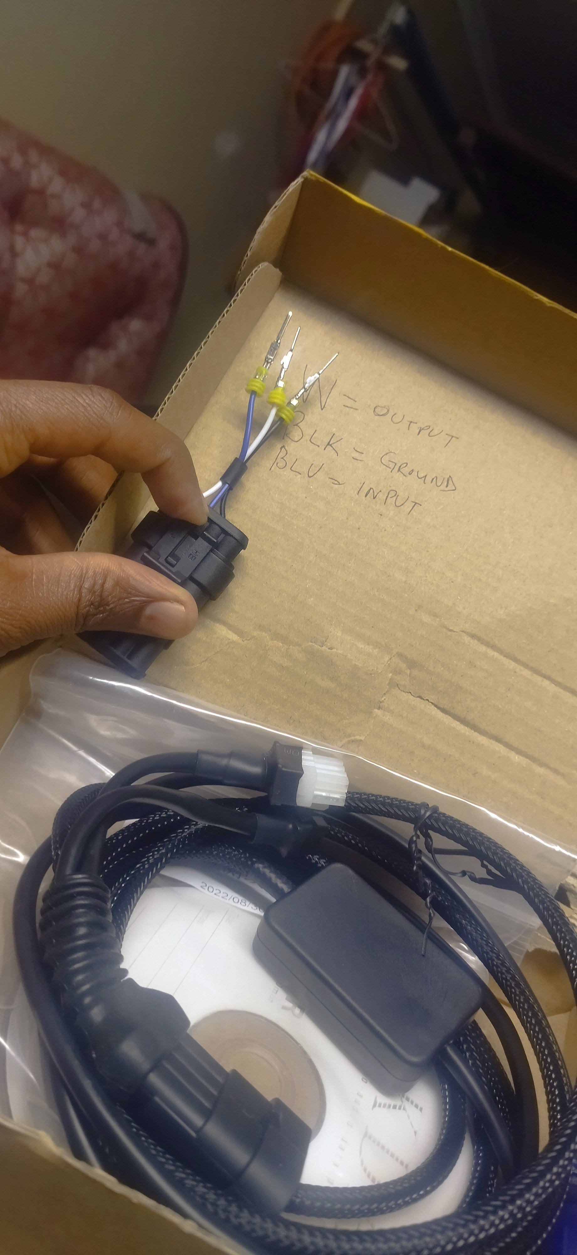

Car started misfiring/shuddering /jerking this week when running, hit the switch to petrol and it runs super smooth. Unfortunately the technician/installer is MIA, so I need to access the interface to see what's happening.
My USB interface cable has x3 wires
USB interface cable with x3 LED indicators on USB side.
The diagnosis cable from the ECU has x4 wires
Port on vehicle
Port on vehicle
I know the port works as the technician/installer used it on numerous occasions, so just wondering WHY I'm not picking up a signal on the programme. I've tried x2 different programmes, and both cannot connect to ECU. Any thoughts or ideas?
