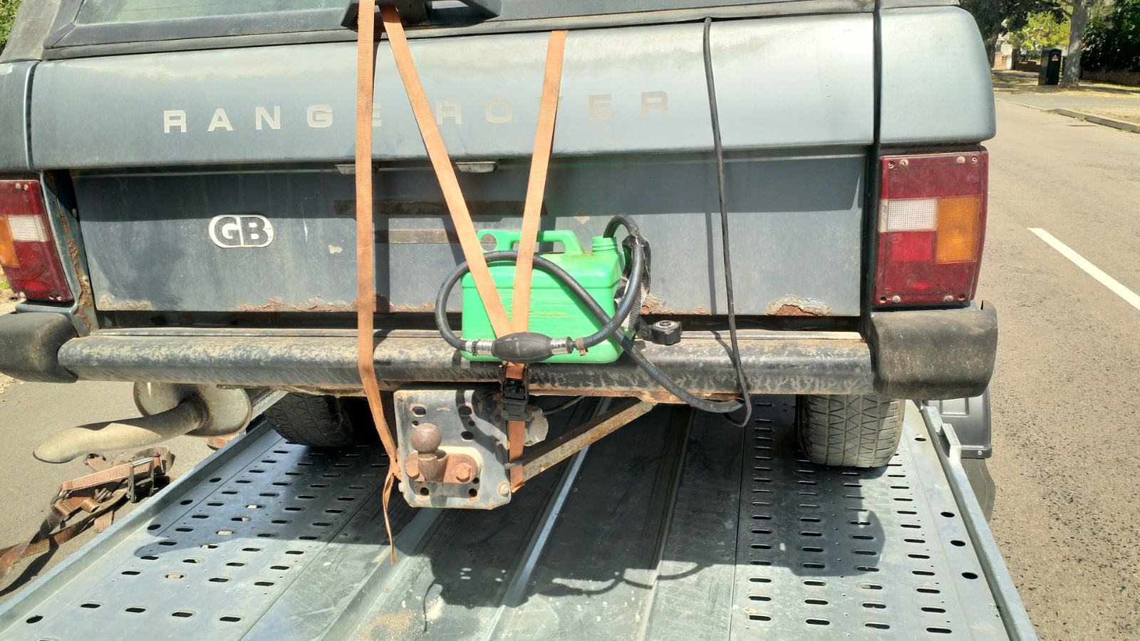

Those fuel pumps, when used for petrol, are always mounted low down as they don't self-prime, so the petrol inside them won't evaporate. I used one, or at least a similar type of pump, on a Range Rover Classic where the original in-tank pump had died and dropping the tank wasn't an option due to a wasps next behind the rear bumper. As the car only had to move a couple of miles under its own power, I strapped a petrol can to the back bumper but found the pump couldn't prime so had to add a priming bulb from a boat outboard motor.

Yes, the Classic does have a pressure regulator on the fuel rail and a return. The problem we had was that the car was at the top of a mountain in southern Spain and the road was too narrow, twisty and with adverse camber to risk coming down with the weight of the car trying to push me off the edge. So we cobbled that together so it could be driven down the mountain and loaded onto the trailer on the flat at the bottom. It managed it with just enough left in the can to be able to drive it onto the trailer. The cable you can see running from the pump underneath (fitted in the space where the fuel filter would normally be) up through the tailgate was plugged into the fag lighter socket so it was only powered when the ignition was on.
Hadn't thought about the gas pressure priming the pump when used with LPG but that makes perfect sense. I suspect with the gas we've been getting recently, the pump will get lots of lubrication......

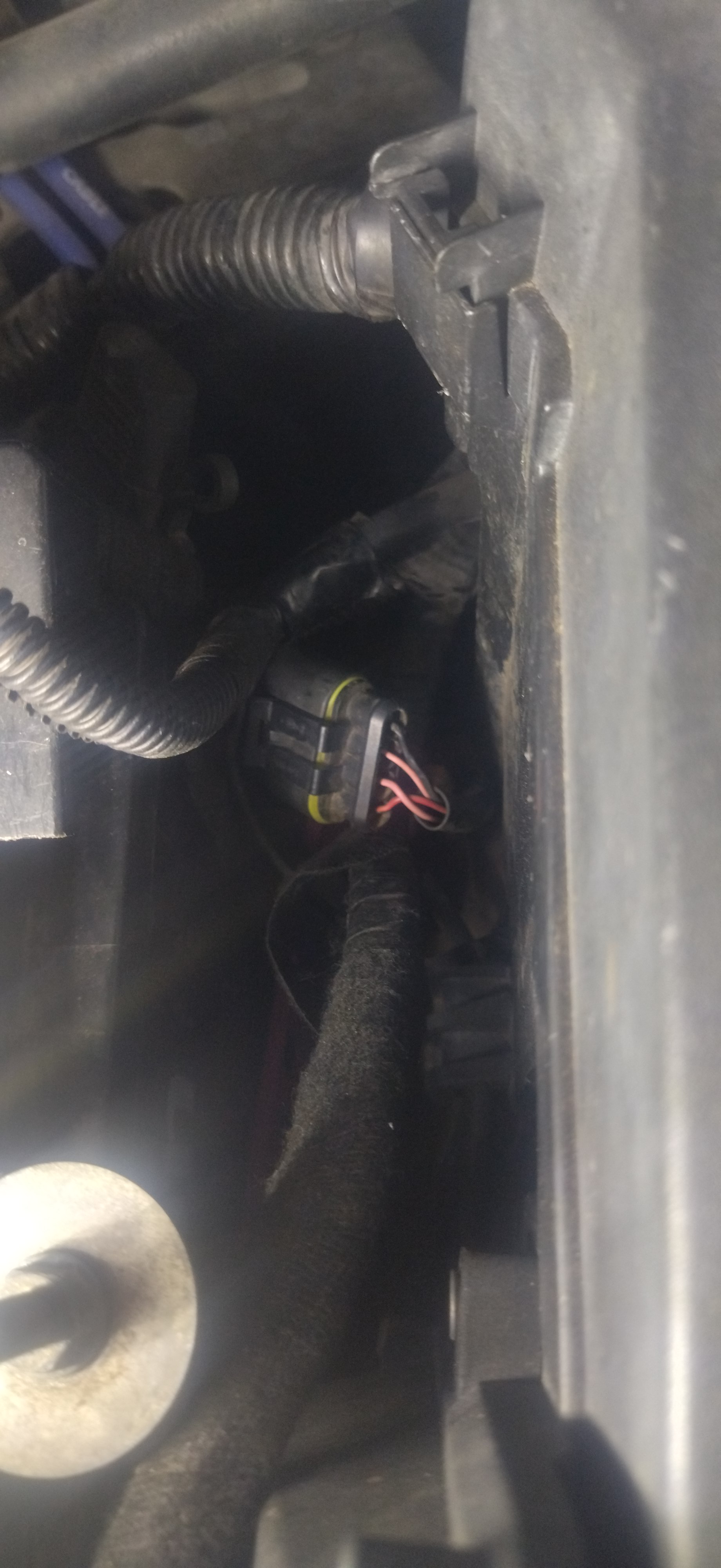

Car started misfiring/shuddering /jerking this week when running, hit the switch to petrol and it runs super smooth. Unfortunately the technician/installer is MIA, so I need to access the interface to see what's happening.
My USB interface cable has x3 wires
USB interface cable with x3 LED indicators on USB side.
The diagnosis cable from the ECU has x4 wires
Port on vehicle
Port on vehicle
I know the port works as the technician/installer used it on numerous occasions, so just wondering WHY I'm not picking up a signal on the programme. I've tried x2 different programmes, and both cannot connect to ECU. Any thoughts or ideas?

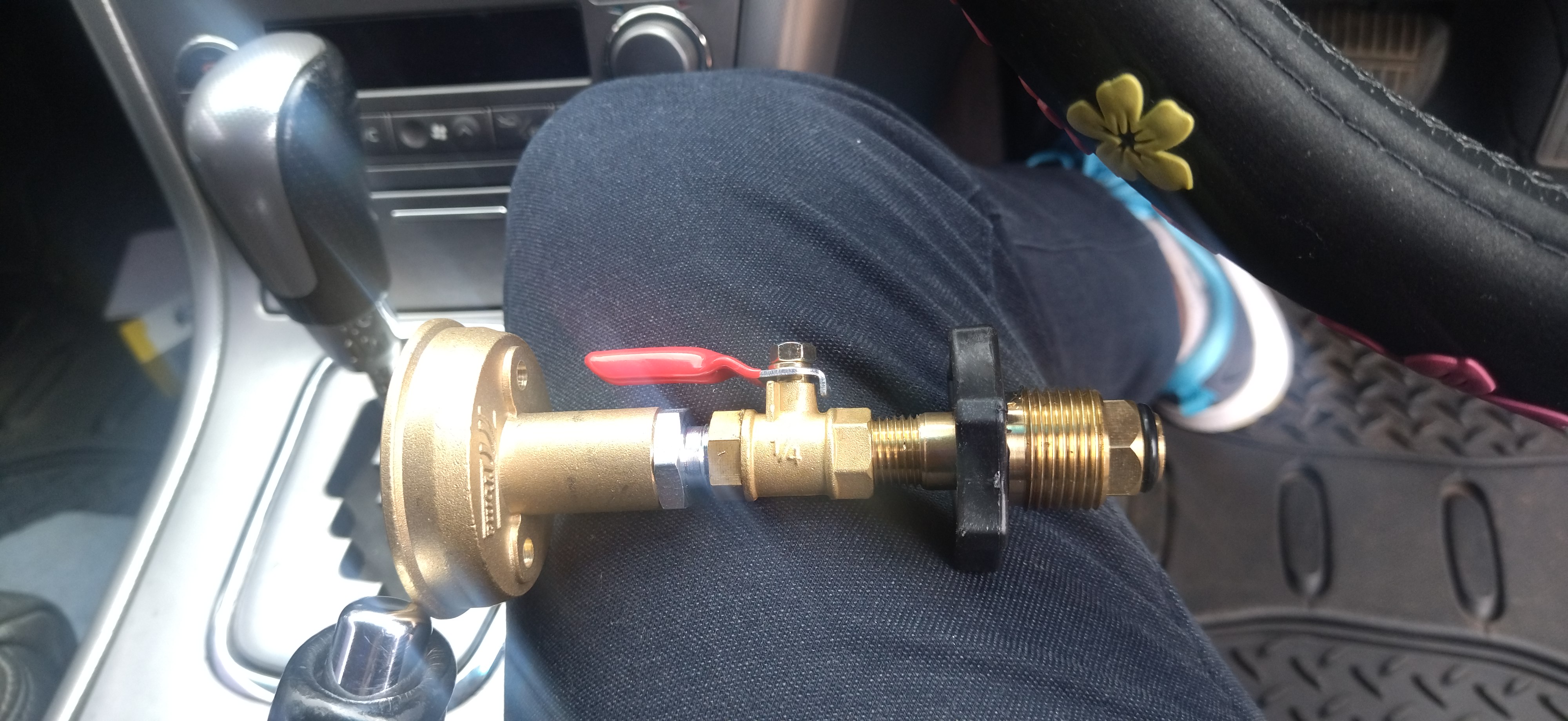

Has been a while since last update. I can say, I've been doing more and more homework to find all sorts of solutions to lengthen my range, discover refueling stations, get an understanding of prices, plan my route so it passes gas stations.
Autogas is cheaper than cooking gas (alas the same thing in South Afrika), and because my current tank extension is through a 9kg or 19kg bottle (depending on my trip), I've made. A plan to be able to fill the cooking gas bottle at the filling station without raising an alarm :lol:
I'm yet to put thread tape on this, so not yet usable. Will test this week.
I think this 👆🏾 is really gonna make my life simpler.
