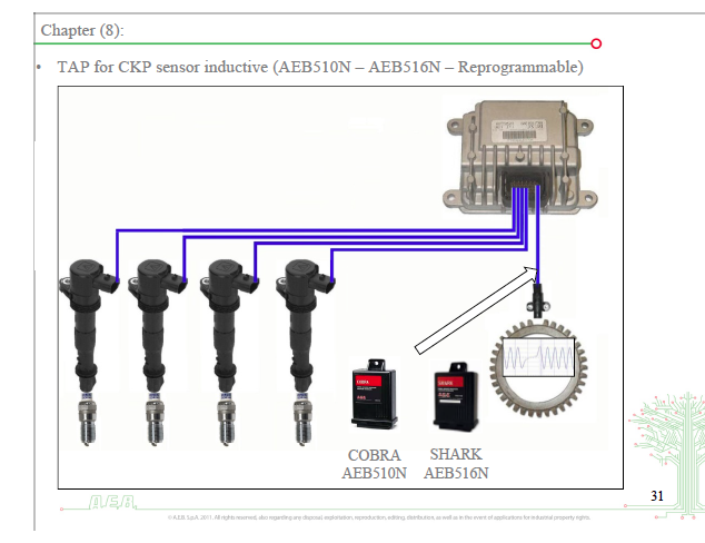

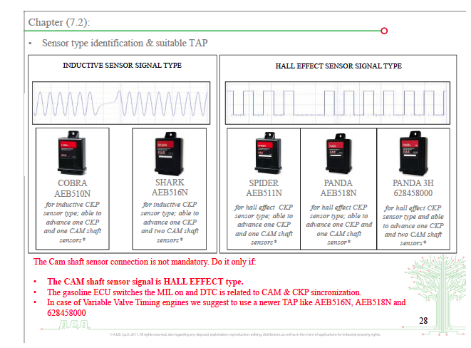

I've found AEB's TAP selection bumpf, and page 25 indicates what I think I'm looking for. I've:
5 x coils … one per cylinder. No dizzy.
1 x camshaft sensor (I believe inductive but is it?)
1 x crankshaft sensor (I believe inductive but is it?)
But without understanding my sensor types I'm at a brick-wall.
I'd put the guide up for all, only forum won't allow PDF format.
Anyone?

Posted: Tue Jul 13, 2021 12:33 pm
Hard to get hold of, but if it's an AEB box we're after i think it comes down to a Cobra or a Shark.

I've not been able to get hold of classicswede and he's not answering email queries re: which TAP etc. hence, I've spent the day researching this, AEB's site is not easy to navigate and what information I can get contradicts. Pretty standard stuff for AEB!
But I think I have it. There's only one TAP available by anyone that'll read an inductive crank-sensor, sans half-effect camshaft, five pots, Denso ME7 etc. And that's a AEB Cobra AEB510N.
Seems the Cobra AEB510N is programmable. I'm not sure if AEB supply the AEB510N with software 'pre-flashed' for this set-up, I think not. Seems to be a 'jack of all trades', has various leads Types A to M? and program versions dependent on application. It requires a Type F lead AEB410-F.
I think we need variant: Software variant AEB510N-08. Best check-in with classicswede Dai, before I buy. I'm still having trouble raising him.
This TAP is not readily available, will need to be brought in from italy. We carry on...
