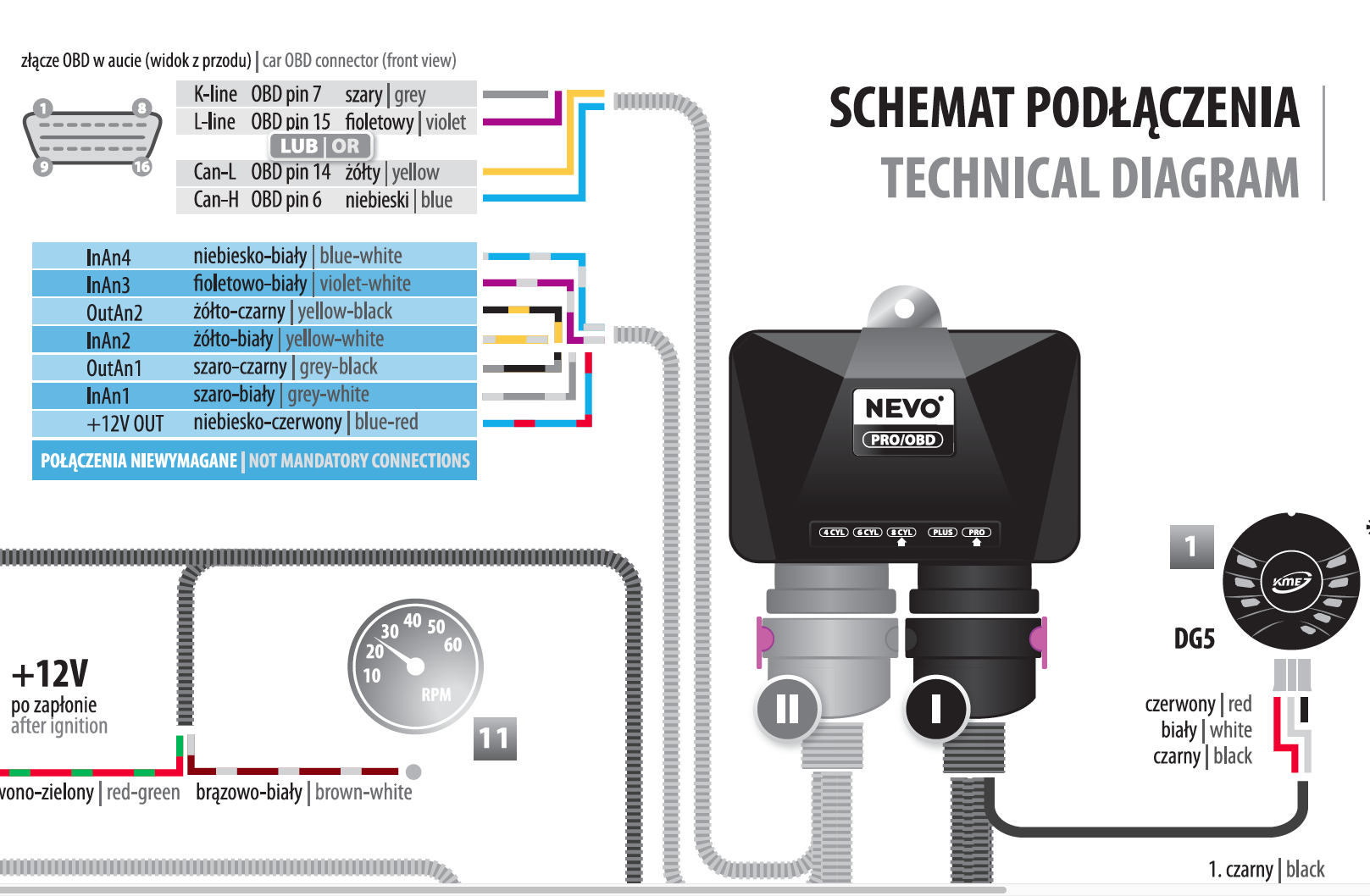

First practical problem. I'm into the OBD wiring. Spoke to Dai, he confirms I read the Nevo schematic correctly, KME would have me tap the K-Line Pin 7 and L-line Pin 15.
Now I looked... Only I've looked long and hard on the back of the Volvo OBD plug, and there's no wire going to the L-Line. Pin 15 is empty. K-line Pin 7 is there. I would think I need the L-line, but with no L-line there, what happens?
I thought I had ISO 9141-2
#68 Post by Gilbertd »
I would suggest forgetting about the OBD connection, leaving then both disconnected and calibrating it manually. OBD2 compliance didn't become mandatory in the EU until 2000 so I suspect your car is too old. It will have OBD to meet the US requirements which were needed from 1996, but not full OBD2.

Ah, thanks... maybe it reads well enough from one line? I'll see what Dai has on this, though he didn't mention it. I've done a bit of homework on this and it appears there's several flavours of OBD ISO 9141-2. Pin 15 is optional. This only leaves the question, does the Nevo ECU know that?

Good enough for me., Dai has it - Pin 15 Line L not required.

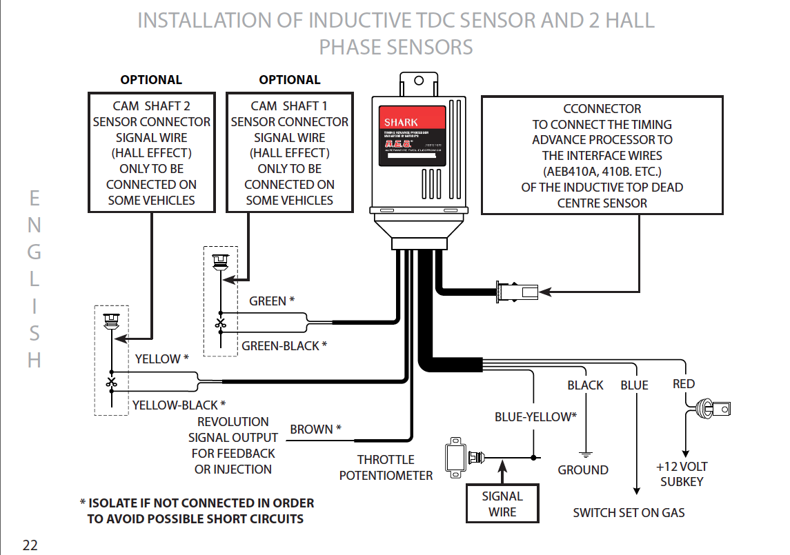

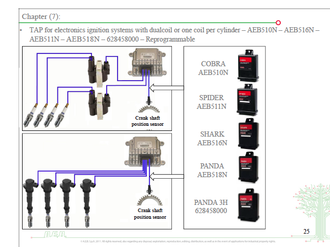

I've found AEB's TAP selection bumpf, and page 25 indicates what I think I'm looking for. I've:
5 x coils … one per cylinder. No dizzy.
1 x camshaft sensor (I believe inductive but is it?)
1 x crankshaft sensor (I believe inductive but is it?)
But without understanding my sensor types I'm at a brick-wall.
I'd put the guide up for all, only forum won't allow PDF format.
Anyone?
TAP Selections 01.png (179.88 KiB) Viewed 4622 times
TAP Selections 02.png (171.97 KiB) Viewed 4622 times
TAP Selections 03.png (160.56 KiB) Viewed 4622 times

Hard to get hold of, but if it's an AEB box we're after i think it comes down to a Cobra or a Shark.

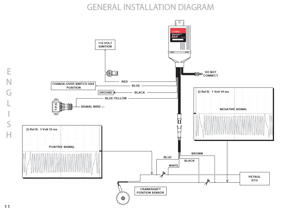

I've not been able to get hold of classicswede and he's not answering email queries re: which TAP etc. hence, I've spent the day researching this, AEB's site is not easy to navigate and what information I can get contradicts. Pretty standard stuff for AEB!
But I think I have it. There's only one TAP available by anyone that'll read an inductive crank-sensor, sans half-effect camshaft, five pots, Denso ME7 etc. And that's a AEB Cobra AEB510N.
Seems the Cobra AEB510N is programmable. I'm not sure if AEB supply the AEB510N with software 'pre-flashed' for this set-up, I think not. Seems to be a 'jack of all trades', has various leads Types A to M? and program versions dependent on application. It requires a Type F lead AEB410-F.
I think we need variant: Software variant AEB510N-08. Best check-in with classicswede Dai, before I buy. I'm still having trouble raising him.
This TAP is not readily available, will need to be brought in from italy. We carry on...
