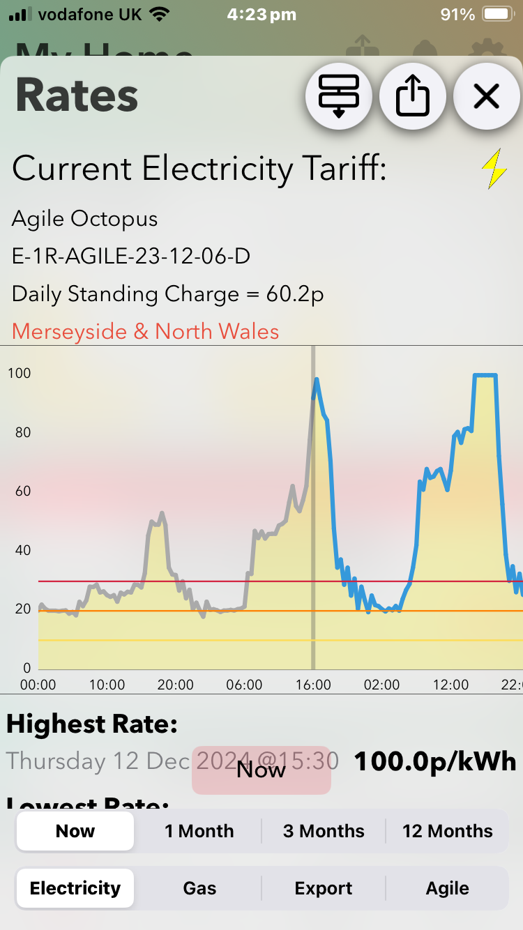

this seems to suggest that simon ..
i am lucky in that my system seems to work ok at 26c -32c radiator water temps , so i am in the upper cop areas .
Re the price per unit , with the agile tarrif there have even been occasions where they pay you to use power ,
however also situations like this ..where theres no solar or wind and the power is v expensive ..
i have just moved to the cosy tarrif while those sort of prices exist , and will go back to the agile in the spring .

Rob, your first image isn't working, I'm not sure what you're referring to where you say 'this seems to suggest that Simon' ?

oh thats weird , i can see it on the forum.... heres a screen shot ..
cosy...

With the Cosy tariff is there a potential problem of paying more than a standard electricity tariff (what 25p?) if you need to buy in electricity to run your heat pump between (say) 4pm and 7pm and electricity is 37.5p and 25.9p between 7pm and 10pm or does the solar and battery cover that or on balance over 24hours/a week/a month does it still work out cheaper?
Edit - We can see your graph now thanks. It does show scop rising for rising external temps and since the radiator temp is a constant in each of the 3 individual sets of data plotted the difference in scop must be either due to external temp or lift temp. The graph also shows a sudden change in scop for external temps between around 1C and 10C depending on which data set we refer to.

"With the Cosy tariff is there a potential problem of paying more than a standard electricity tariff (what 25p?) if you need to buy in electricity to run your heat pump between (say) 4pm and 7pm and electricity is 37.5p and 25.9p between 7pm and 10pm or does the solar and battery cover that or on balance over 24hours/a week/a month does it still work out cheaper?"
so far its working out ok , the battery charges over the 12 pence periods and covers the expensive times , however , i am lowering the heating to 16 in the day , so not yuor typical hs temps.
i will find out in a few days if a whole week works out cheaper , dependson what agile would have been .
