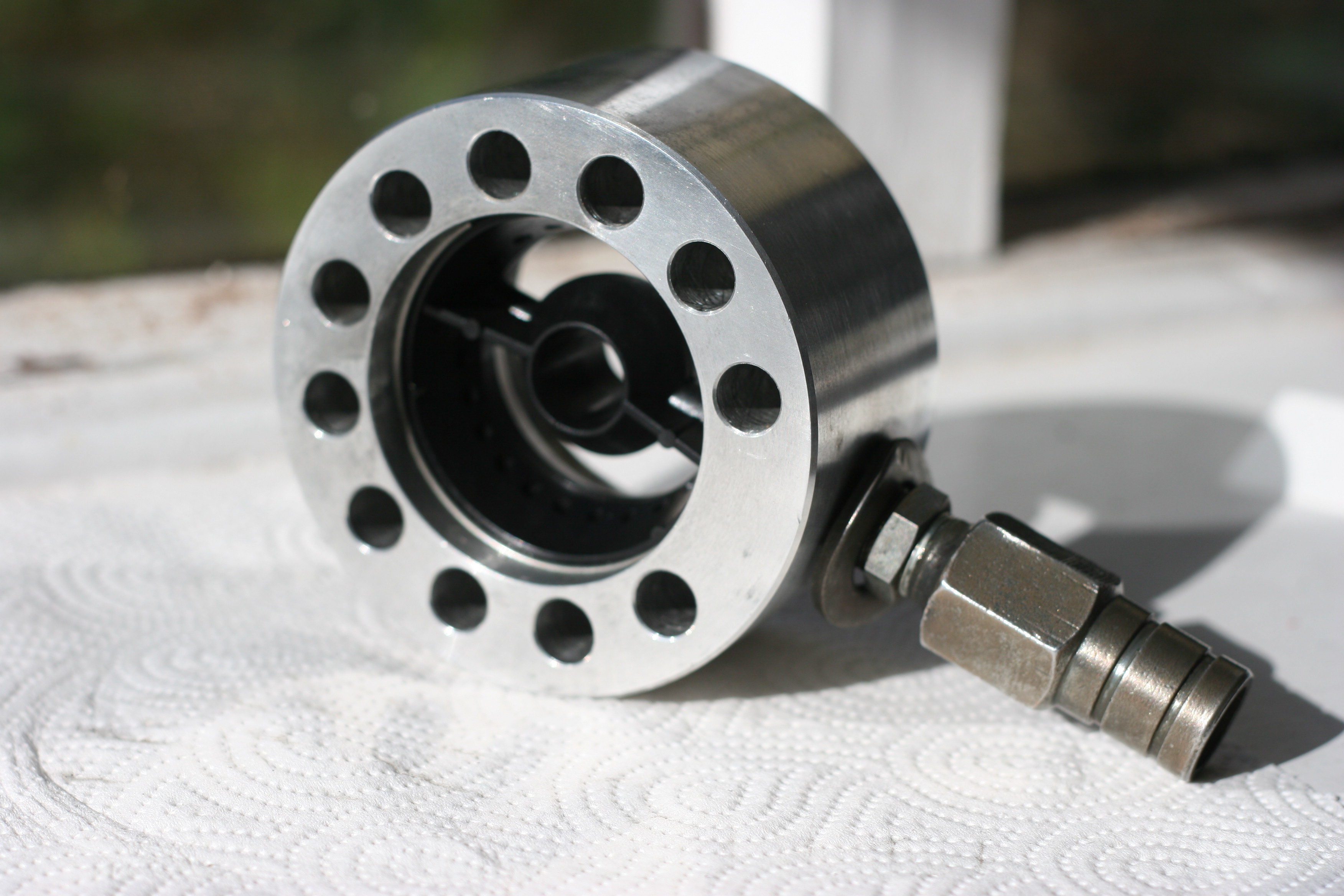

My mixer is as below - but with some of the holes blocked off. I've no real intention to be changing it as it works well enough, but I have another potential application - which I'll come to.

I don't think we're likely to improve the design or mixers by doing Reynolds number calculations or checking turbulence / experimenting with balls on the end of fuse wire...
I think, as already implied, the point of fuel entry on an LPG mixer is going to need more total suck than a petrol carb because we need to suck in more volume of vapour LPG than we do liquid petrol, putting that volume in does in itself reduce the suck at the point of the suck. Perhaps it would be possible to make an LPG mixer that didn't restrict airflow any more than the throttle body or carb it was mounted on, I picture just a tube same diameter or wider than the carb / tb diameter with holes around the inside for venturi effect to suck the gas vapour out of... Maybe this could give rich enough mixture under engine load conditions, but carbs need the idle jet for low load conditions because there isn't enough venturi effect at low airflows to suck fuel out of the main jet and it seems that same problem would be exaggerated with vapour LPG that is (ballpark) 180 times less dense than liquid petrol and for intents and purposes has similar stoch ratio. An LPG mixer doesn't have an idle jet, if we could solve the problem of too lean mixture for an LPG mixer at low airflows / loads then we should more easily be able to get around the need for an idle jet in a petrol carb. Perhaps a hybrid LPG injection / LPG mixer system would work with the mixer system doing most of the main jet fuelling and injection system doing the low load / idle jet function? I would expect pitfalls to include the timing/frequency of pulsed fuel delivery from a single injector would be critical so as not to give any cylinder richer/leaner fuelling than other cylinders but that could be overcome by increasing pulse frequency and fitting a very small nozzle to very small injector(s) or by having 1 injector per cylinder port injection. But if you're going to go this route you might just as well have complete LPG fuel injection instead of the hybrid mixer system.
Does the supercharged 2 stroke still have a reed valve type setup? I don't think I fully grasp the problem you're saying would be with a boost pressure referenced reducer and blow through system.. But you could make it a suck through system (with associated bang inside the supercharger risk I know)?

LPGC wrote: Tue Nov 12, 2024 5:42 pm A lot to think about and a lot to reply to lol.
Agreed, by the time injectors are deployed, be as well let them do everything.
LPGC wrote: Tue Nov 12, 2024 5:42 pm Does the supercharged 2 stroke still have a reed valve type setup? I don't think I fully grasp the problem you're saying would be with a boost pressure referenced reducer and blow through system.. But you could make it a suck through system (with associated bang inside the supercharger risk I know)?
Not supercharged - merely blower fed. A 2T (other than crankcase scavenged) cannot self aspirate. Think of it as an orifice engine with inlet and exhaust ports simultaneously open and a continual flow between the two through the cylinder. Thus configured a mixer placed downstream from a blower would never see vacuum (hence can be placed downstream from a throttle valve). Upstream as you say is a lot easier dealt with - but too dangerous if (and it is only an if) an intercooler was employed.
Only crankcase scavenged engines use reeds so no need for them in externally (blower) scavenged motors as the piston will close the transfer ports (which the blower directly feeds).
2T engines despite being simpler mechanically than 4T are a lot more complex in operation. Suck, squeeze, bang, blow - or wheeze, squeeze, please, wheeze - describes 4t. Try explaining a 2T in such simple terms!

I know the basics of how 2 strokes work lol, like you say though the process is more difficult to grasp or explain than 4T, the exhaust and intake kind of happen simultaneously. Could have 2 x 2T engines, both the same size / bore / stroke, both from the same manufacturer, but the porting can make a massive difference to all of torque, bhp and fuel economy (in different measures). Dad used to have a theory about 2T boat outboard engines that an engine with the biggest capacity to bhp ratio (specific power output) would generally be more low rpm torquey and run smoother than one with a higher specific output. At the time you could buy a 70hp or 85hp engine, they'd be the same engine except for a seemingly minor porting difference but the 70 would usually be a 'nicer' engine with a flatter torque curve and use less fuel even at port throttle than the 85.
Know a bit about superchargers too, the old numbering system for Roots type blowers on diesel / loco engines etc.
I don't see much of a distinction between supercharger and blower, unless by blower you mean a setup that gives little boost pressure but delivers the volume of air to the intake port on the 2T? Just something to do away with the need for crank scavenging and maybe reed valves? Different on the diesel 2T's, in theory a blower/supercharger is more beneficial to a direct injection 2T diesel than to a 2T carb petrol? In fact a direct injection supercharged 2T diesel (like some loco engines) is in many ways easier to understand than a conventional 2T petrol.
If it's not compressing air an intercooler wouldn't be fitted anyway? Still is possible better blow through than draw through to prevent having explosive gas and air mixture inside the blower?
Where is the throttle on this 2T blowered petrol engine? I still don't completely follow why you couldn't use a mixer between the blower and the intake port with the reducer referenced to pressure just before the mixer. I could see that working perhaps with a need to lengthen the intake to limit backpressure pulses from the intake port going back/forth through the mixer.
