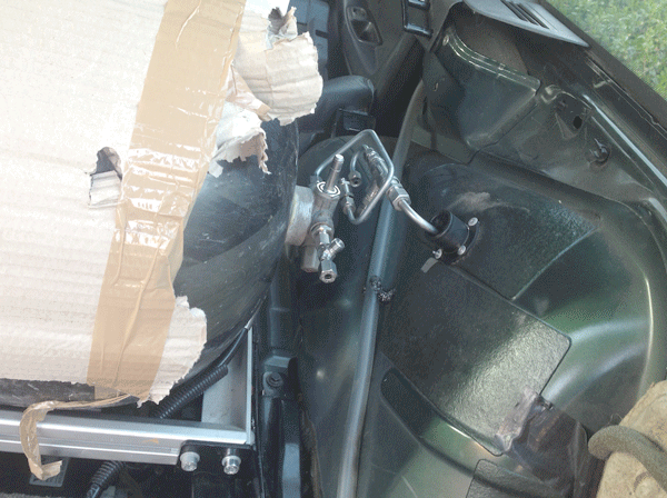

Now I'm going to explain why for the likes of me anyway, an NG install is so much about the plumbing. These P80 cars had their factory-tank sited behind the rear passenger seat, later P2 under the seat. So far what you see gets pretty simple, in copper you'd do that lot in a lazy hour, in stainless it gets worse. And I've got to replace all the now long-gone, factory pipe-runs.
You're looking at a section of stainless coming from the fill-cap entering the double-skin of the rear inner-wing via that factory-fit black-plastic vent. The cardboard is there 'cos fibre-glass composite tanks are nasty - like a day with loft-insulation. LPG lets you mince about, waving a bit of copper. You make it off one end, and poke it thru'. Copper allows such runs, in-situ, on the car. Not so fast, stainless. You've got to do those bends off the car.
Because of the double-skin around the filler, it's a Volvo remember, the complex-curve required is blind and has restrictive access and sight-lines. Doing that blind, getting stainless to 'land' dead-centre to that black-plastic vent took time. When you blind-work this as well, mocking-up with welding-rods for a template, took me three goes. If you've ever had to create complex-curves for say an exhaust system, you'll grasp what I'm on about. One bend is fine, once you're at two and three, where the pipe 'lands' becomes an art in itself. If you get the third bend wrong, the previous two become scrap. And you can't 'offer it up', after the second bend, because it won't wiggle in to fit. I'm surprised I did it in three.
OK, the stress-loop you see, was a 'piece of the proverbial'. Easy, because a check-valve has to be in there somewhere, so I chose to place it mid-loop - no reason to make a section of pipe with four curves to get wrong, when you bend-up as two, and give yourself some 'wiggle', check-valve in the middle? Thus the check-valve becomes a swivel-fitting too. But it's still time-consuming.
The frightening one is yet to come. That long run that has to land on the tank-valve at one end, and go vertical up the bulkhead, orientate at right angles, and land on the reducer at the other, is a daunting prospect. In copper you'd just flounce about the workshop, and 'Whoopsie' it in.
I've got to do that off the car. Volvo must have produced the original on a former and then all that would be required is to snake it in. Me? I weep, rather than a few fittings added each end to make off to LPG, the previous bodge ripped that beautiful piece of stainless out. And fired-in lash-up copper. It needs to be done again, and in one section of pipe for best practice. OK, I've done similar before...but I don't know if I'm that good.

Branded Atiker, pix of the first CNG Gauge I've ever found declared as 90 Ohm. As is tradition, the Atiker web site keeps the output blind, thus how the seller warrants these as 90 Ohm, is not clear. But there it is. Cheap too.
