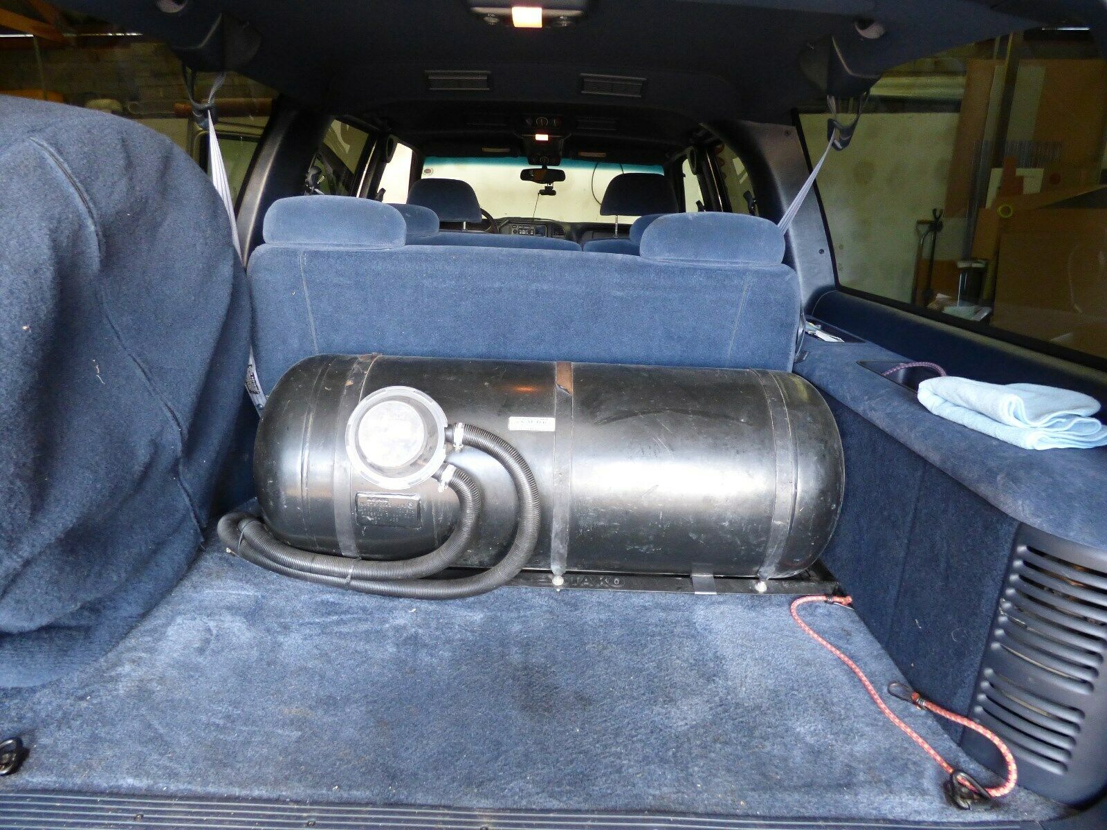

Pic of my tank below.

Lean mixture will cause inlet backfires and I would have said it could have been caused by hard cornering left uncovering the pickup in the tank. But that would only happen if you were getting very low not just after filling up.

If you had nearly a full tank when the backfire occured it's unlikely fuel slosh during cornering caused the problems.. with a full tank there wouldn't be enough headroom in the tank for fuel slosh to uncover the pickup pipe.
