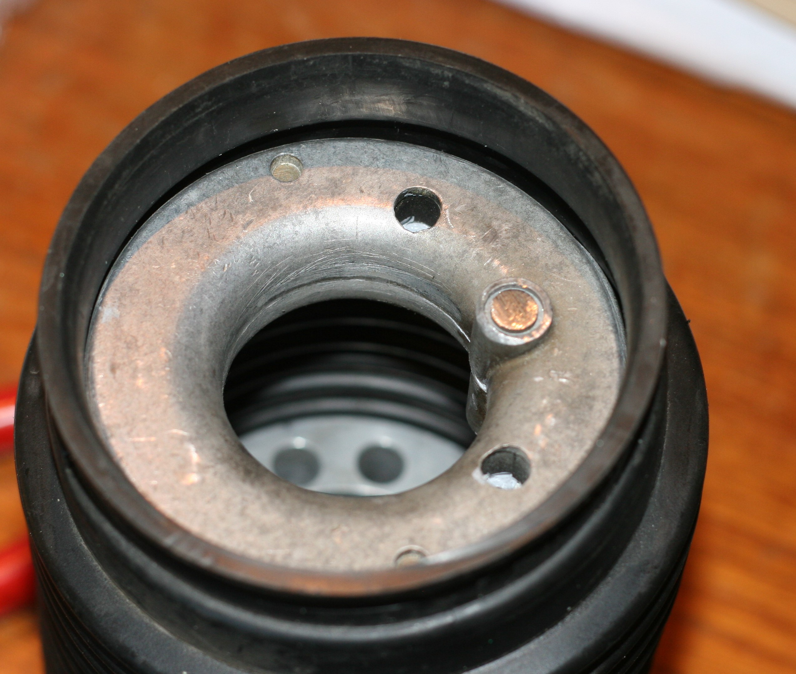

260hp requires 33% more air than for 195hp. The duct I'm fitting my mixer into is 90mm ID and the throttle body is 72mm.
I need/want to better understand the gas dynamics that were present today. Clearly, my assumption that the air would recover (ie reduce in velocity and regain its pressure) after passing through the first mixer and before presenting at the second was wrong. What I created was an overall vacuum either side of the downstream mixer in addition to that created by its venturi effect - possibly greater than it's venturi effect (in essence, it was the equivalent of a good old fashioned choke). I have to ascertain if that prevails over the entire operating range and if it's even desirable. There's very possibly an element of what LPGC has eluded to re one mixer being hungrier than the other. If so, it was given ample opportunity today to make its presence known as each mixer was being fed directly from the reducer without any shared plumbing. I just need to rethink after what I've learned today and work out what next. Gas flow is a mechanical issue - governed by physics. A mechanical solution is required. I already have one in mind and it's simpler that dual mixers.

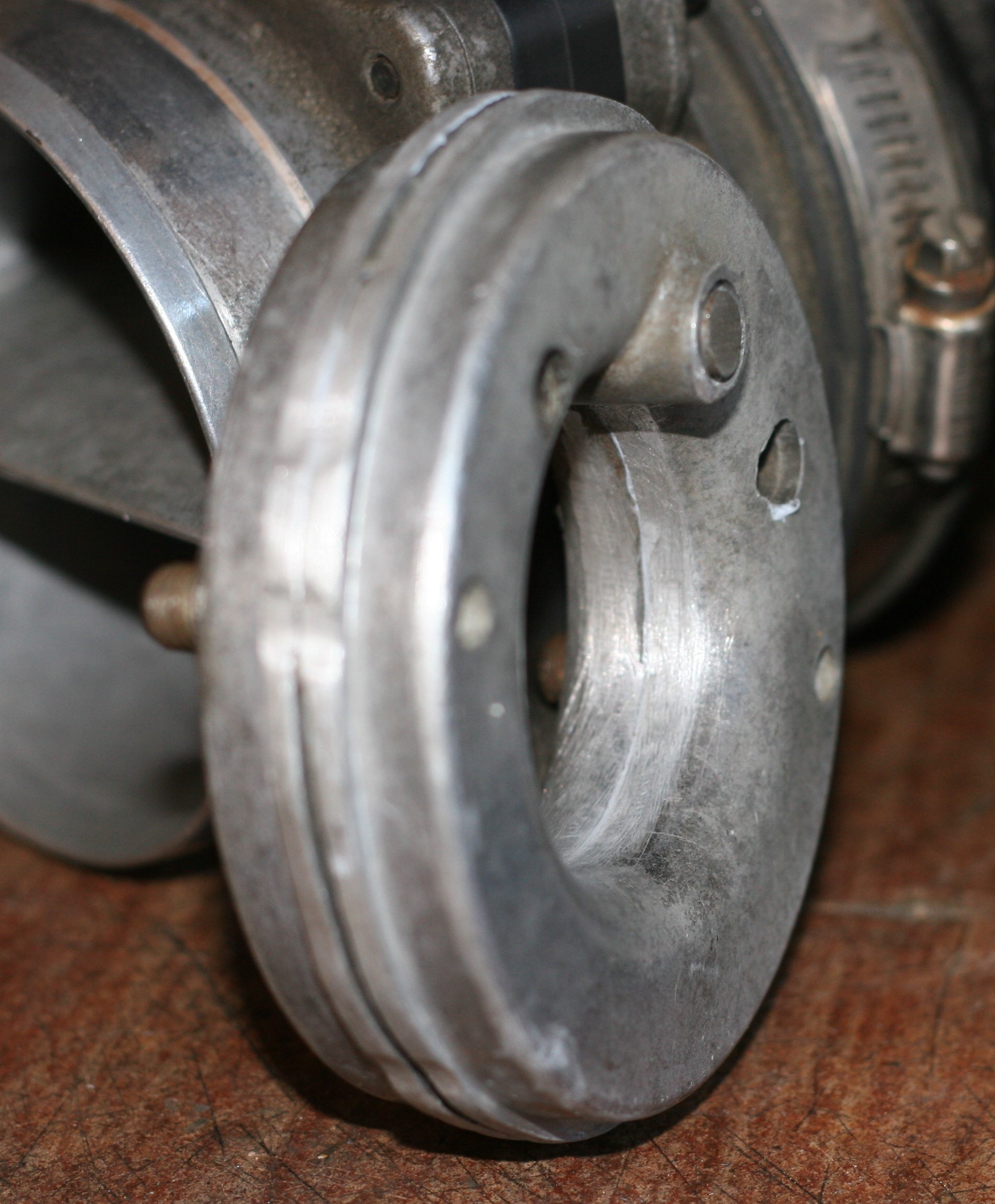

Given the mere placing of that 45mm ID mixer upstream of my current mixer permitted freeing up its area, I'm looking to deploy an upstream venturi to get through the just out of idle 'hole' while minimising the turbulence. The pressure drop of an upstream restriction (even though its ID is bigger than the feed mixer) obviously presents as a pressure drop at the mixer. But it will I think in its effect be more linear (not related to velocity squared) than the core of a venturi. The pressure drop is a consequence of that process - the friction having robbed the air of internal energy.
How restrictive this is re top end power remains to be seen but if at higher airflows the mixer steps up, then the upstream restriction can possibly be stood down. Did you ever notice that the choke plates on twin choke Webers fitted to some Fords were not symmetrical either side of their pivot shaft but could be pulled open when airflow requirements demanded?

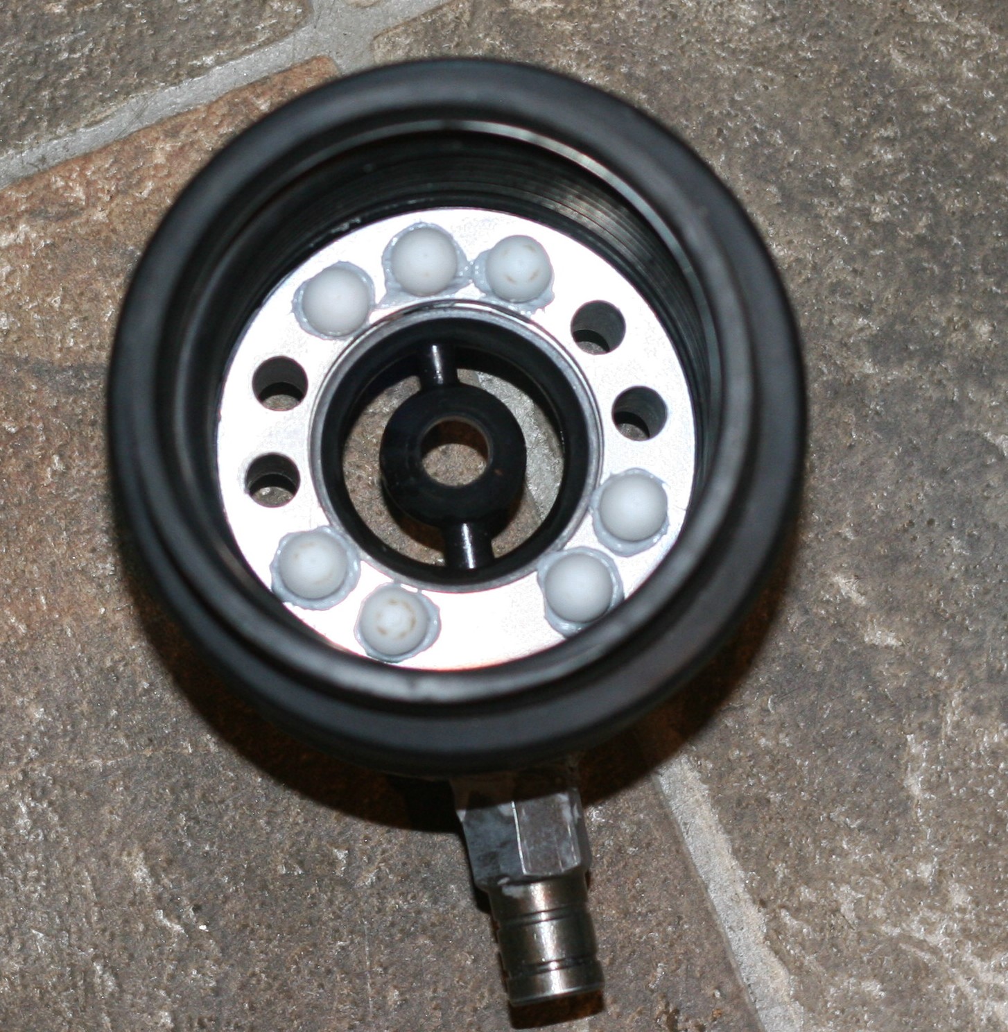

Tried an upstream restrictor (45mm ID) with 7 of the mixer holes and it was chronically lean. At no load 3000rpm it looks like it should work (actuator at 1600. Drive it and the actuator goes fully open, it's first box green lean and that's just in the second TPS box.
Back to 7 blocked, 4 open holes on the mixer and I think that's it - for now at least.
