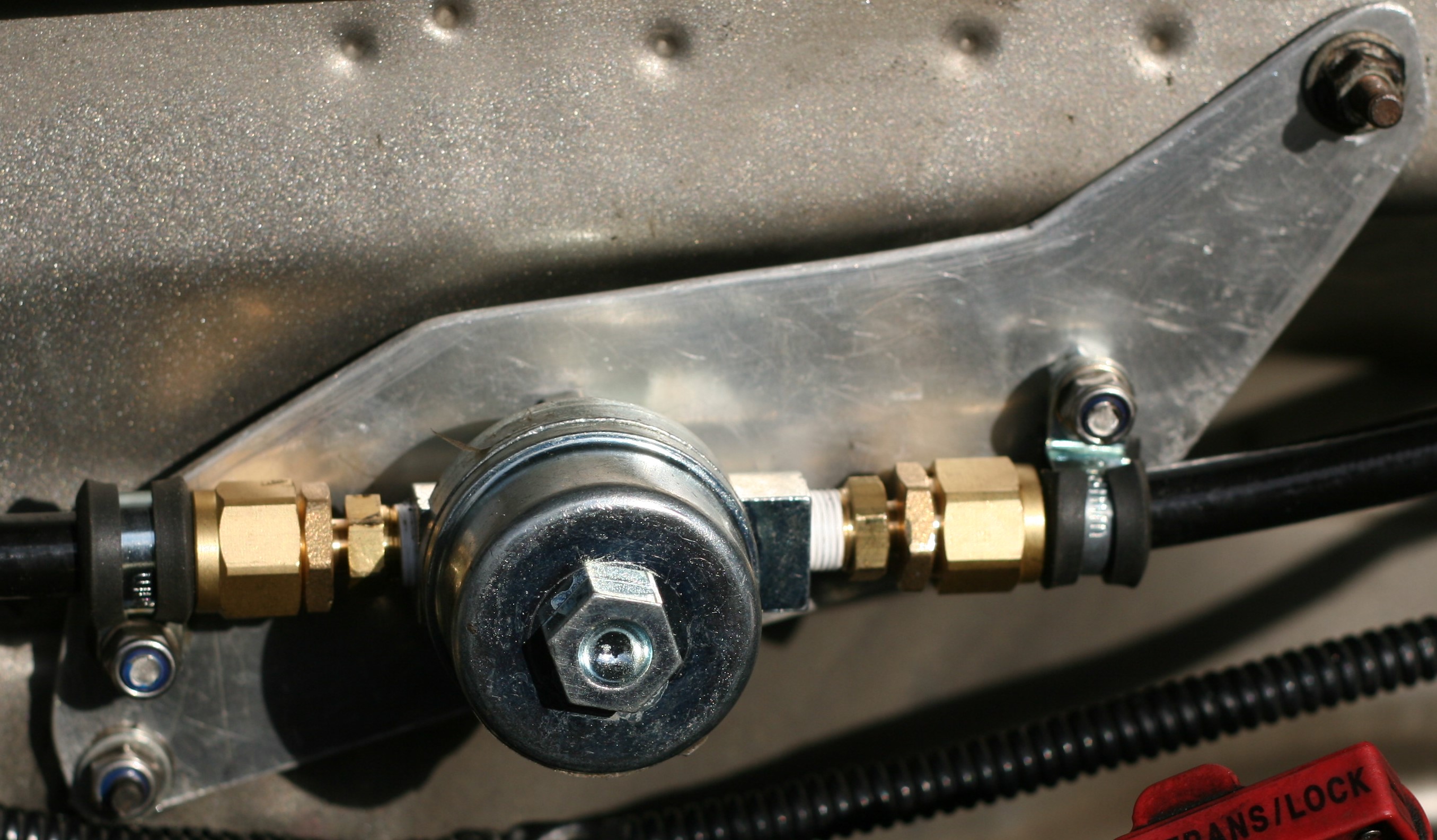

Wasn't entirely confident that the fittings were tight enough so dropped the pressure off the line (left the engine idling - cheers Brian-H) and had another look at things.
Tightened all the fittings to an inch of their lives and the two 8mm ones in and out of the filter I 'tethered' by fitting a clip right behind the polypipe gland and bolted to the filter mounting bracket. My thinking is that if the brass fitting does escape the olive then it isn't completely free to dump liquid LPG at tank pressure on top of the distributor with the engine still turning and hence the tank valve still open.
With 'brass emulating copper', are steel olives better? Among the olives TT supplied there are two steel ones (6mm) and I thought about using them at the tank and reducer where it's still 6mm. But wondered if the extra force to crush steel compared to brass wasn't self defeating. Any thoughts on this? As it was, at the tank, the brass olive was showing signs of 'digging in' so I left it there and tightened the ferrule as much as I dared.
Anyway, happier with the set up now than before and leak tested and zero leaks.
- IMG_4920 (2).JPG (669.08 KiB) Viewed 19614 times
- IMG_4919 (2).JPG (479.17 KiB) Viewed 19614 times

And, one more tether! That's all three fittings in the engine bay done and worth it for the peace of mind. You've spotted that one of my preferred hand tools is a roll of 40# grit!

That bracket doesn't look as pretty as the other one......

It was the other one - before it became repurposed. And it was something else prior to that!
