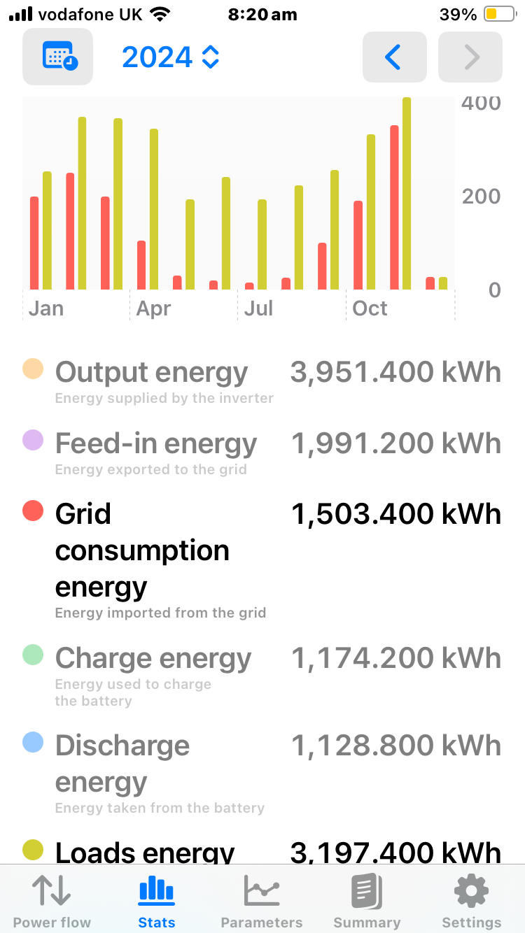

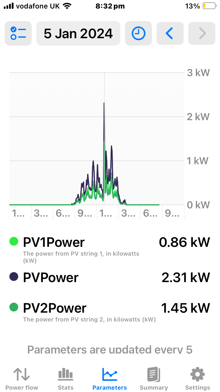

winter solar output from 6kw of panels gilbert .
two rows of panels ,green lines , totalling to the black line ..
and since january, although solar income only started in june ..

If the graphs show time versus kw output and figures are peak values between 7am > 3pm is there anything to show total panels kwh output for 5th and 6th Jan 2024?
I'd guess around 0.7kw over 8 hours on 5th Jan = 5.6kwh, 1.1kw over 8 hours = 8.8kwh on the 6th?

here you go simon , every day for january ..

Figures look closer to 5 and 6kwh for the 5th and 6th Jan respectively then.

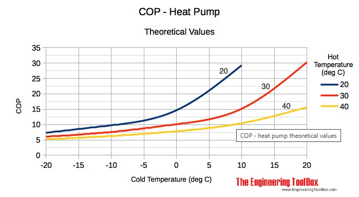

The graph below is something I just pasted from the internet, I don't know how accurate this is for actual heat pumps but it shows cop changing for given input and output temperatures. I say cop isn't linear for input temp because the graph curves upwards for increasing input temp and there is a stark upward turn for external temps at around 0C. Which is why I say in (4) that increasing evaporator input temp by a little can lead to an increase in cop that more than compensates for the energy we put into heating the evaporator in cold conditions (scop is specific cop, at specific temperatures). But if we would usually (without the gas / engine heating the evaporator) increase the evaporator in cold conditions using electrical hot wire energy, since gas heat energy is 1/3rd the price of electrical hot wire heat we'd save money effectively using the gas to heat the evaporator instead of electricity.
heat pump cop vs temperature example graph.jpg (64.15 KiB) Viewed 3983 times

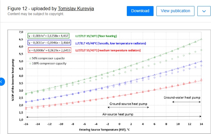

I didn't pick and choose the graph above, it was the first that a Google search returned. Edit, the second graph that Google returned is below, it suggests that heat pump cop doesn't reach 300% until external temp is as high as around 12degC, which to my mind with gas price being 1/3rd electricity price means if we would be paying for electricity from the grid to run a heat pump the heat pump would cost more to heat a house than a gas boiler if external temp is below 12degC. Don't know what other people do but we don't even turn the heating on for around 6 months of the year, which means we run heating for around 6 months, and during around half of those 6 months so 3 months daylight hours are very limited (so solar panels probably not much help with heating bills if running a heat pump) and external temps are likely to be consistently below 12C. The graph below is also curved, every one I've seen is curved. The problem with the rising rate of efficiency versus input temp is that when the heat pumps would be most efficient is when we least need to use them and when they are least efficient is when we most need to use them, the curve in efficiency versus temperature exaggerates that aspect/problem. Some heat pump setups do have hotwire electric heaters that heat the evaporator to shove up the scop and the output temperature, it would be more economical to heat the evaporator by burning gas than to use electric hotwire since the hotwire always has cop of 1, close to gas cop which without condensing feature is slightly below 1 but still very close to 1, condensing pushes gas cop even closer to 1, but gas is 1/3rd price of grid electricity by kwh so if cop for electricity and cop for gas are both 1 gas is 1/3rd price of electricity. My suggestion of heat pump on engine exhaust seeing low final exhaust temp would see water in exhaust gas condense.
Researchgate heat pump scop graph.jpg (92.94 KiB) Viewed 3969 times
