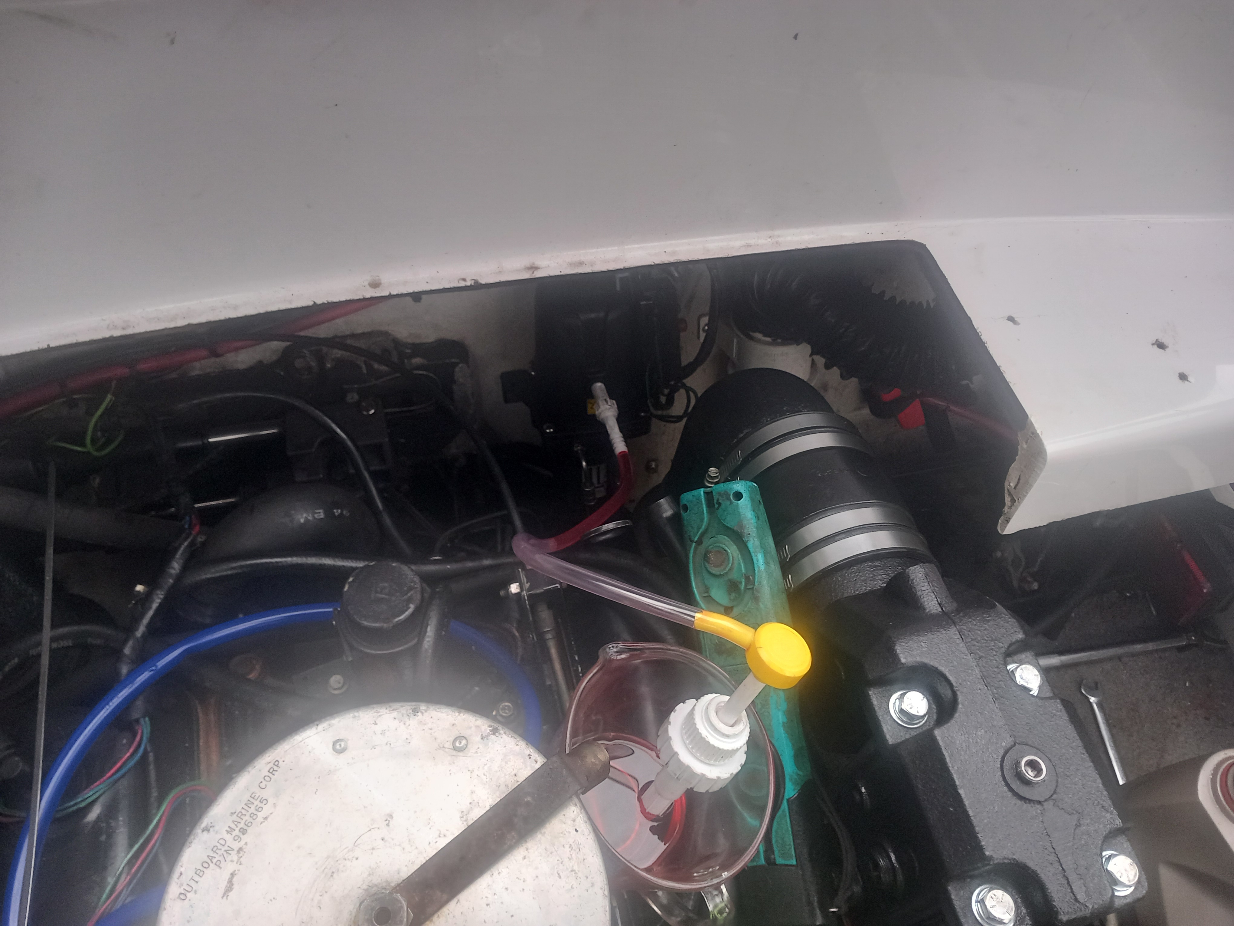

I used a little pump that has attachments that screw into the drain hole, can't remember where I got it from (could be Repower) but it was cheap and has attachments that fit OMC, Mercrusier and others. In the past I've just used a best fit hose with an oldskool hypoid squeegy bottle, it wastes some that leaks past the pipe but if you put it in fast enough you don't lose much from leaking (but still messy). The pump is the best option,the attachments also fit the trim pump fill/vent hole threads so it's handy for things besides just filling the drive, I'm using mine at the moment to refill the trim pump. Also very handy for filling vehicle diffs and gearboxes in future...
There are loads of websites with diagrams showing locations on things like trim anodes etc, such as https://www.crowleymarine.com/
Edit - In the pic below I'm using the little pump to refil the tilt/trim pump which has the same thread as the drive leg drain plug hole.
Had to remove the pump again... The motor ran but the leg didn't move. Then I wondered if it was because I disconnected everything with the rams in the down position (supposed to do it in the up position at least ideally) but when I disconnected the lines from the pump and there was no sign of any fluid in the lines I knew there must be something wrong. Tried running the pump both ways with the lines disconnected, still nothing came out of the pump line holes. Removed it, removed the motor, don't know if I fixed it by pushing some check valves (ball bearings accessible from the motor side) to loet some fluid past to prime it, or if I had the motor to pump 'adapter' (I mentioned last post) in the wrong drive gear slot. But made sure I put it back together with the adpater in the correct gear slot and that it didn't fall out of position when I fitted the motor, then tried it on a battery before refitting it on the boat. Knew it was going to work to at least push fluid both ways when fluid squirted out of each hole in turn (opposite battery polarity). Refitted it and it worked straight away. Have left it with the leg half way up (at a measured height) in around the same height from where it fell under it's own weight before the pump rebuild so I can see if it drops overnight (before Morat arrives in the morning).

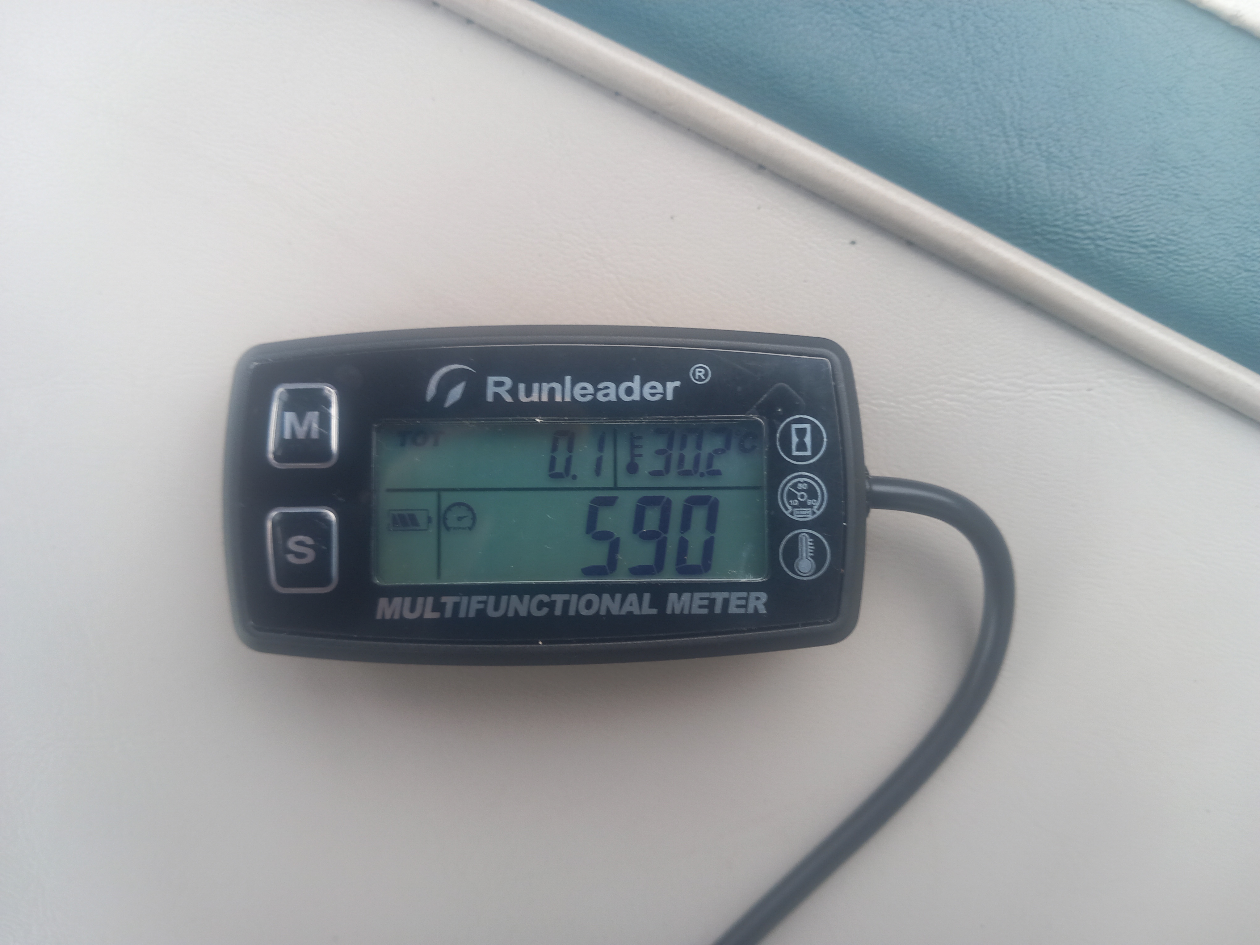

Another thing I tried today was the Amazon combined digital revcounter / temp gauge / hour meter/ warning indicator.
Has it's own watch battery, connects to the coil with a single wire (yellow wire in the pic I just temporarily removed insulation from its end and curled around the coil connector), the ring connector is its temperature sensor which can easily be attached to anything. It comes with adhesive strips and screws etc so you can fit the temp sensor and the unit itself to anything. Very handy for a digitally accurate tacho and for accurate temp measurements... The standard dash gauge shows engine temp and there's usually an overheat warning beeper but they won't tell you if the exhaust is overheating soon after starting a cold engine like this units sensor could. Programmable to give rpm reading on engines with any number of cylinders (believe it can work inductive too) and flash/beep at settable over temp / over rev conditions.
Confirmed my thoughts that the dash tacho is reading exactly double rpm. I will be fitting this on the dash (but will have to extend the wiring) and fit the temp sensor onto one of the metal sections of exhaust downpipes that contains an exhaust flapper. Might even buy/fit a second one to the other side exhaust and if I do would connect that to show RPM too. The engine is still filled with water when its switched off but it might take the engine a minute of running for the temp gauge to start moving, any rubber in the exhausts could be cooked a long time before the engine started to overheat.

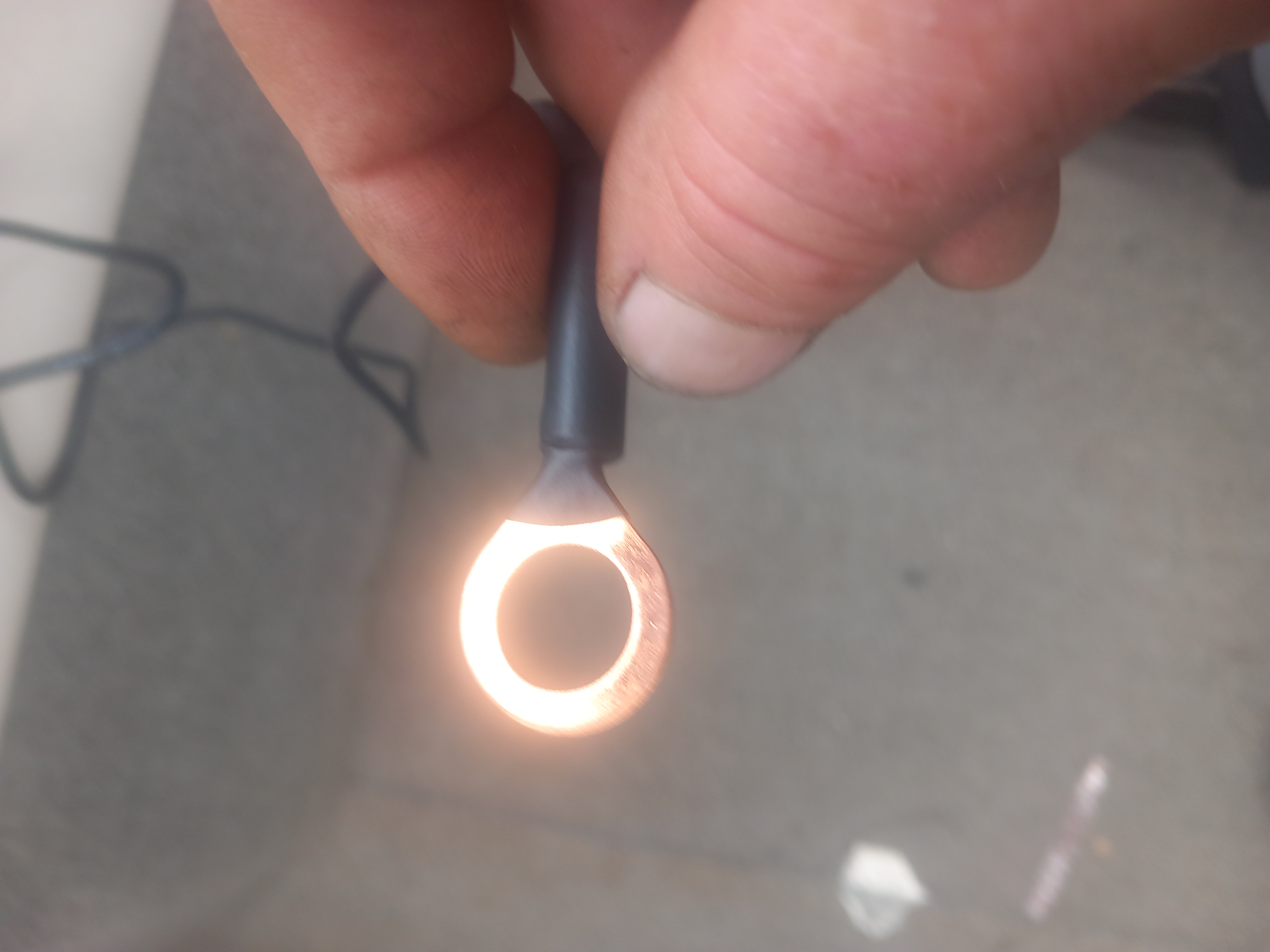

Found the problem with the bilge blowers (and bilge pump too). Power getting to them but no ground. The wiring to them both has been played with and although the grounds were connected to each other, they weren't actually connected to ground anywhere..... Even put some water from a hosepipe into the bilge to confirm that the bilge pump actually works too.
Adjusted up the throttle cable as it wasn't shutting off fully when the remote was returned to centre and then turned my attention to the shift cables again. Although I've now adjusted them up 3 times, the shift cutout was still operating in both forward and reverse and the cable feels stiff. Problem here is that I have no idea how stiff it should feel. Its moving a few bits of metal around so there will be some resistance but how much is too much? The run looked like it could be a bit smoother too but the manual doesn't show how it should run, just how to adjust it. Found a Youtube video on how to change the cable but that didn't help as they suggest using the old one to guide the new one into place. Finally found a picture of how it should run, had a look at it and it doesn't run that way..... Access to it is a real pain so, in the hope that it will give me enough room to get in there, I'm in the process of removing the RH exhaust manifold again. I say in the process as I got 4 of the 6 bolts out and the heavens opened, so everything was covered up and I'll carry on in the morning. Worst case I'll need a new cable and that is proving to be a bit of a minefield too. I found one part number of a spares listing and a different one on Repower Marine's site but when I find an eBay seller listing the one that Repower suggest, they give a list of alternative numbers and the original one isn't one of them.....

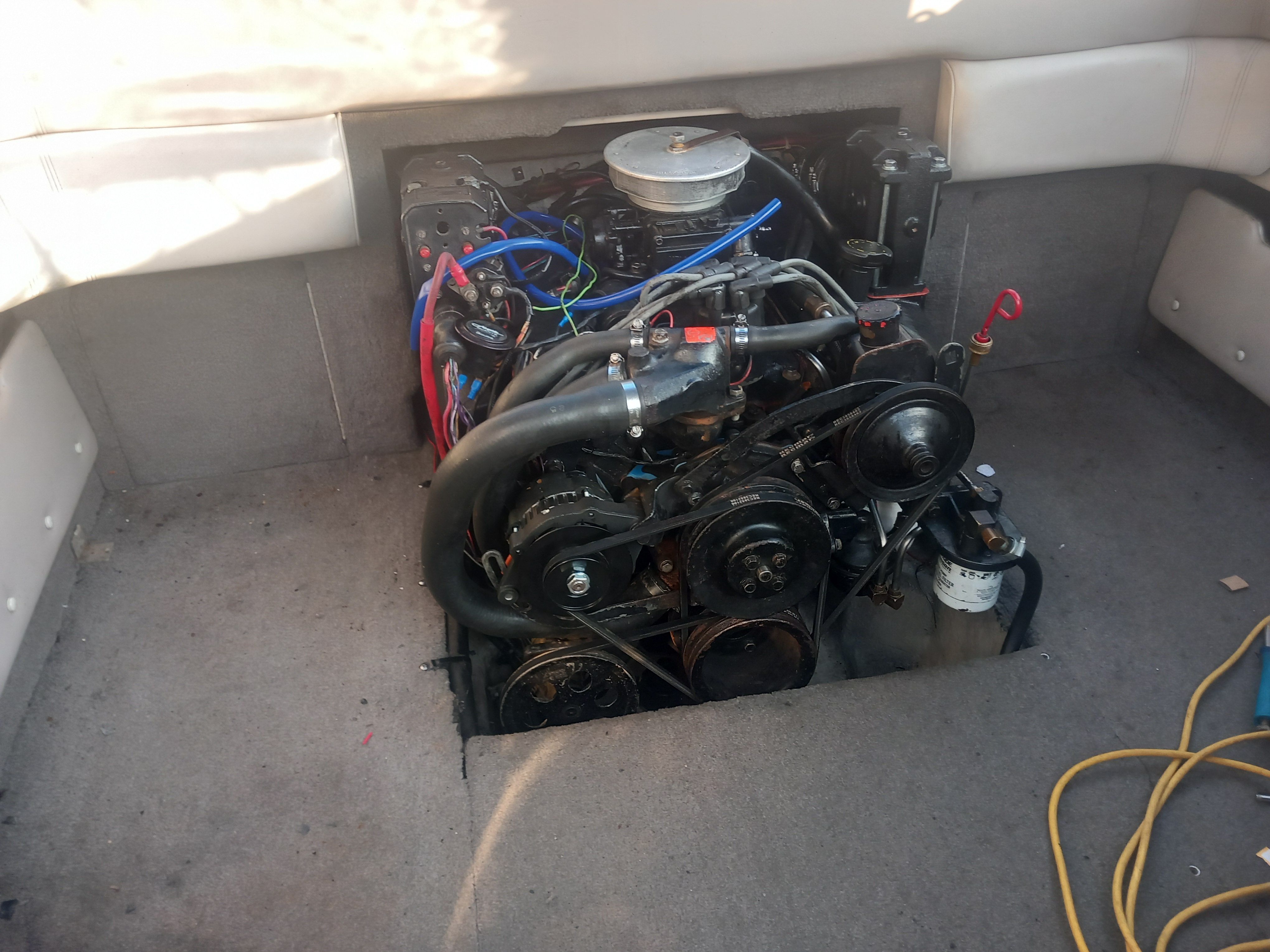

I'm getting familiar with my OMC / Volvo Penta colaboration 'OMC Cobra' setup but Mercruiser will be different and there's no sparks interruptor on mine.
I refitted my main earths differently to how they were originally fitted, I put them all on the same easily accessible bellhousing to block bolt.. separate earth for each of the 2 batteries, 1 or 2 for the inside transom mount stuff (and they also have little stainless wire straps running between e.g. the steering pivot and other transom stuff), there's only one main earth for most of the ancillaries type stuff so my blower, bilge pump, all the dash switched stuff including the ignition is earthed through that. I think they make them this way to make lifting the engine a bit simpler and **more consistent across boat models that use the same engine**, can basically just disconnect a multiplug connector a bit like a tow hitch wiring connector on the front of the engine, disconnect earths at the back, disconnect lives from the starter motor and the engine will come out when its been unbolted without having to worry much about extra wires etc bolted to the back.
**If there's a marine engine model on your engine you could maybe look up a diagram and see how its normally wired and how the shift cable etc is supposed to be routed. There might be a common routing for the model regardless of what boat it's fitted in (obviously not for how it routes up to the helm but how it routes around the engine bay stuff). But these are the kinds of things discussed on the iboats forum and I've seen threads about setting up the shift interruptor.
