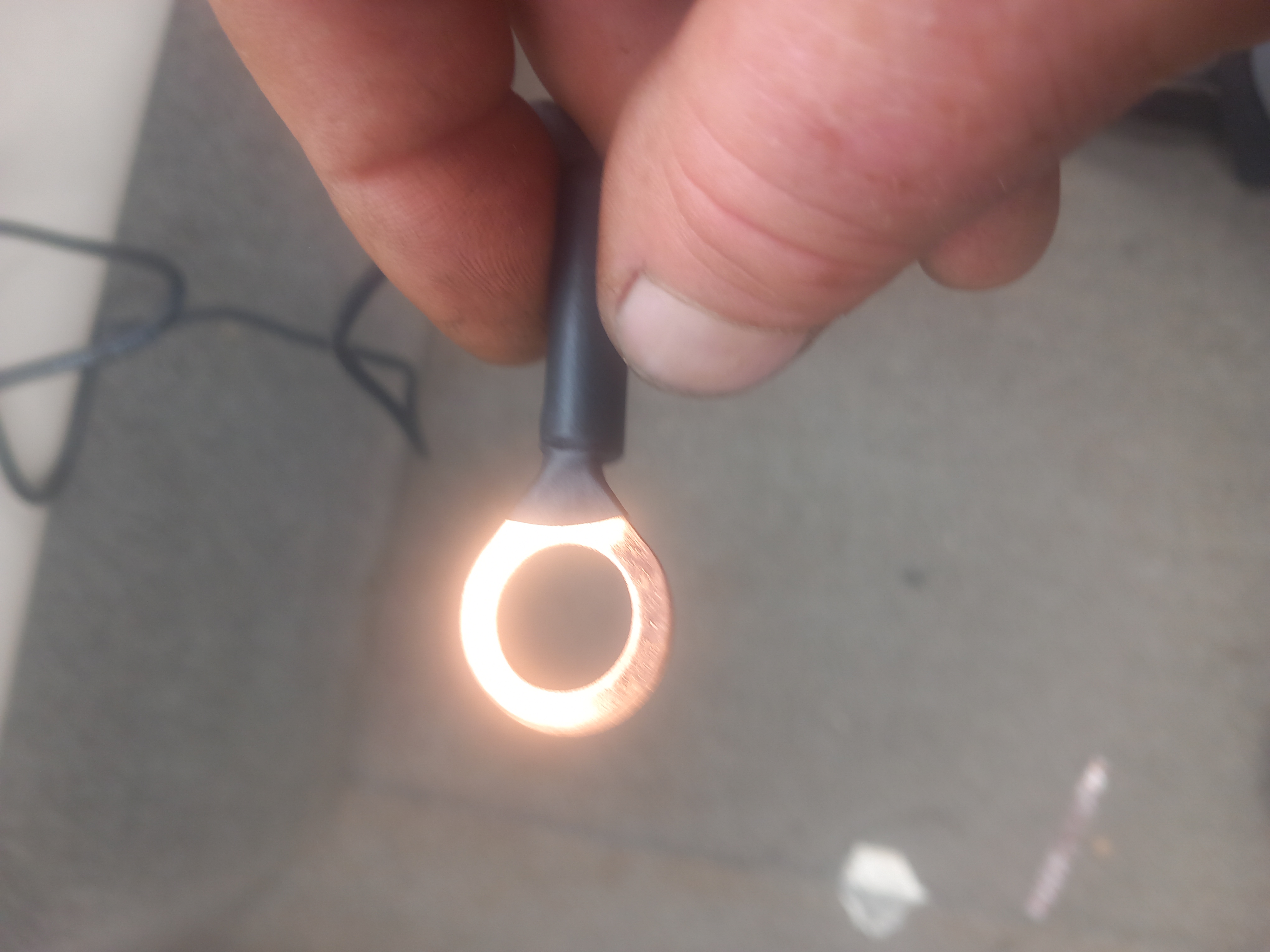

Another thing I tried today was the Amazon combined digital revcounter / temp gauge / hour meter/ warning indicator.
Has it's own watch battery, connects to the coil with a single wire (yellow wire in the pic I just temporarily removed insulation from its end and curled around the coil connector), the ring connector is its temperature sensor which can easily be attached to anything. It comes with adhesive strips and screws etc so you can fit the temp sensor and the unit itself to anything. Very handy for a digitally accurate tacho and for accurate temp measurements... The standard dash gauge shows engine temp and there's usually an overheat warning beeper but they won't tell you if the exhaust is overheating soon after starting a cold engine like this units sensor could. Programmable to give rpm reading on engines with any number of cylinders (believe it can work inductive too) and flash/beep at settable over temp / over rev conditions.
Confirmed my thoughts that the dash tacho is reading exactly double rpm. I will be fitting this on the dash (but will have to extend the wiring) and fit the temp sensor onto one of the metal sections of exhaust downpipes that contains an exhaust flapper. Might even buy/fit a second one to the other side exhaust and if I do would connect that to show RPM too. The engine is still filled with water when its switched off but it might take the engine a minute of running for the temp gauge to start moving, any rubber in the exhausts could be cooked a long time before the engine started to overheat.
