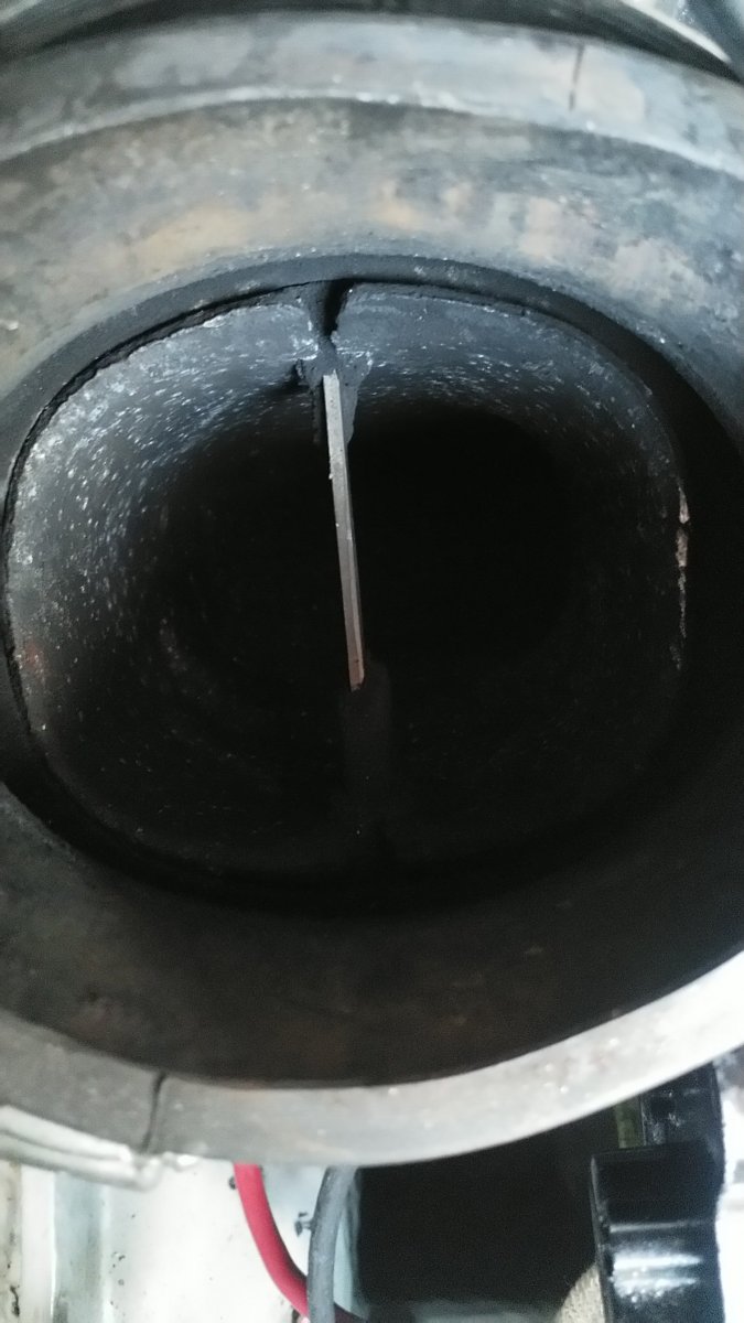

If your engine has been run without coolant, how are your 'flappers' (rubbers) Gilbert? Apparently they can burn / melt and fall into the exhaust :-( But I've also read they're not completely necessary... I suppose it would depend on how high above the waterline the risers go and how much rocking the boat does with the engine off...

LPGC wrote: Sun Jun 25, 2023 8:10 pm If your engine has been run without coolant, how are your 'flappers' (rubbers) Gilbert? Apparently they can burn / melt and fall into the exhaust :-( But I've also read they're not completely necessary... I suppose it would depend on how high above the waterline the risers go and how much rocking the boat does with the engine off...
Yes they can, the bellows between the transom plate and outdrive didn't survive well either. I found two of the steel plates from the flappers in the bellows, one wedged into the outdrive and one still in the bottom of the exhaust.
