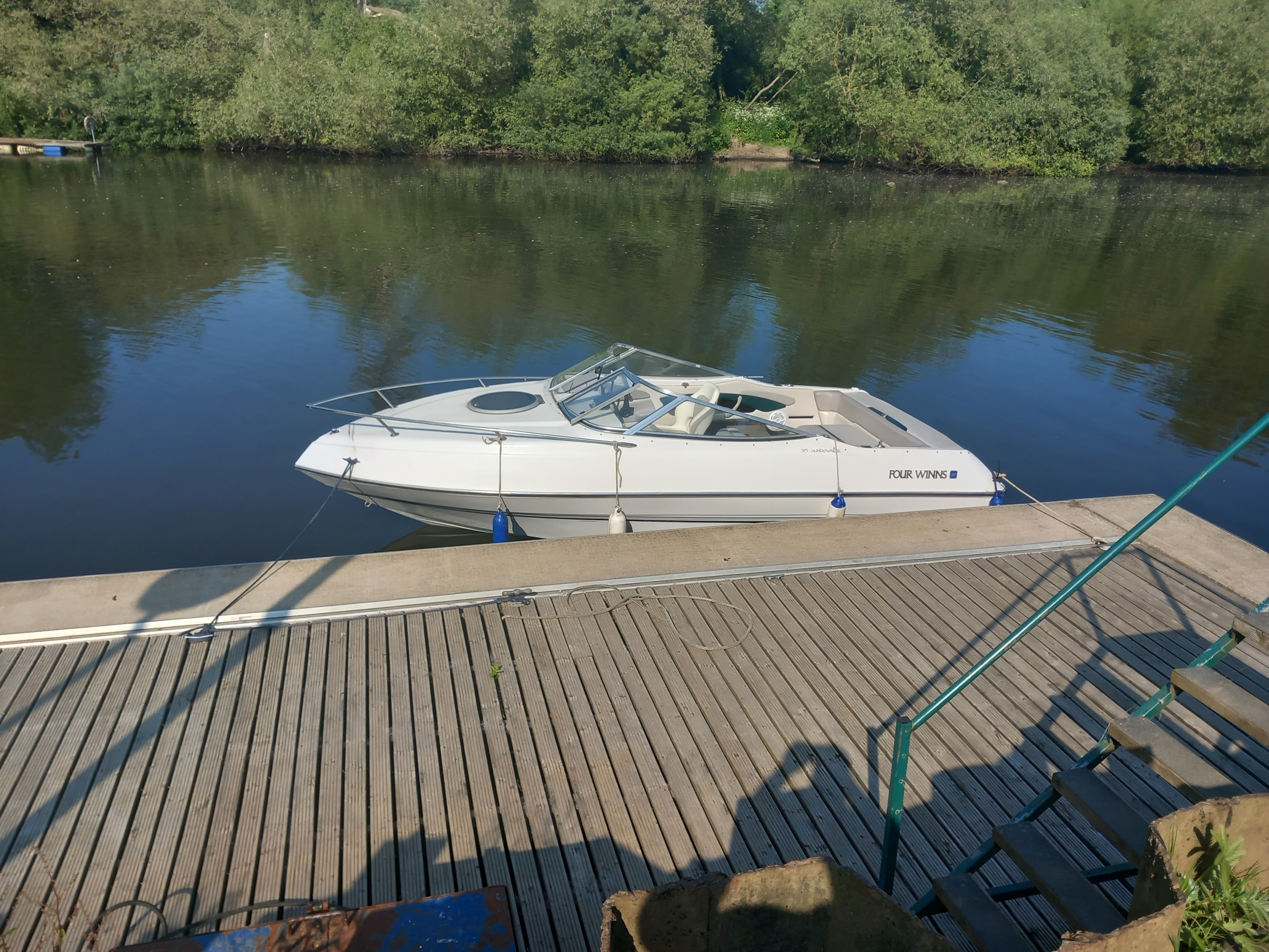

I posted some pics of my boat on the boating forum, which you might have seen Gilbert?
But I'll try some direct picture uploads here...
20230615_181243.jpg[/attachment [attachment=0]20230610_155920.jpg
Re: Cast iron valve seats and LPG
#28 Post by LPGC »
Cracked marine exhaust manifold, water came out of plug holes on this side when I removed plugs to do a compression test
I uploaded files as attachments then clicked on 'place inline'.
