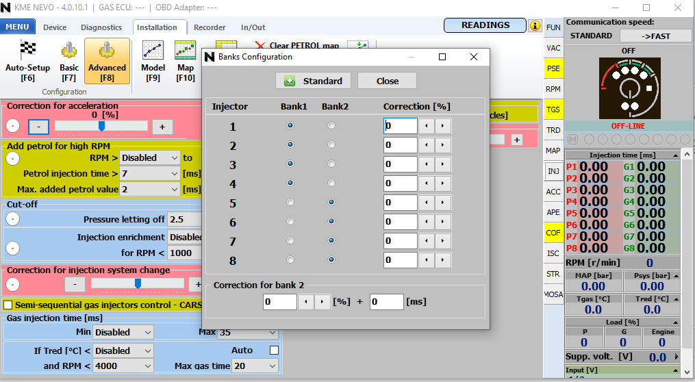

The normal bank wiring on Nevo is 1-4 on one bank, and 5-8 on the other. Your injector timings in the screenshot to me, suggest you have them married up to the odd numbers on one bank, and even on the other. If the gas injectors match this (you have 1.3.5.7 on one lot, and 2.4.6.8 on the other) then it should be fine, though somewhere in there is a setting for the bank as well, as each bank has its own trim.
This is from mine - but mine has the wiring loom using 1-4 for one bank, and 5-8 for the other. You access this by the inj button on the righthand side
If the wiring doesn't match between petrol and gas injectors, you can be having fuel trim corrections applied to the wrong bank, which will then throw that bank out, in the meantime the adjustments to the trims will go further in the wrong direction on the first bank as its not seeing it change. Meanwhile the second bank goes in the opposite direction as its seeing the reverse happen. Same applies to the pipework if you put it into the top section without flipping it over to be correct, though at least that should be ruled out for now with what you've said above.

With Nevo it doesn't really matter which ECU channels correspond to which cylinder numbers/banks as long as channel outputs match channel inputs (routing is correct). But if you want to set a bank trim you do have to know which channels correspond to which cylinder bank... If just for the bank trim you still don't need to set which channels are on which bank because you can set a trim for each channel, but if you do assign banks to channels you can use the global bank trim setting and if you want to set a pulse duration offset (in terms of set milliseconds rather than a percentage offset) you have to assign cylinder banks.
Injector breaks are done on the injector pulsing wire (so on the injector negative of this car and the vast majority of cars). If you connect to the pulsing wire but get the striped/unstriped wire mixed up the petrol injector readings will seem correct while running on petrol but will go to 0ms when you switch to gas, which will mean the gas injector on that channel won't pulse so you'll get a misfire on that cylinder when running on gas. If this happens it won't be long before the system sees the 0ms as an error that causes the system to switch back to petrol (unless the Hemi option is set and/or the 'error action setting' for missing petrol injector signal for that channel is set to 'do nothing'). If you connect the striped/unstriped wire to the none pulsing wire on a petrol injector the LPG ECU will either read 0ms or very high ms petrol injector pulse duration on that channel and you'll still get a misfire on that cylinder when running on gas. If striped and unstriped are connected to the pulsing wire and also shorted together then when it will read pinj correctly but when you switch to LPG the cylinder will get both LPG and petrol so (usually) there'll be a misfire on that cylinder.
