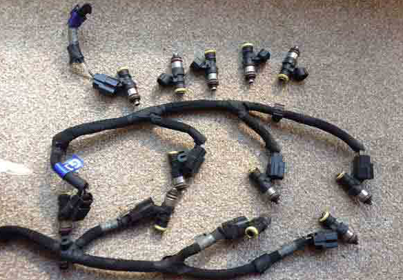

I've got a heap of Bosch NG12 which are ex-Tesco. And 6 x Keihin Orange (thus a spare) too. Here's the NG12.
05 NGi2.png (506.76 KiB) Viewed 4697 times
Bosch 2200 cc/min ( 210 lb/hr ) High Impedance Injectors ( Alcohol Compatible )
Came from their Fiat Iveco delivery van-fleet. Can't imagine Iveco / Bosch engineers are idiots, so would think these are best. Without simple barbs / mounts etc they look a pain to fit, and may have impedances not compatible with Nevo. I've got the Iveco Metatron 7Bar reducers too.

Thrown out by Tesco, I got those Metatron /Bosch bits for nothing. New, there must be £2200 in gold-plated ironmongery there. It'd be a shame not to use this. Right now the problem is: The gas-times are far too long. As for injectors themselves, Zavoli will have to do. So far all I've been able to do is rob the pressure-sensor from the reducer. And if the Zavoli don't work well, the Keihin Orange will be simpler.
I should hasten to add, Dai (classicswede) has been very good. This should be a join-the-dots install, only this appears to be a first. Had this been a standard 'girlie gas' job we'd be done long since. Dai would have told me what to fit, and what to expect.
Knowing this at the start, the bloke with this stuff down 'verbatim' is Dai's or LPGC's Russky/ Polish / Argentinian cousin? The Argies love CNG. Instead, to date, poor Dai has been plagued with near a dozen 5-10 minute phone-calls from me to keep this headed in the right direction. And we're not done yet. I carry on.

I'm now looking at 3 x TAP. Two 'truant from school' Chinese AEB510 + 1 x Stag TAP 01. At £20 each I can't say no to hte Chinese TAP. And now I have the firmware kit such that it won't smoke them, these are my first port of call. If I can cure the sluggishness I'm happy.
Speaking to Dai, he was not keen on Zavoli PAN either. I might live to regret not taking his advice. As I said, I put a PAN rebuild kit to all five. new springs and valve-seats. I er, think, they run as well as PAN injectors can.
Misfires? The engine had been sat non-running when I last did a compression test. It burns quite a bit of oil. Nonetheless it doesn't sound half bad - still peppy on petrol. It's smooth at idle on both fuels. Stumbles a bit mid-range on both fuels but not badly. I'm going to give it another compression-test, maybe a valve has seated? It's condition is not helping matters, but hell... this is 'bangernomics', and it runs. If this carry-on b*ggers an already b*ggered lump, better I do it now. My logic? Burn valves now getting it right, over putting in any decent rebuilt lump and mess that up.
For now I'm going to shove a Chinese TAP on. Until I have the non-fried TAP issue sorted i see no point looking-up Dai. TAp goes on this weekend at latest. Not sure how a TAP will affect the Nevo set-up, last done without the TAP.
With so many varaibles, to be honest, I'm getting out of my depth. Pig to install 'right' hence I've avoided it; so happens I've an Innovate wideband gauge knocking about. Might just put that on. I'm a big fan of wideband gauges, helped a lot with my Land-rover series install. Thus this fool can 'see' what happens, and when. A LR series is no lambda vehicle, all I did was put a boss on the exhaust. Replacing the Volvo narrowband with a wideband and using the Innovate wideband gauge to emulate the narrowband is supposed to be possible, only my money says it adds another variable, hence I'm wary. And I'm wary of doing as my LR adding a WB probe independently. Not keen to beggar the exhaust.
