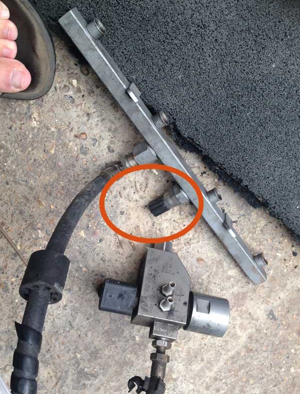

This might be useful to someone. Seems to be quite difficult to get suggested jet sizing charts for CNG from most injector manufacturers. All focus on LPG.
With Zavoli I was lucky. Drillings for Zavoli PAN Injector sizing on CNG. I used 2.6mm
Thus so far...
