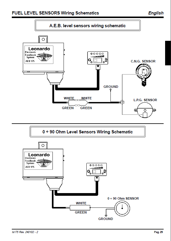

for a 0-90 sensor, the install instructions show white and green should be connected to one side (together) of the sensor, and the other side to ground?. Though you should be getting access to the ecu through the software if you've fixed the only fault on the board.

Level sensor wise, the manual shows various combinations of the white and green wires depending on the type of sensor being used, but the general theme is the other side wants to goto ground not back to the ecu. Example attached, if you don't have the manual this comes from can get it to you somehow though I'd guess you have it already?
- level sensor aeb175.png (40.49 KiB) Viewed 11314 times

Thank you Brian i do have the manual , just forgot it , looks like i put the pot across white wire and earth with my aeb 1050 sensor .
i wonder if i can see if the fx dx wires are putting out a signal , maybe with my oscilloscope ?
I'd read that to be what the manual is saying as well regarding the wiring of the level sensor, though depends what type of sensor is selected in the software as to what the gauge does. It seems there is a option for a low fuel level only sensor (on/off float swtich type thing i'd guess). If thats selected it only lights the bottom led depending on the level in the tank.

white wire to pot and pot to earth gives 4 green leds , irrespective of resistance . assume leo set for diff type of level gauge.

The AEB 1050 has something wierd about it (I think, but not sure that it goes the opposite way to a 1090 sensor (lower level on gauge on the 1090 means the voltage drops, lower level on the 1050 gives higher voltage I think?) though looks like your wiring is now correct. Though again, who knows what the ecu is setup to expect, and until you solve the connection problems it doesn't really matter anyway.
