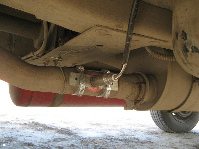

I almost live with the DIY sensor in the exhaust , i can run it with the probe showing .05 the whole tank, i can run it with no uphill load power at all and i have to change down gears, i can drive it under 2500rpm for the whole tank.
When i pull over on the street my wife knows i am going under the hood for a fiddle.
There one thing i am going to do and that is drill a hole around the resonator and fit the lambda probe there.

I also bit the bullet , pulled out the drill and fitter the Lambda zont in the pipe(located between resonator and main muffler).
Didnt have a welder and could not be bothered trying to explain to a local why i wanted a Nut welded on the exhaust, so i figured another way.

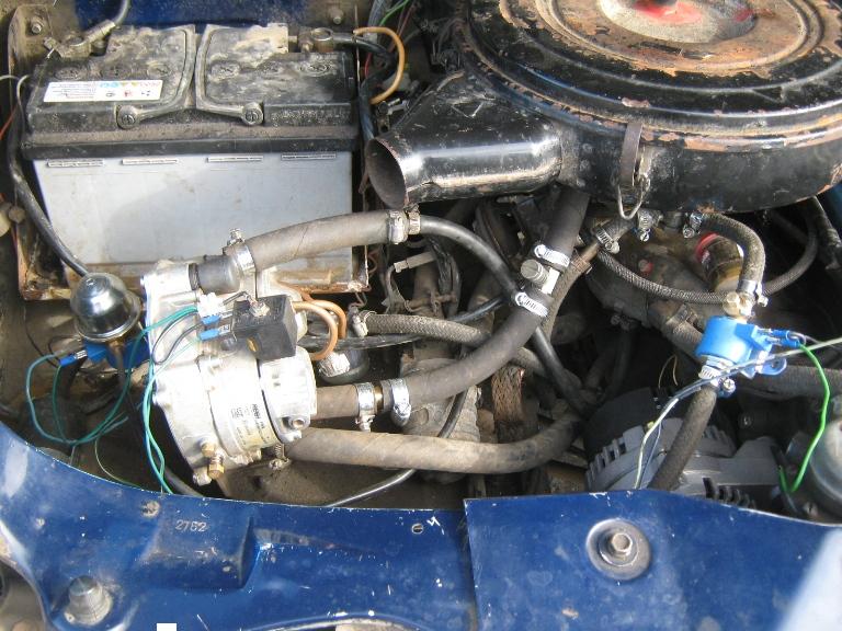

Im trying to modify 2 mixers into 1 usable mixer. I am taking an EFI inline mixer and trying to fit it to the old mixers carby shroud.It can work, but the biggest problem is the air filter box has a silly hollow in the middle.As you can see by the above pic(stupid design the hollow fills up with water and i get to boil some eggs on the way to work.
I have not sourced another filter and am reluctant to go down the tubes/pod filter route.
I am thinking of cutting the center out and installing it upside down with the lump facing up.this would solve all my problems and cost nothing but pop rivets and gasket maker, but i have not done it yet.
Atm i am getting a faster read out of my DIY tester compared to throttle movement(really glad i moved it now)
Pilot screw is all the way in.
I have a lean reading at idle which the motor likes, but off idle is a little lean(due to poor mixer design).Normal driving though does not show lean at off idle.Average reading is about .85, throttle hits see a .9-.95 reading.
It still smells of gas at idle(unsure about driven though).
I changed back from LPG plugs to an iridium Normal plug type aswell.
I am wondering why the exhaust smells of gas and shows a lean reading at the same time.
I need to do a test and garantee spark to all cylinders.

cors wrote:I am wondering why the exhaust smells of gas and shows a lean reading at the same time.
Understand what the oxygen sensor does ... it senses oxygen in the exhaust. It tells you nothing about the fuelling directly, though we (and electronic controls) use it to draw inferences.
If you detect more oxygen, you may well interpret that us meaning "lean". But it might not be ; if we have a cylinder with incomplete combustion - maybe wonky spark, poor compression, blah - it will let unburnt oxygen into the exhaust for the sensor to detect, as well as unburnt fuel for the nose to detect. It tells you nowt about the air/fuel ratio in the poorly cylinder(s) and masks the air/fuel ratio in any 'good' cylinders.
You can in fact wind up the mixture on an engine so far that richness causes misfire ; the oxygen sensor duly reports oxygen which can be completely misinterpretated as "lean".

I added some small pipes in the hope to create extra gas draw to the primary venturi.
Not sure if it will do anything.
I need to replace the red gasket maker stuff with something that will last too.
