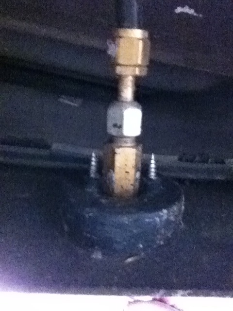

Which one is this???

#4 Post by m_unawar »
And this.
Re: Euro Dish to UK Bayonet Filling point change
#5 Post by Gilbertd »
A bodge......
It looks like you've got 8mm Polyflex pipe to the tank but the filler can only take 6mm so you've got a join between the two. That must take weeks to fill, 8mm is slow enough with restricting the flow even more.
Can't really see what it is fitted into but I would say you need the third item down on this page http://www.tinleytech.co.uk/acatalog/Fi ... _caps.html (the UK Bayonet straight).
#7 Post by Gilbertd »
You'll also need one of these, (N03) Fitting for Faro 8mm Poly pipe to 8 mm from this page http://www.tinleytech.co.uk/acatalog/Po ... tings.html. As the filler fitting is designed to take 8mm copper pipe with a nut and olive, this fits on the end of the Polyflex pipe and converts it into something that is the same as 8mm copper pipe.

#8 Post by rossko »
Looks normal enough to my eyes ; an 8mm poly pipe with a 8mm plain standpipe fitting, going in turn into the 8mm compression fitting forming the back of the cup filler.
Don't forget you need a housing as well as the filler brassware. It looks like you've got room for usual fully recessed plastic bucket, which is bulkier behind than the cup type.
