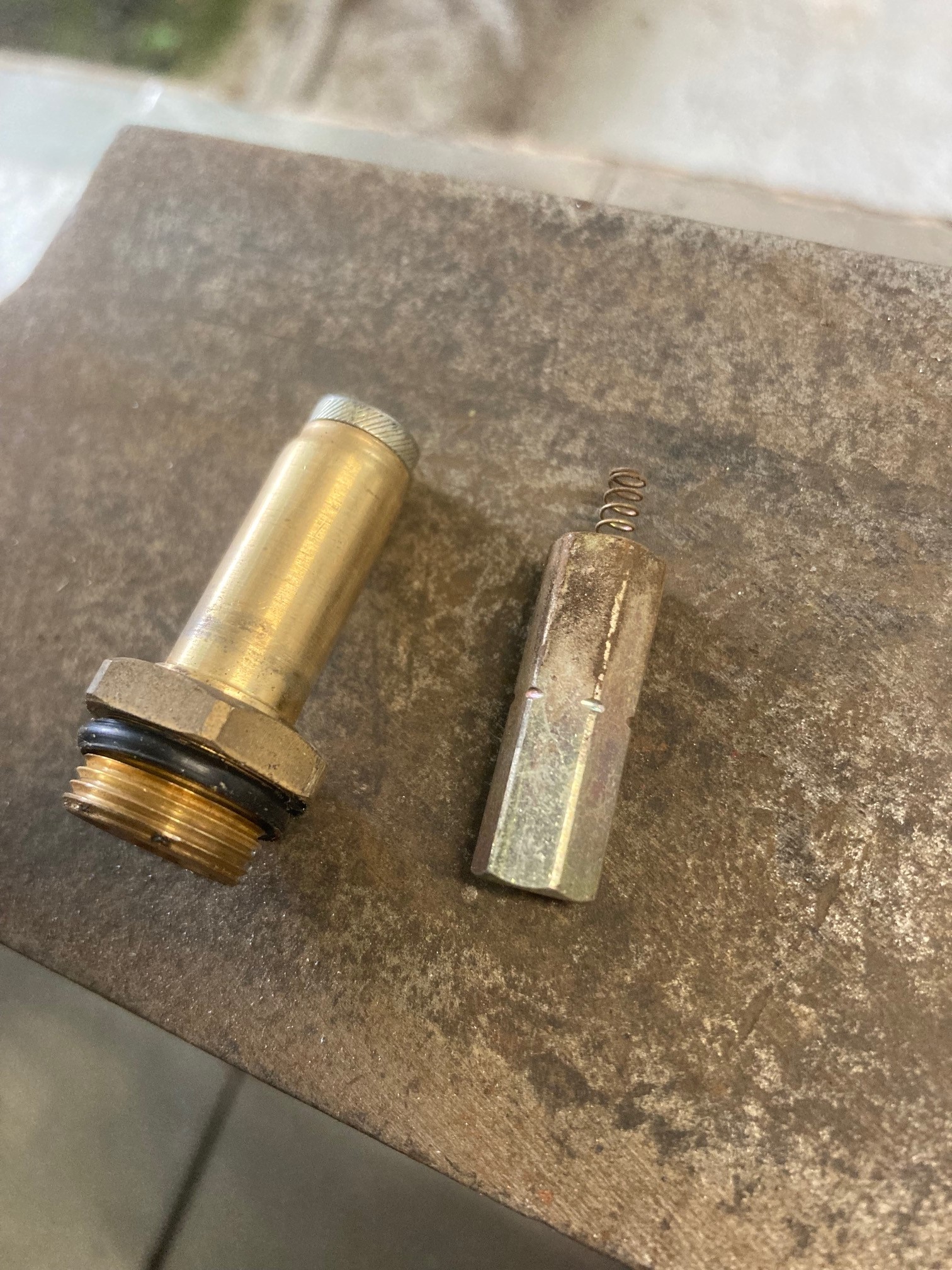

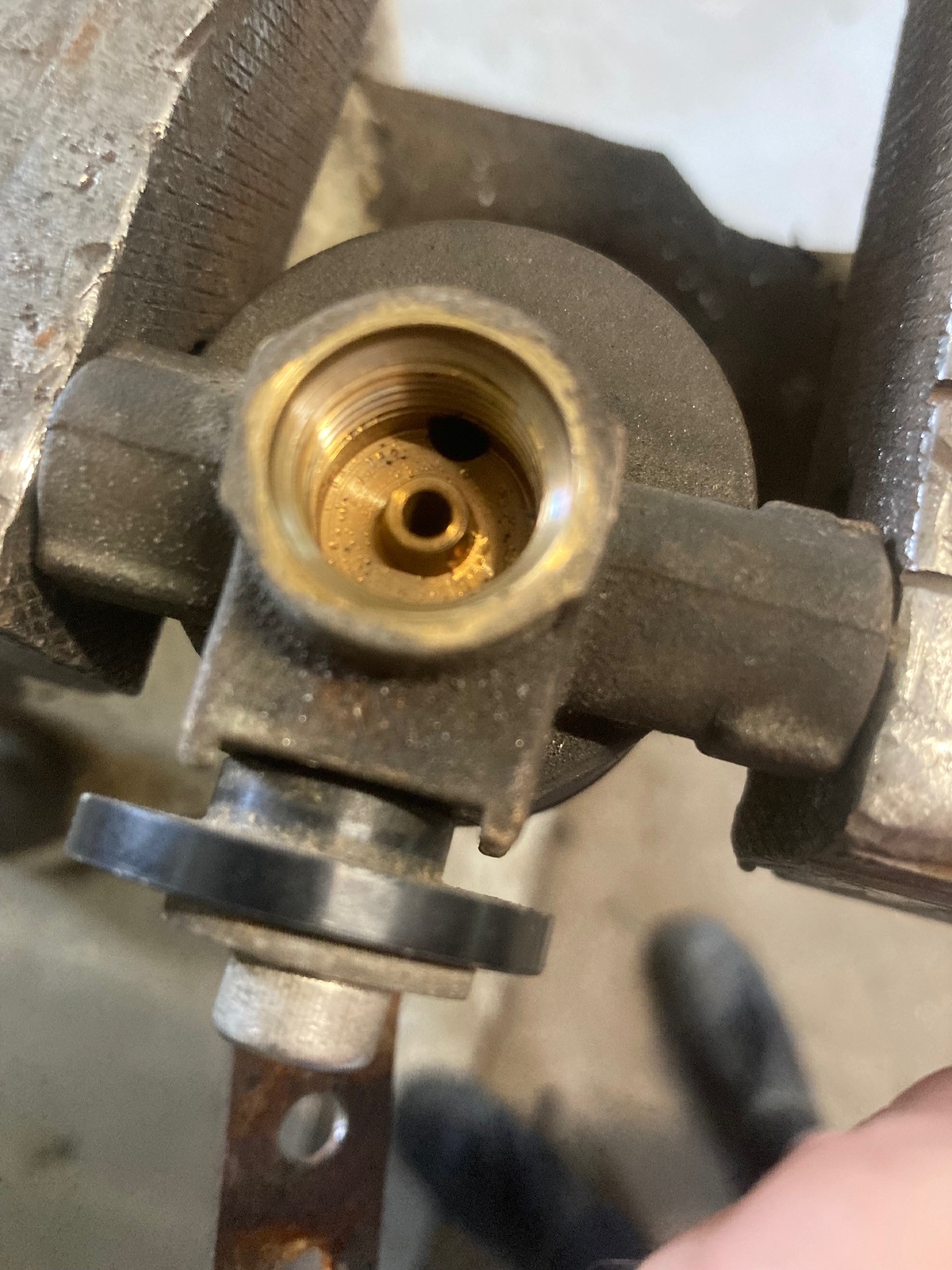

thanks simon , that sent me in the right direction , not sure i understand what has happened though .
i primed the system ,and undid the connection to the reducer a few turns ,result , no gas emission . i had earlier tested the solenoid gas valve , and it was clicking .
so , clicking solenoid , but no gas flow .
i took solenoid off and took it apart , the pintle was a bit crusty ..
the seat looked fine ..
so i gently sanded the pintle smooth , reassembled ,and wopped 12v over its terminals , and it clicked and i could blow through it .
put it back on the car ,and stuff me , it ran on the front engine !!
