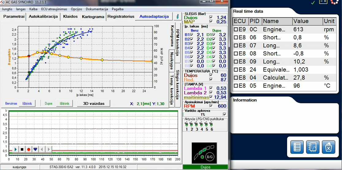

Some updates. Had some spare time and what I noticed that the curves on calibration map has changed. Did a re-calibration today, but I just cant set the very low load area correctly. It feels imposible since the STFTs switching from petrol to LPG are almost always different in one way or another. And sometimes it looks OK. Anyway looks like I could deal with middle load (5-7 ms) pretty well the STFTs don't fluctuate to very positive or negative sides. The high load looks okay too, but the curves are not joined. LPG curve is more to the left vs petrol, the STFTs tell me that this is the way they should be (maybe because of LPG switching to petrol at 4k RPMs function is on?). The LTFTs are always positive now +5..+11..+14, no more -25 LTFT haha
. But what I noticed today was a very small whistling sound with the window down and only when the engine was not in operating temp.. Now my first thought is- a small vacuum leak somewhere? Maybe it is not letting me to fine tune the LPG?
Re: 2GR-FE 07 Camry
You know it makes sense to investigate the whistling sound, it could be a vacuum leak, a vacuum leak could be in a troublesome position such as on the threads of a 'spud' (brass LPG injection nozzle) in the manifold potentially making one cylinder run leaner than others. But if the whistling only occurs on LPG it could be the LPG pressure reducer vibrating at sound frequency, this would be a gas pressure whistle not a vacuum leak.

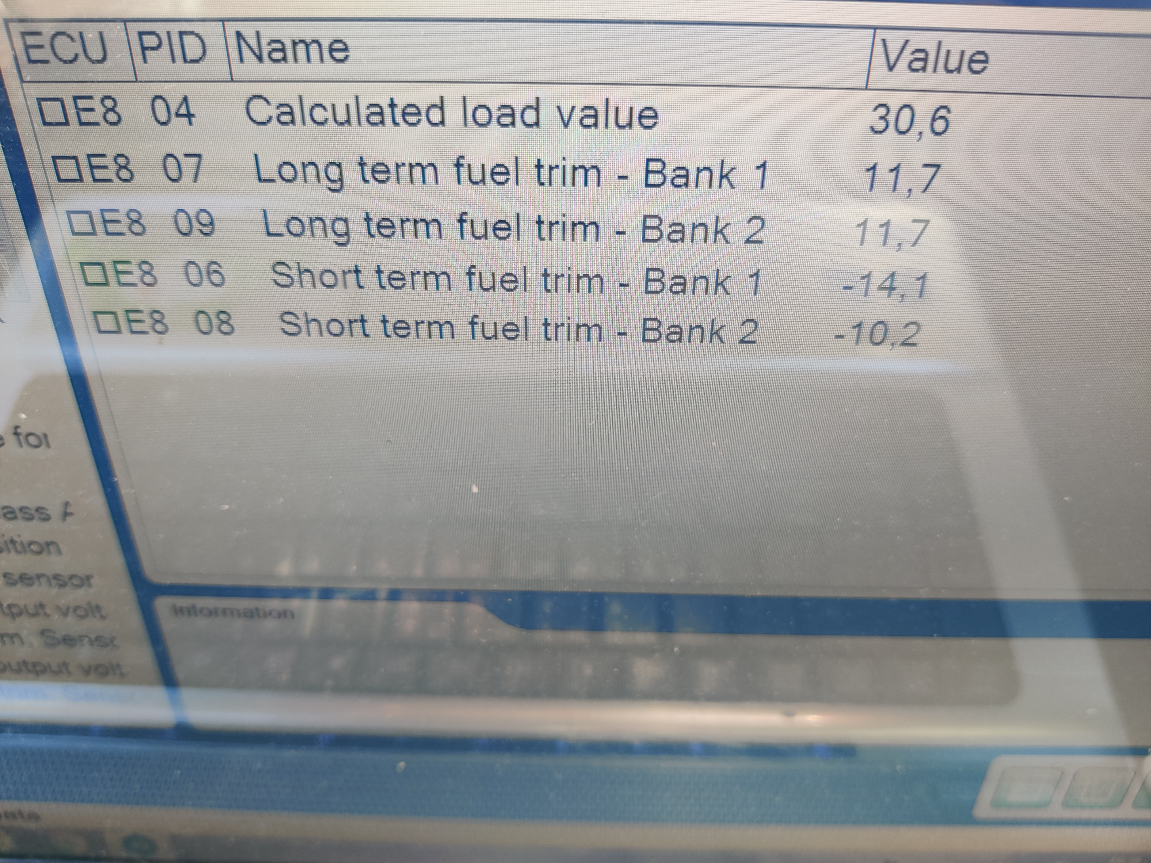

When you're calbrating you should be looking at STFT's and LTFT's. Sometimes at idle and low loads the difference between running on petrol and LPG (not least including the fact that LPG is injected as a vapour which takes up more volume in the inlet manifold than liquid petrol) can see the petrol ECU switch between LTFT ranges because there is a very slight difference in pumping losses and engine efficiency.. The petrol ECU controls the throttle (or IAV) to maintain the same idle speed regardless of which fuel you're running on but that throttle position can be effected by the differece in calorific value of the fuel (how much heat you get from burning a certain amount of fuel), the stochiometric ratio (how much air it takes to burn a certain amount of fuel) and the pumping loss (the engine acts like a pump, it has to suck air in and blow exhaust gas out). If it wasn't for pumping loss / efficiency differences we might expect / assume that running on LPG would need more intake air so the throttle would need to open a little more because LPG needs more air to burn the same weight of LPG as weight of petro.. but offsetting that there is the fact that LPG makes more heat by weight than petrol and less heat by volume (especially as LPG is in vapour form while petrol is in liquid form when injected). It isn't unusual to see idle MAF readings and MAP readings lower when running on LPG compared to petrol, and in a way this implies that the engine is idling more efficiently on LPG than on petrol. The lower MAF and/or MAP reading can be enough to see the petrol ECU apply a different LTFT range. To explain LTFT range - A simple hypothetical petrol ECU fuel map table might have 100 columns for RPM and 100 rows for MAF reading so 10000 cells in total but might only have 20 LTFT fuel trim ranges in total, so each LTFT would cover (apply to) on average 5000 cells of the fuel map. If you're just watching STFT's (and not watching LTFT's) you won't know if any slight difference in MAF/MAP readings between running on petrol and running on LPG sees the petrol ECU jump to a different LTFT range, a different LTFT range could have a different LTFT value stored in it. If for example one of the ranges had +10% LTFT stored in it and STFT was hanging around -10% and we add the LTFT and STFT together the total trim comes ot 0%. Or if we had -10% LTFT and +10% STFT the total trim is stlll 0%.Both of those situations would be OK and basically equal in terms of total fuel trim applied but if you were only looking at STFT's and not taking into account LTFT's you could make the mistake of assuming the mixture had changed by 20% when you switched between fuels when actually it was fine, you just hadn't taken into account the LTFT range shifting when you switched fuels. Of course you would still want to do further checks to make sure that fuelling on LPG was the same as fuelling on petrol, and you have to remember that the LTFTs have been learned so at some point (running on petrol or on LPG) it has been learned to be the value it is, you never want to see excessively low or high STFTS (or LTFTS) when running on either fuel or switching between fuels, but unless you watch for changes in LTFT range you could end up making the LPG map worse instead of better.
That was a simple example of fuel trim ranges and the petrol system map. In practice fuel trim ranges and the map are more complicated. There will probably be a different set of LTFT's applied to the map for different engine temperatures and intake air temperatures, etc. Some of the fuel trim ranges may only be applied for a short time during engine warmup. The petrol system goes closed loop at a relatively cool temperature when some 'choke effect' is still being applied (excess fuel factor to compensate for petrol that isn't burned when the engine is cool). If any petrol that is injected isn't getting burned when the engine is relatively cool, then you switch to LPG, you should expect the fuel trims to go negative after switching to LPG because the LPG will burn because (due to it being injected as a vapour and having a low boiling point) it will always mix perfectly with the air and burn. If fuel trims go negative when you've switched to LPG solely for the reason described here it is a fuel efficiency gain for LPG over petrol, the amount of negative fuel trim represents the excess fuel factor that was necessary when running on petrol with an engine that was still warming up. But you need to be sure what you're looking at, there could of course be other reasons why fuel trims go negative when you switch to LPG.
Looking at your screenshot above, LTFT's are at around +12% and STFT's are at around -12%. If that condition continued we'd expect that eventually LTFT's would be steered to be close to 0%, at which point STTS's would also likely stay close to 0%, so then we could add 0% LTFT to 0% STFT and the total trim would be 0%... As far as the petrol ECU is concerned that would be alnost perfect, the least likely situation to cause problems.. as long as when you switched fuels LTFT+STFT were still close to 0% and STFT didn't go too positive or too negative. But the idea when mapping an LPG system is to have fuel trims that are the same as would-be if you were running on petrol, at any temperature, at any rpm or engine load. It is possible to do this, perhaps with the exception of accounting for the petrol system haivng to apply some excess fuel factor during warmup, the best way to account for the petrol excess fuel factor is probably to use reducer temperature compensation but it's not always a good idea to use reducer temp compensation because there is a difference between an engine that has coolant temp at 30C on a cold day that has been run and is cooling down compared to an engine that has been started from cold on the same day and is warming up, the former engine (that has been run) will be heat soaked including the petrol in the fuel rail, so it' probably won't need any choke / excess fuel factor, the latter engine won't be heat soaked and probably will need some choke / excess fuel factor. If you try to compensate using the reducer temp compensation method it will still be correct in some situations and wrong in others.
Most engines apply most choke / eff effect (in percentage terms) around the ver low and low load areas of map, some VW's / Audis apply choke / eff effect more evenly across the whole map. On most vehicles (if you don't try to compensate for it / dial it out) you should only see trims go negative for a short time during warmup at around the low load area, not so much acros the rest of the nap. if you're seeing it happen across the whole map it is more lilely due to pressure / temperature / cold LPG injectors affecting fuelling than choke / eff effect but you have to remember that the trim ranges you see applied during warmup may not be the same trim ranges that are applied after warmup.

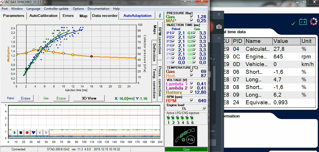

Okay, I think that I was missing something while doing calibrations. I always thought that STFTs has to keep similar at different load moments- lets say I'm driving at middle loads on petrol, STFTs are +10 for ex., I switch to LPG and I need to see the STFTs +10 as well. But at the same RPM in that scenario there will be a different air volume (When switched on LPG) that will have a different LTFT stored at that moment and this is why I should look at LTFTs + STFTs to get near that 0 when adding both. Am I thinking correct? But my question is.. If I have LTFTs and STFTs in sight why would I need to switch between petrol and LPG to set the multiplier? I will just add up LTFTs and STFTs and look for it to be 0. I'm sorry if the question seems to be stupid, I'm in that phase now- the deeper I dig the less I understand. By the way, the reducer I have is working on ~1.2 bar at the moment and I have 45 HP per cylinder. Should I try 2.9 holes instead of 2.7 (according to the table)
- Screenshot_2026-05-08-09-32-19-82_e2d5b3f32b79de1d45acd1fad96fbb0f.jpg (427.72 KiB) Viewed 1806 times
Re: 2GR-FE 07 Camry
