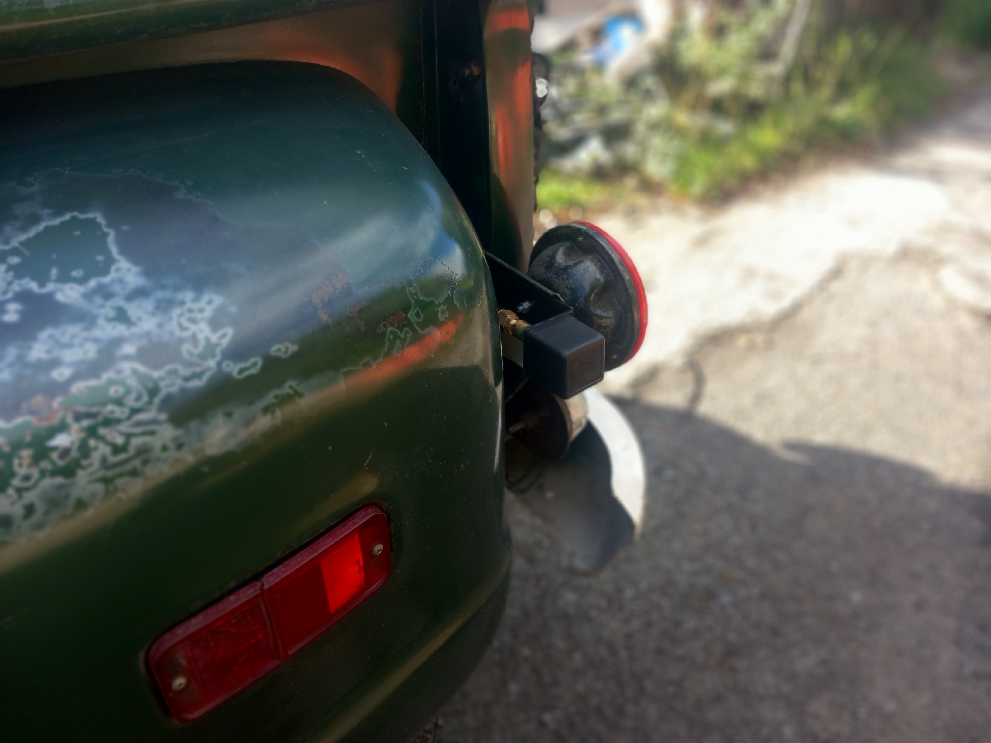

Just finished the conversion of this 1972 Chevy pickup, V8 with 3 on the tree manual box.
Fitted an Impco setup with 105 litre toroidal tank.

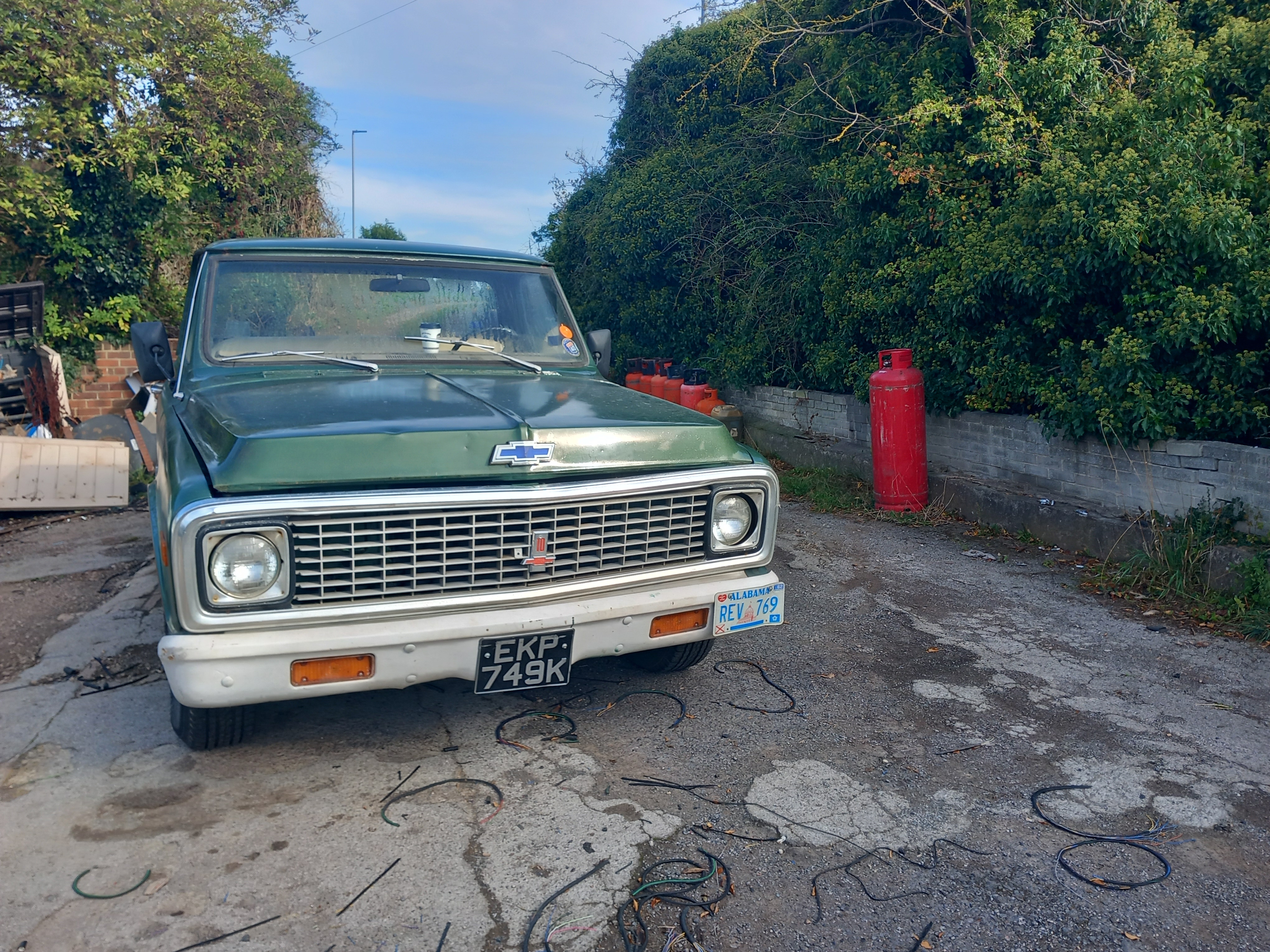

I had a look around the car a while ago and told the owner the (already fitted) custom exhaust at the rear would need to be modified to fit a toroidal tank in the spare wheel location which is underneath at the rear. The custom exhaust used a couple of 'cherry bomb' straight through back boxes fed from a Y just in front of the diff, the cherry bombs would need to be spaced wider apart to make space for the tank to fit between them. He was going to sort the exhaust before bringing it in, but when it came in for conversion the cherry bombs were still fitted in the problem position. The owner said 'Just take them off, I'll refit them where I want later' but I realised that after disconnecting them from the Y the exhaust gasses would blow from the Y just where the flexible brake hose connects to the rear axle, so I had to makeshift/temporarily refit the rear exhaust setup after fitting the tank anyway.
As it was before conversion

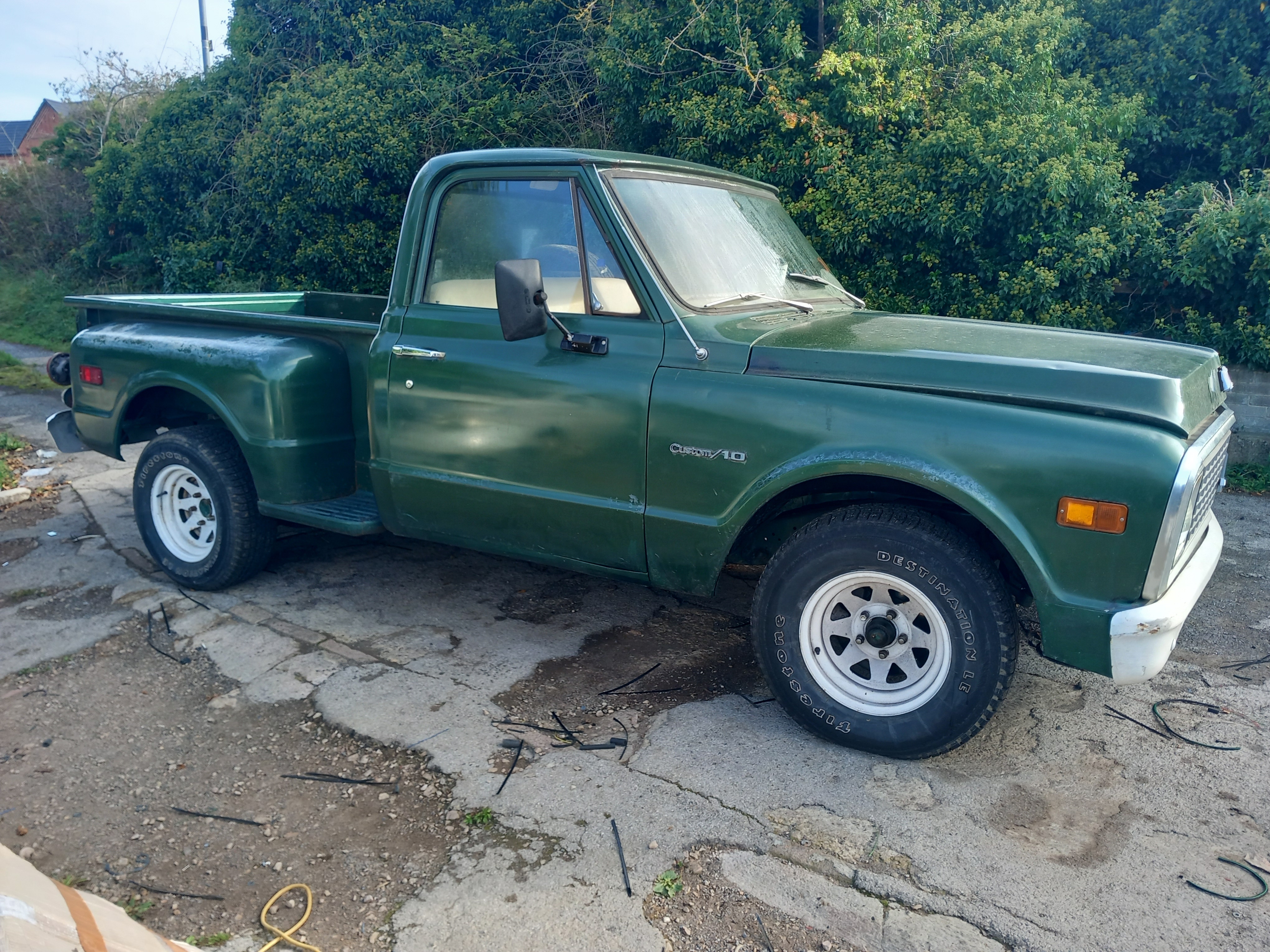

After conversion
