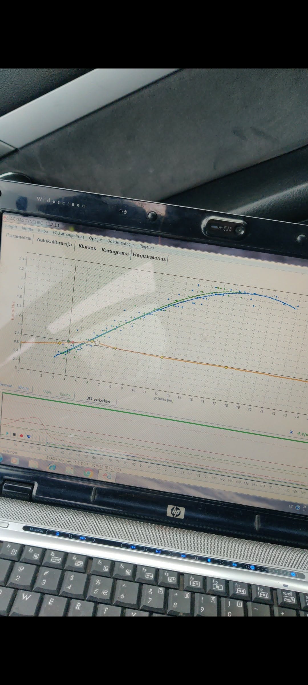

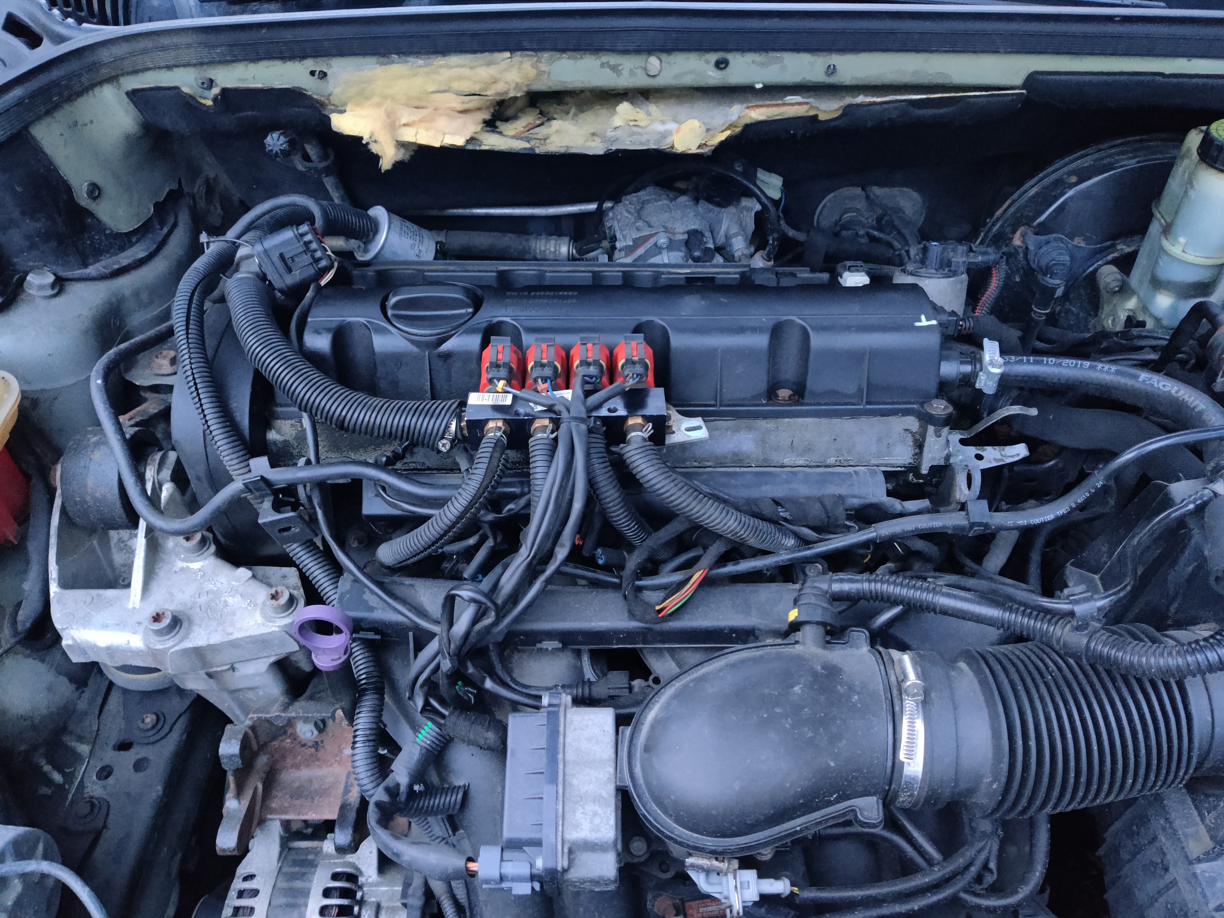

I have two identical cars with same engines. One has Stag 4 eco + tommaseto achille, ac-w02 injectors, other one stag 4 plus (unknown reducer), valtek 3 ohm injectors. They have that combination, because today I exchanged the injectors with each car. (The stag4 plus version had ac-w02 and vice versa before) The car with stag 4 eco always had problems- trailing, wasnt accelerating fast etc. The Stag 4 plus version was always good at acceleration. After replacement of the injectors now both cars accelerate like "meeh" :D :D.. While calibrating the Stag 4 eco version I got a message when auto calibrating- nozzles too big but I still managed to join the dots. BUT while calibrating I noticed the gas pressure jumping a lot- 1.4- 2.2 bar felt kind of unstable (will rebuild the reducer soon). The stag 4 plus calibration went well, no messages, joined the dots easy. My questions are:
1. Is it normal for the stag 4 eco version the reducer pressure to be that high? If no then what can be causing that?
2. The stag 4 plus version with Valtek injectors is feeling weaker because maybe the injectors are not as accurate as ac-w02's?
3. I believe that this kind of jumpy pressure in the reducer could be causing all this trailing?
4. Cars and engines are identical. How the heck gasoline curve is that much different from the other? Different pressure sensors for LPG causing that?
Thanks in advance! :)

Is this the reference pressure You were talking about? I never really paid attention to this setting, but I don't really understand the concept of Gas pressure that is shown in the right upper corner. So this is absolute manifold pressure? (Manifold + LPG) That is shown here? So how do I know how to set everything right if it has an impact on how well the lpg mixture is set. And to have that bare simplicity and point of view. If joining the dots is not ok, what exactly do I need to do then? For example, in high loads. I observe ltfts and stfts while driving on petrol in high load area and at that same moment i switch to LPG- I notice that stft + ltft is lets say is -4 i Decrease the multiplier a little so it gets closer to zero? Is this the correct concept of adjusting the multiplier on these low/ mid / high load areas? Besides, how would I know what nozzle size I have to drill on ac-w02 ? (I was talking about that car with too big nozzles) Thanks!

Yes the pressure setting in your screenshot above is the set reference pressure.
In most 'screens' in your LPG software you can see LPG pressure and manifold pressure. The LPG pressure reading is LPG pressure above manifold pressure, not absolute pressure. The manifold pressure reading is absolute pressure. As far as we and the LPG software / system is concerned it is LPG pressure above manifold pressure that we're interested in, not absolute LPG pressure, because the amount an LPG injector will flow is relative to the nozzle size (or LPG injector internal channels size if that is smaller than LPG injector nozzle size), the pulse duration and the LPG pressure above manifold pressure. LPG above manifold pressure affects how much gas will be injected (for a given pulse length) to the extent of the square root of this pressure.
Example - If you set reference pressure at 1.6 bar in LPG software, then whenever the LPG pressure minus manifold pressure was also 1.6 bar the LPG ECU would not have to compensate for pressure because it is expecting 1.6 bar and reading 1.6 bar. (Also keep in mind that like I said the pressure reading in software is LPG pressure minus manifold pressure, it is not showing absolute LPG pressure, it is showing what we are interested in). But if reference pressure was 1.6 bar and the pressure reading was 1.3 bar then that is an under-pressure situation and the LPG ECU will compensate by adding some percentage to the length of pulse duration to compensate for that under-pressure situation, if it didn't compensate for the lower pressure the mixture the engine would get a leaner mixture than we intended. The formula for LPG pressure correction is usually close to comparing the square roots of the pressure reading and the reference pressure. The square root of 1.6 is 1.2649, the square root of 1.3 is 1.1402. We would have to add around 11% to the square root of 1.3 to get 1.2649.... If you set reference pressure to 1.6bar and the gas pressure reading in software is 1.3bar the LPG ECU will add around 11% to gas injector pulse duration to compensate for the under-pressure sitaution.
If the gas pressure (again worth saying above manifold pressure, and above manifold pressure is what is shown in the gas pressure reading on screen not absolute pressure) is actually 1.3bar but we set a reference pressure of 1.3 bar, then the LPG ECU will (behind the scenes) be adding around 11% to the calculated ginj (calculation based on the multiplier, rpm correction and also gas temp correction). Or if we set the reference pressure at 1.3 bar and actual pressure was 1.6 bar the LPG ECU would behind the scenes subtract around 9.7% (1.402 - 9.8% = 1.2646). Note that the pressure correction percentage is different for a given extent of over pressure than it is for the same extent of under pressure. We could set reference pressure at some ridiculously high pressure such as 2.8 bar and perhaps still be able to calibrate the system even if the actual pressure is really only 1.3 bar but one problem with this is that the multiplier map has a certain resolution, let's say it has a resolution of 8 bits (which is 255 points) and for this over pressure situation (2.8 bar square root being 1.6733 versus 1.3 bar square root being 1.1402) the LPG ECU would be subtracting over 31.5% so we would need to set our multiplier numbers low for correct fuelling and with the low (small numbers) in the multiplier we start to lose resolution - The resolution could be termed accuracy, there is a 2% difference between numbers 50 and 51 so if we had a number 50 in our map the nearest next number we could set would be 50 or 51 which is like a 2% jump. But if we set numbers closer to 100 in our map the difference to the next number we could set is only 1%, this is twice the multiplier accuracy we could get with the numbers in the 50's in our multiplier map. We also gain accuracy because the LPG ECU isn't having to calculate those square roots correctly or use a pressure lookup compensation table that might only be able to compensate to the nearest 1%. And we gain accuracy if the correction values are close together because behind the scenes the LPG ECU will probably simply be adding up all the correction perecentages, so there's a correction percentage for pressure but there's also a percentage correction for temperature... Imagine an engine still warming up and the gas vapour temp is cold, so the gas vapour is denser than when it is at normal operating temperature, let's say the LPG ECU compensates for this gas temp be decreasing ginj by 10%. If it is already decreasing ginj by 30% because we have set the reference pressure at 1.3 bar when actual gas pressure is 2.8 bar the 10% temp correction pales against the 30% pressure compensation, it effectively makes our temp compensation incorrect too and effectively further decreases the resolution/accuracy of our multiplier map.
The best way to calibrate the LPG system is often to set reference pressure to actual pressure, it is always the case that it is best to set it reasonably close, but there can be some exceptions and it can depend on what ECU/system we're talking about. Most ECU's are better and more accurate at doing positive corrections than negative corrections, so it can be better to set reference pressure the same as or a little higher than actual pressure. However, on many systems the actual pressure falls when the driver gives the engine some stick, so in that case it might be better to set reference pressure somewhere between actual idle pressure and high load 'stick' pressure, in this case the ECU might apply a little negative pressure compensation at idle but not have to add as much positive compensation for the high load 'stick' conditions (of course the better setup would have a reducer that doesn't lower pressure under 'stick').
I didn't say joining the dots isn't OK, it is another tool in the box but you have to remember that the dots could be plotted at different rpms and the dots are higher at rpms where the engine volumetric efficiency is higher and lower where volumetric efficiency is lower... If dots are plotted at one rpm on petrol the dots on LPG should be in a different position at a different rpm. The ECU will probably attempt to use dots plotted at around the same rpm but that won't be possible unless you've driven it on both petrol and LPG at the same RPM. The dots lose a lot of their meaning when the engine is running in open loop mode because in open loop mode the dots will be plotted in the same position when running on LPG as they are on petrol anyway. If the engine doesn't have a fuel return then while you're driving around on LPG the petrol is sat in the petrol injector fuel rail being heated by under bonnet and engine heat, so becomes less dense, so then when you switch back to petrol the fuel trims on petrol will probably be a little higher than they would normally be on petrol, if you compare plotted dots on LPG to dots plotted when running on petrol that is less dense than normal it will make it seem the LPG system is calibrated a bit richer than the petrol system. When you run on LPG the LPG is injected as a vapour into the engine, the petrol would be injected as a liquid, the LPG vapour takes up more volume than liquid petrol in the manifold... This can have a different effect on an engine that uses a Map sensor as primary input for fuelling compared to an engine that uses a MAF sensor as primary input for fuelling. In both cases let's assume you keep your foot in exactly the same position on the accelerator pedal as we switch from petrol to LPG - In the case of the map sensor the reading increases because we are pushing some vapour into the manifold, this vapour is in addition to the air that is coming through the throttle, to the engine that uses MAP as primary input this looks like a slight increase in engine load so the petrol system reacts by slightly increasing pinj. In the case of the MAF sensor being primary input the manifold pressure increases because we pushed some vapour into the manifold, so there is less vacuum in the manifold, the less vacuum means not as much air flows through the throttle so to the petrol system it seems engine load has decreased and it may respond by decreasing pinj. In both cases the change in perceived engine load may be enough to have the ECU start applying a different long term fuel trim range, so if you were only watching STFT's (and not watching LTFT's) you could see a change in STFT that only occurred because of the switch to a different LTFT and assume the mixture changed when really it didn't and really LTFT+STFT didn't change. In the case of the MAF setup (which most engines use these days) if we switch from petrol to LPG and don't move the throttle the applied LTFT won't change, at least not at loads above idle, and the small drop in MAF reading means that our plotted LPG dots shoud point to a slightly richer mixture on LPG than on petrol even though the actual mixture is the same. The real difference is that due to the LPG vapour taking up that bit of extra space in the manifold (than liquid petrol) the power drops slightly and if we want to still have the same power that we had on petrol before switching to LPG we have to very slightly (perhaps unknown to the driver) push the accelerator pedal a little more so the the engine gets the same air intake as it was getting when running on petrol.
All the above are small effects but are real and noticeable, especially to a practiced / trained eye. And the effects can make a difference to fuel trims. You tend to find that if you manage to plot points on LPG at exactly the same rpm as points for the same load position on petrol, and you have accounted for petrol temperature changes and everything else, then for fuel trims to remain the same the plotted dots will usually imply it is calibrated marginally richer on LPG than it is on petrol.
You can sometimes also see related effects at idle if you have a particularly sensitive map sensor. One aspect than relates to engine efficiency is pumping losses, the amount of power the engine has to use to suck in air and fuel and blow out the exhaust gasses. If an engine idles with (say) 0.3 bar manifold pressure when running on petrol (remember the manifold pressure reading is absolute, the LPG pressure reading is usually relative to manifold pressure reading) then the manifold pressure reading under the same idle condition may fall slightly when running on LPG, this is in some ways counter-intuitive because weight versus weight LPG needs more air to burn at correct mixture than petrol... however, weight for weight the LPG creates more heat than the petrol so the engine doesn't need as much weight of LPG as petrol to maintain the same idle speed as petrol and by pumping some volume of gas into the manifold through the LPG injectors it also slightly lowers the induction pumping loss. There may also be an unrelated effect that slightly offsets our comparison of MAP readings, both the petrol ECU and LPG ECU may have a slightly different effective reference voltage (or ground reference voltage) that they provide to their respective MAP sensors depending on whether the petrol inejctors are being driven or the LPG inectors are being driven... But when you consistently see lower MAP and MAF readings from both the petrol ECU and LPG ECU when idling on LPG compared to idling on petrol it confirms that the engine needs less air to idle at the same rpm speed and load on LPG than it does to idle on petrol, so it is idling more efficiently (at least in that respect) on LPG than on petrol.
Anyway, your takeaway from this is that it is OK to use the join the dots method as long as you also check fuel trims. And you cannot use the join the dots method to set up high load fuelling if the engine switches to open loop mode at high loads, in that case you use lambda readings.

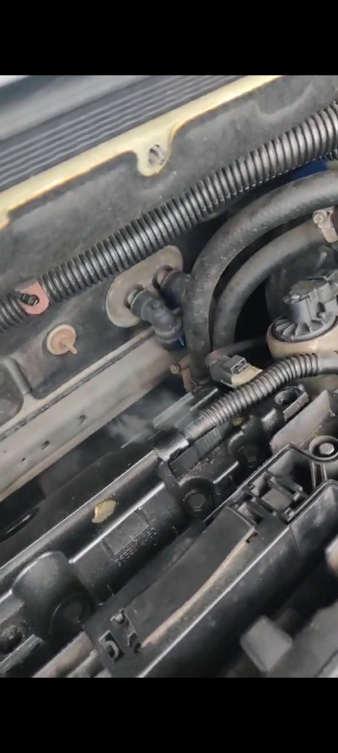

Another update. Smoke tested the EW10J4 today. I have two small vacuum leaks near throttle body, one small leak on the oil dipstick and a huge vacuum leak on the PCV hose connection. Will isolate it and report back if it does anything.

Isolated vacuum leaks. After isolating them found even more. The stud was untightened that lpg hose goes on it. Camshaft sensor seal was leaking too. After all, the results were immediate in fuel trims. On petrol it evens out to 0, on lpg it is a bit rich still. But noticed that sometimes when the car is idling, it randomly misfires, sometimes even stalls out of the blue sky. The trims go mad for that one moment and after that it all evens out again like nothing ever happened. Sticking throttle body flap maybe?
