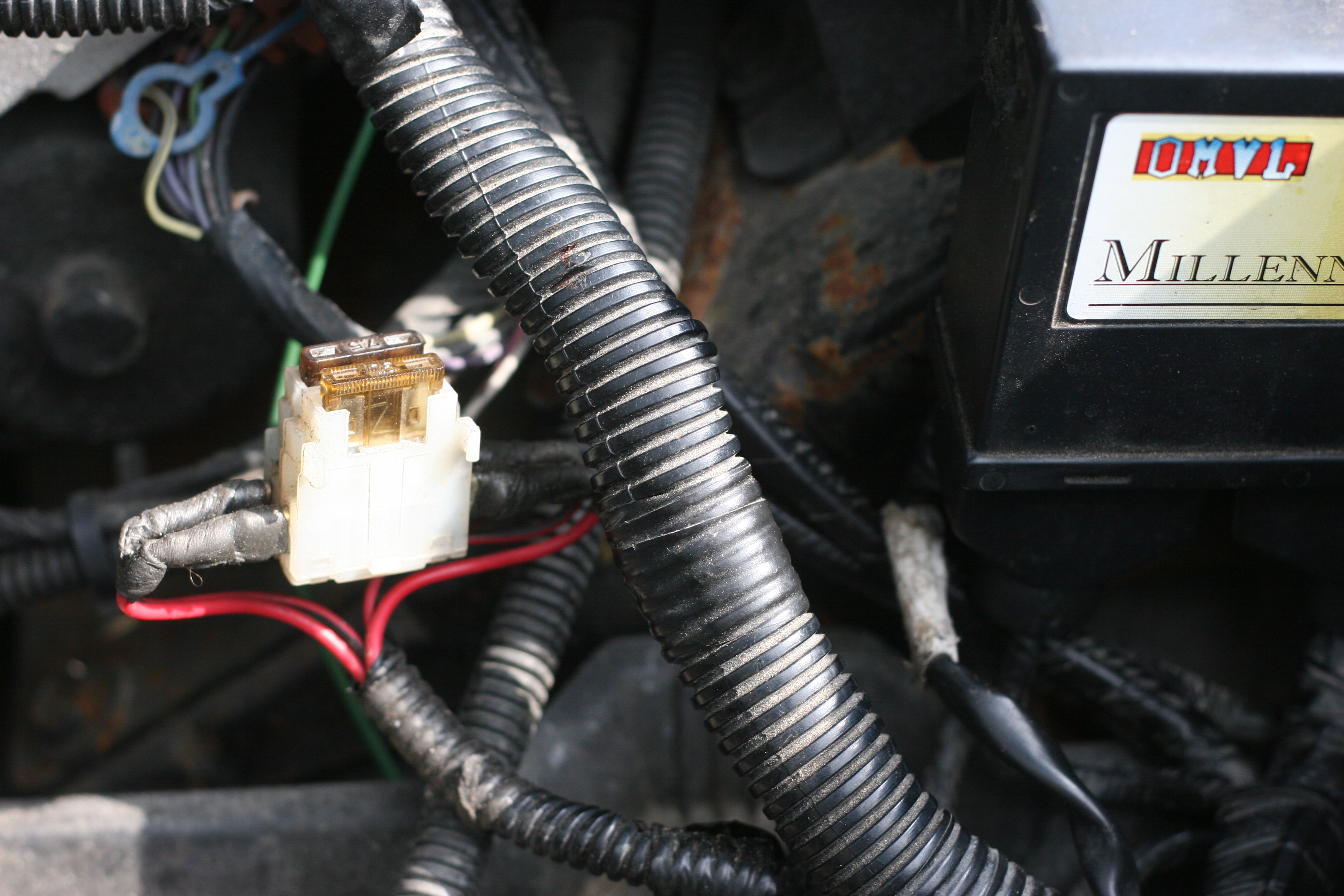

From your picture they don't appear to have the same coloured wires. You have a Red, which is the ignition switched feed, and a Red/Black which is the permanent 12V. Although if you don't know which one blew then that doesn't help much.....

Good spot!Gilbertd wrote: Thu Aug 14, 2025 7:26 pm From your picture they don't appear to have the same coloured wires. You have a Red, which is the ignition switched feed, and a Red/Black which is the permanent 12V. Although if you don't know which one blew then that doesn't help much.....
If - and it is a bit of an if - the fuses went back where they came from, it was the plain red wired fuse that popped. But as per question in above post - wouldn't there have been ramifications beyond the easy fix that was possible?
