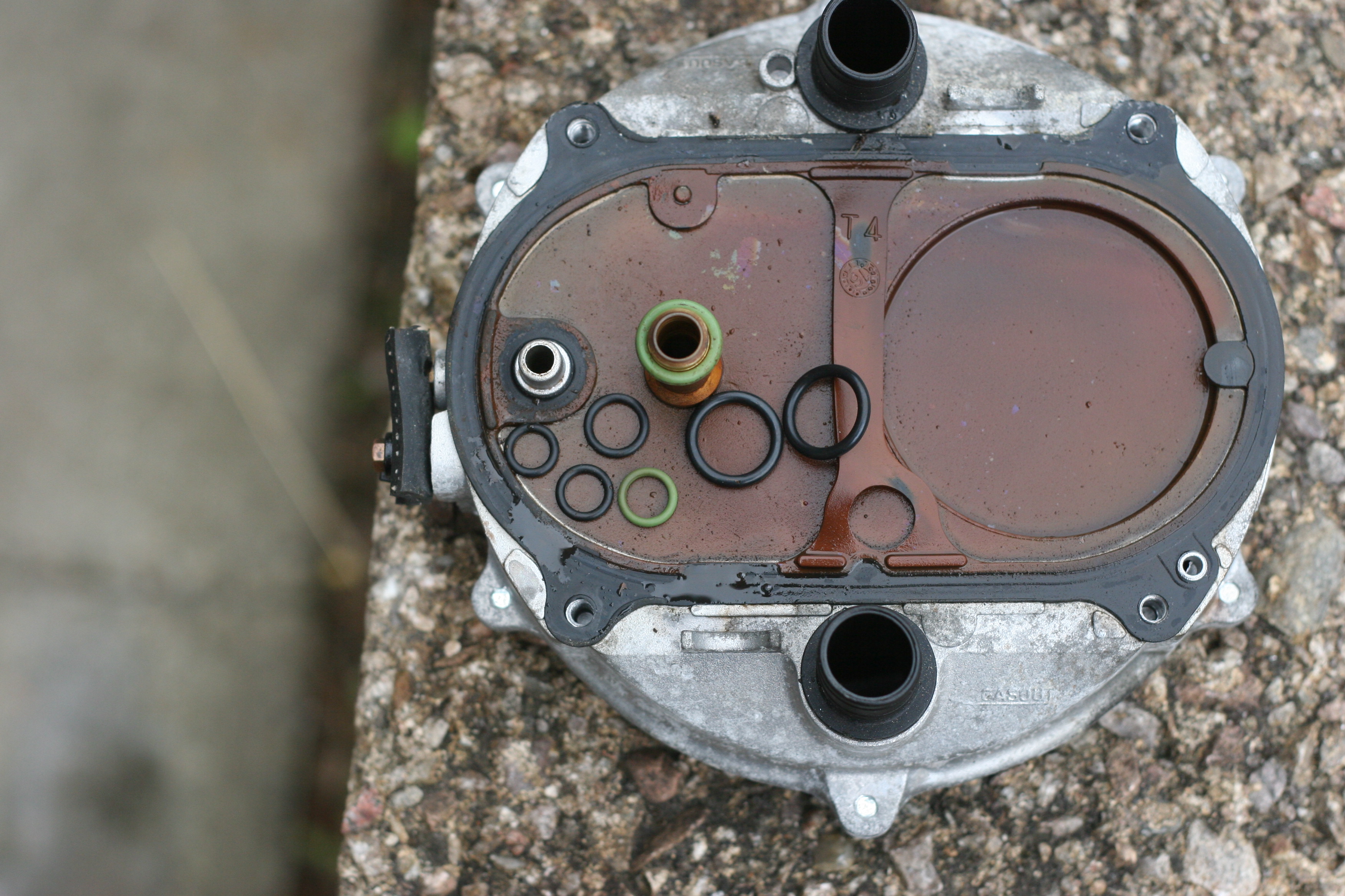

Asking advice here on how to cure a leak on my R90 reducer as repair kits at Tinley are 'out of stock', ditto reducers.
Truck threw up a mixture of odd symptoms and it appears that I have a leak between the water and gas sides. I'm currently pressure testing the water side at 5psi and it seems to be holding up. From the other side though, with a hydrocarbon tester at a water port, when I energise the solenoids there is a massive HC reading there.
I've pressure tested the cooling system and done compression tests to eliminate the possibility of head gasket failure. Two symptoms that point to LPG issues - occasionally (and usually after a prolonged period of over-run) on tip-in it goes lean (AFR gauge on dash) and (more tellingly I think) a reluctance when warm to transition between petrol and LPG running. It just quits where before it transitioned seamlessly. Coincidental with the arrival of that is, on shutdown the temp gauge very quickly goes full scale where before it would only go half way between normal running temp and max. This on this engine I'm told will occur if there is a pocket of gas (LPG in my case). Initial investigations uncovered a leaking water pump (coinciding with the poor transition and temp gauge issues). My theory here is that on shutdown the leaking pump drops coolant pressure enabling the passage of LPG into the cooling system. I also detected hydrocarbon in the coolant reservoir.

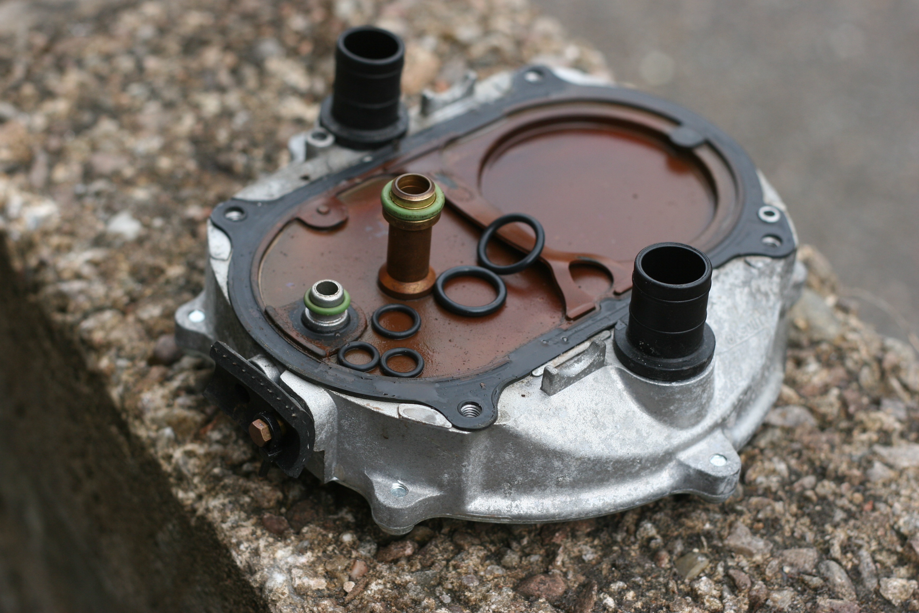

My problem is how to repair this without a repair kit being available. I've not opened the reducer yet but have the old one and it seems that O-rings are needed. Which, I might be able to source elsewhere if I knew the material they are made from. Another option would be to just slaver the existing ones in RTV. Both O-ring seals and RTV would have to be LPG resistant - and most O-rings and RTV are not petroleum resistant. The O-rings on the old reducer are green in colour which may be a clue to material and the larger on is square section. Photo below is of old reducer. And, just to spice things up, I need this rectified ASAP for work next week!
Any ideas on O-ring material and suitable RTV?

Repair kit arrived today and the O-rings are the wrong sizes. The smaller ones (where my leak is I think) are undersize in both diameter and cross-section by 0.3mm and I doubt that they will provide adequate sealing. The larger ones are 4mm larger in diameter than the originals. They are also black - not the green of the originals - which may denote an inferior material.
There's been a design change with the reducers. My old one (that came with the truck) has a brass spigot with machined grooves for 2 x O-rings. The newer one (circa 5 years old) has a plain steel spigot and only one O-ring. A retrograde step surely.

Follow up post.
Got it all buttoned up and after 135 miles the following day I can safely say all is well. The reducer leak was not from the high pressure liquid side as I'd thought but from the vapour forward bias (that I have set quite high).
