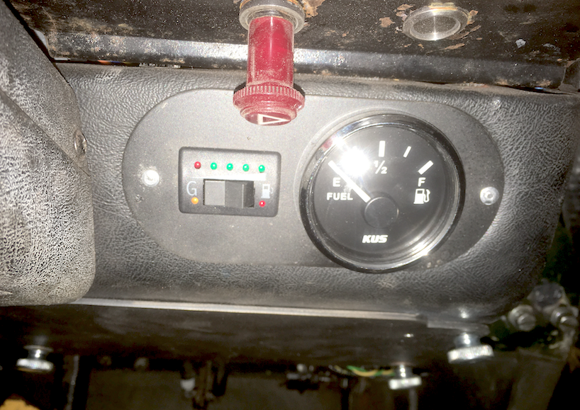

Can I buy a replacement holder/casing for my gauge?
- IMG_5994.jpeg (1.09 MiB) Viewed 4159 times

That isn't just the gauge, it is part of the controller and has electronics inside it. However, it is an AEB725A switch which I am fairly certain can be swapped for an AEB119B, see https://lpgautosupplies.co.uk/shop/lpg- ... er-switch/ although check with Mick at LPG auto supplies to confirm.

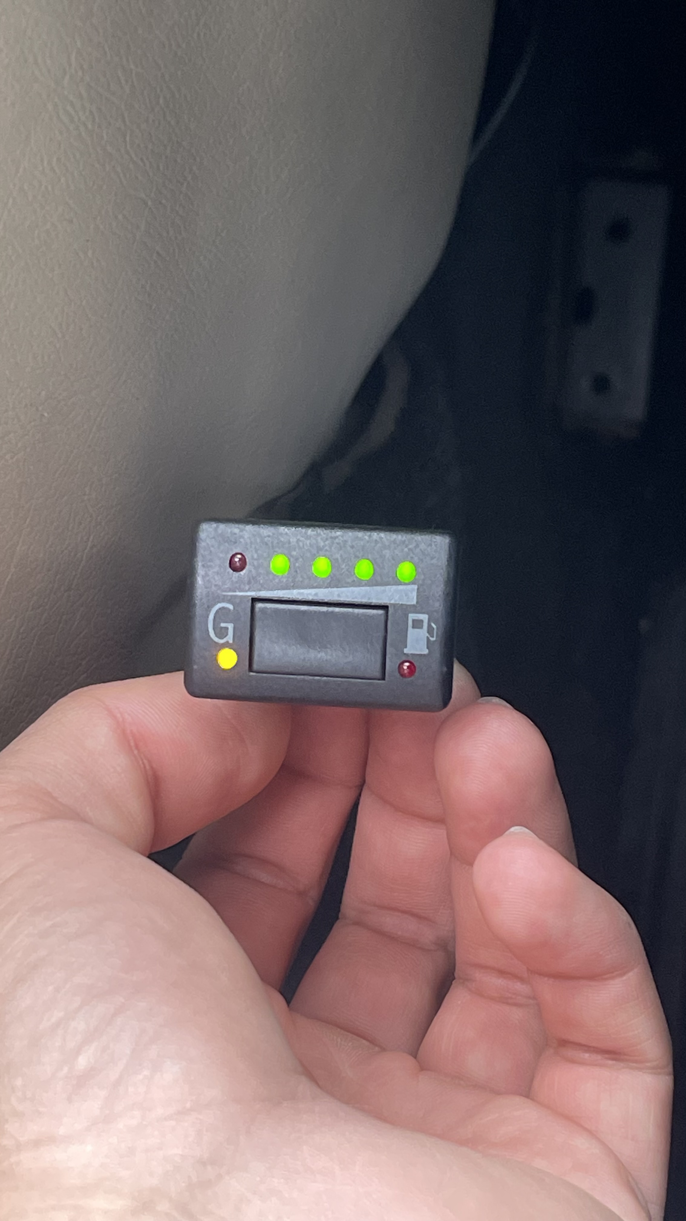

I don't think that is a AEB725A carb switch.
Looks more akin to a Leo switch but not quite?
I'm afraid it's not possible to swap-in late swithes (as fitted to Galileo) for a Leo switch. Tried and failed. It kinda works, in that switching appears to work, I think... but the LEDs don't illuminate. You lose the 'such as it is' fuel-gauge.

Does he mean the hollow plastic holder for this switch? Screws to (say) the underside of a dash with 2 countersunk screws then the switch slides into it.

If he is, I've got one that I've just taken out of the P38 I'm currently converting.

I think so. I use a cable-tie. Stops it pulling forward in the cut-out well enough.
