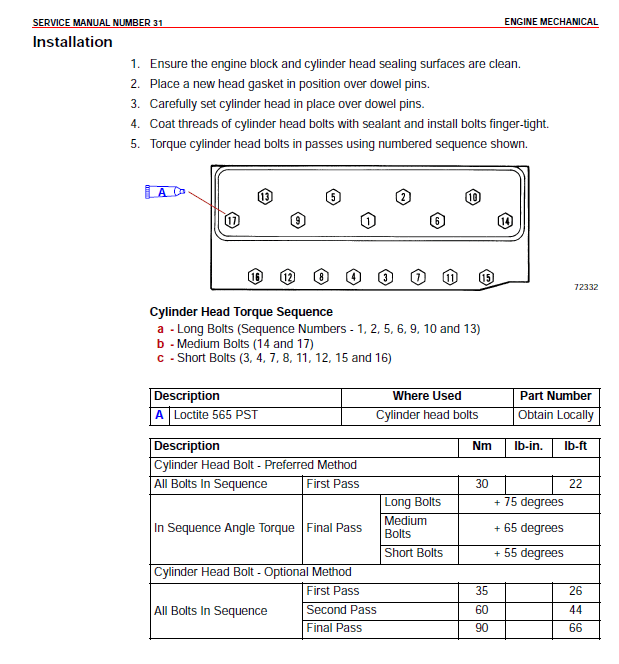

I've asked on the USA forum I mentioned and await their replies. While searching there I found this:
Head_Bolts GM.png (25.47 KiB) Viewed 6187 times
It does mention a Loctite sealant - and reminded me I have the complete GM workshop manual set for 1998 GMT 400 trucks which covers all the engines (by then, Vortecs). If you want the volume with the engine stuff Gilbertd, PM me an e-mail address and I'll forward it to you.
I also found that later Vortecs have TTY (torque to yield) cyl head bolts that are single use only. Identifiable by having 1/2'' heads (earlier reusable bolts have 5/8'' heads) and new ones come with pre-applied sealant.
As and when info arrives on the other forum, I'll bring it here.

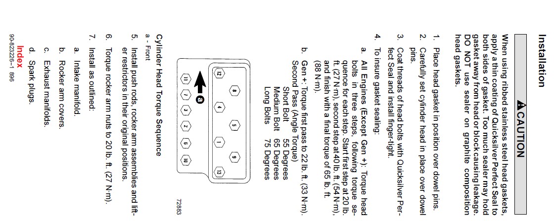

This is what Mr Mercruiser says about fitting the heads on the V6, the Vortec is what they refer to as the Gen+ engine.
Screenshot 2023-09-02 191102.jpg (144.41 KiB) Viewed 6175 times
No mention of the bolts being one use at all.
